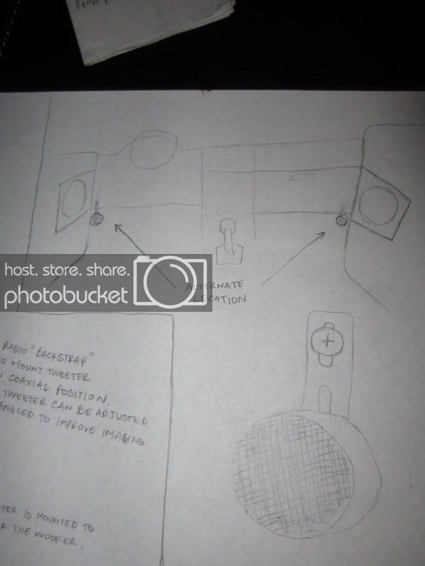

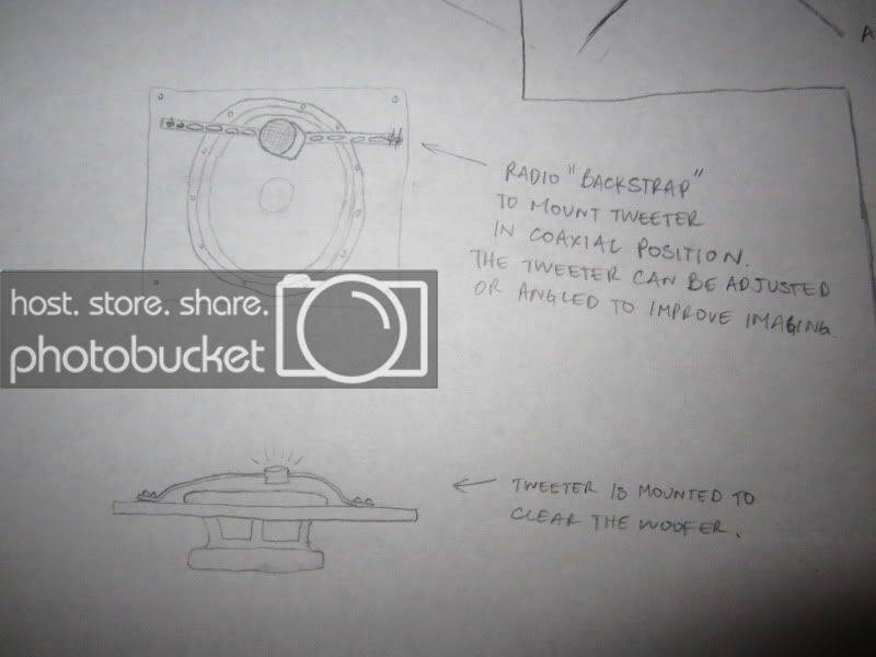

I have a Honda CRX and I am looking to improve my front sound stage - which should be easy considering what I have now are some 5yr old 4-way pioneers LOL. I have a decent budget system and I don't want to cut my door panels to mount a tweeter, so I have been looking primarily at coaxial speakers. I have explored the idea of getting components and mounting the tweeter using a metal strap bent in front of/over the woofer but that is not my ideal solution. I have also thought about mounting some 7" marine speakers up front, and found some 7" Kenwoods that peaked my interest. Not sure what to do.

I am open to components, and I would mount the tweeter in front of the woofer, kinda like a coaxial.

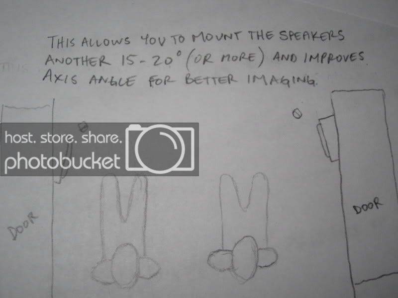

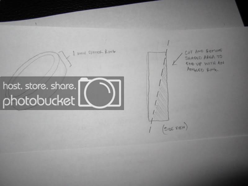

2. I have some ideas to mount a component setup without cutting the door panel.
I actually tested this out today with some old MBQuart 1" tweeters I had laying around, and it wasn't half bad. The placement alone seemed to ever so slightly improve the front stage.

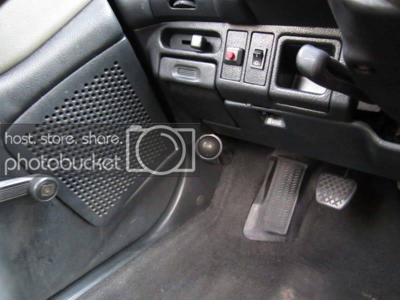

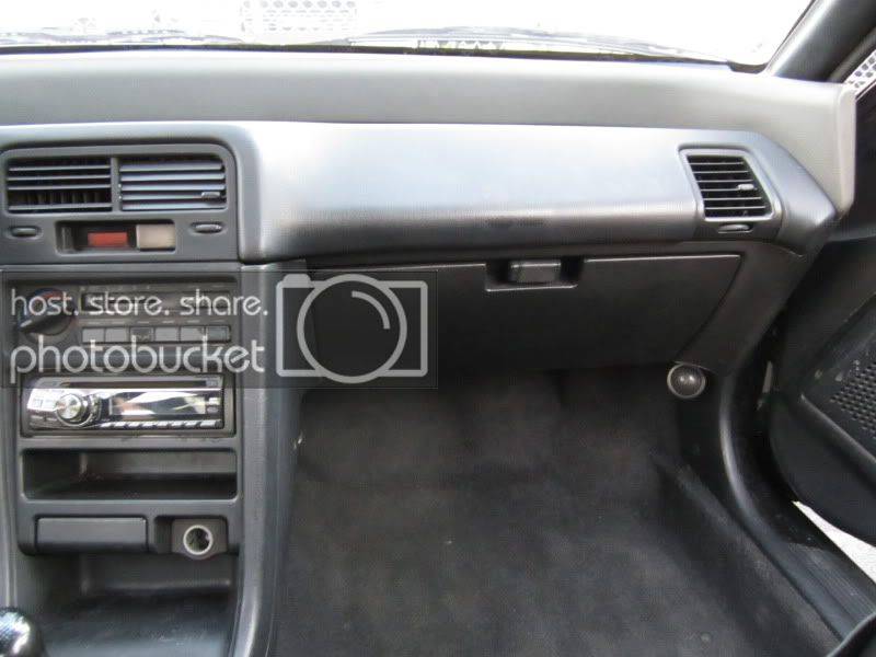

Tweeters
I did some work to mount the tweeters today and I think they turned out very well. It has really improved the front sound stage, no damage and easily removable, and the best part of all...... it required 0$ investment. It lifted the sound stage and brought it more "in front" of me and only took about an hour from concept idea to testing. Aesthetically they look great because in a black interior, you really cant see them unless you are looking. These things just disappear and you don't even notice them.
