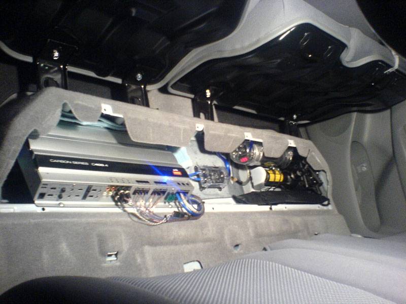

They are tight at the amp, I'll check if they are tight behind the head unit when I get home. I am running a set of 4 channel RCAs to the 4ch amp. This is my setup
