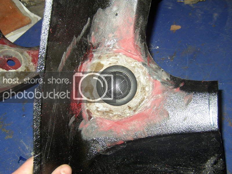

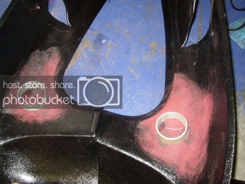

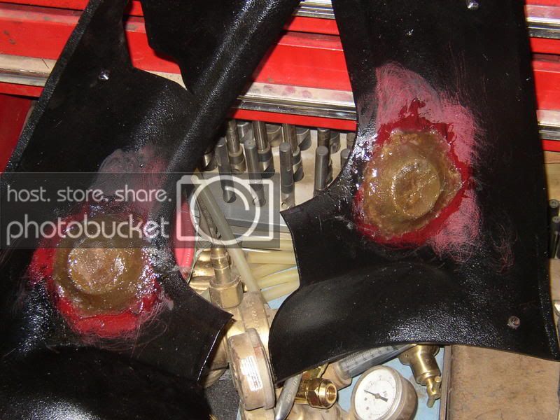

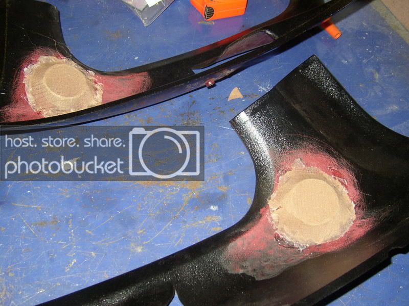

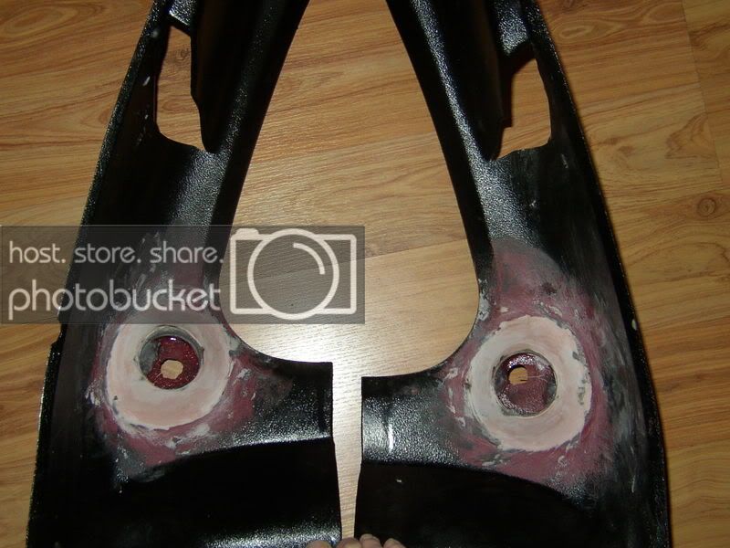

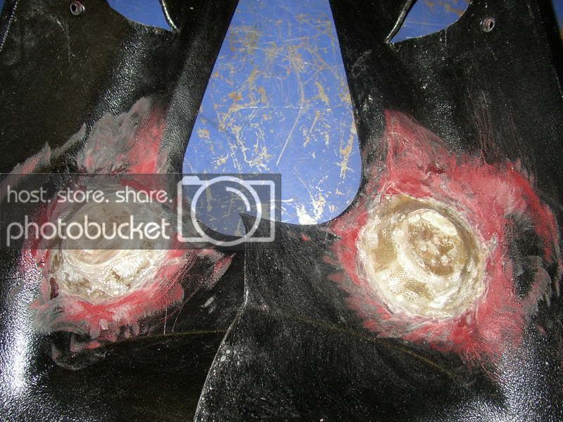

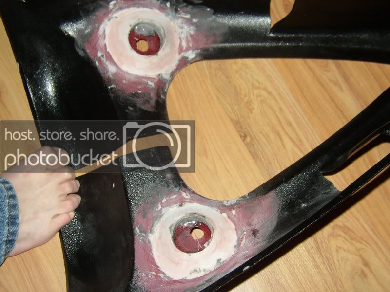

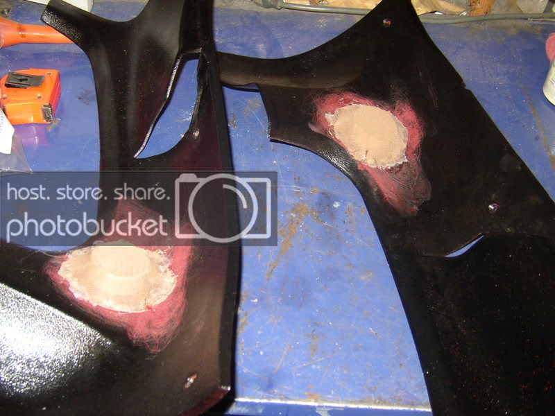

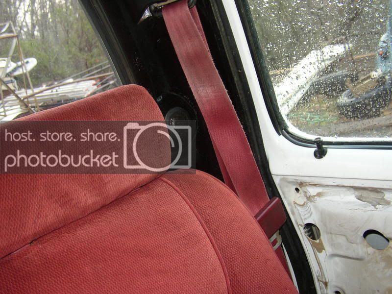

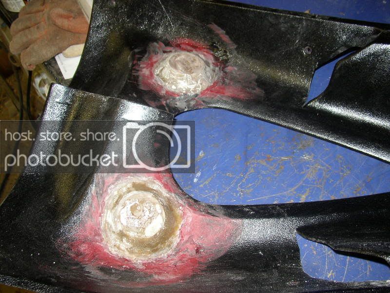

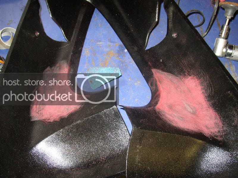

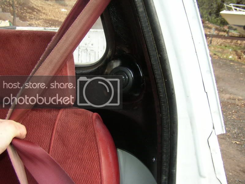

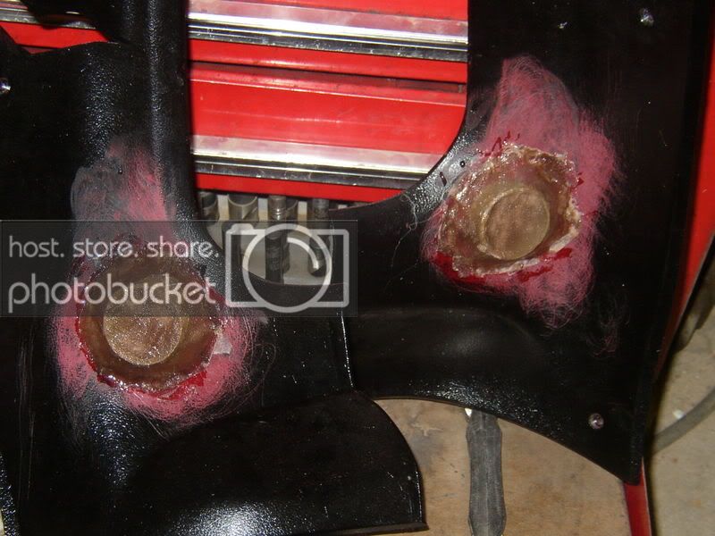

for the corners in my truck, there were crapy 4x10's took them out and putting tweets in for the rear fill.
I would have just used kitty hair of dura glass to fill up to it... or even some duramix...
Just to possibly save you time next time. Looks like it turned out well...
nG

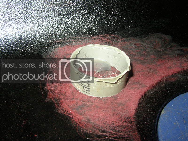

x2.. would have worked fine if the PVC was pushed in a little more. And why tweeters in the back?
Kitty hair is fiberglass reinforced body filler. Google it.
You could have sunk the PVC in more, molded it in place with kitty hair, sanded, filled, sanded, painted. Instead of glassing.
