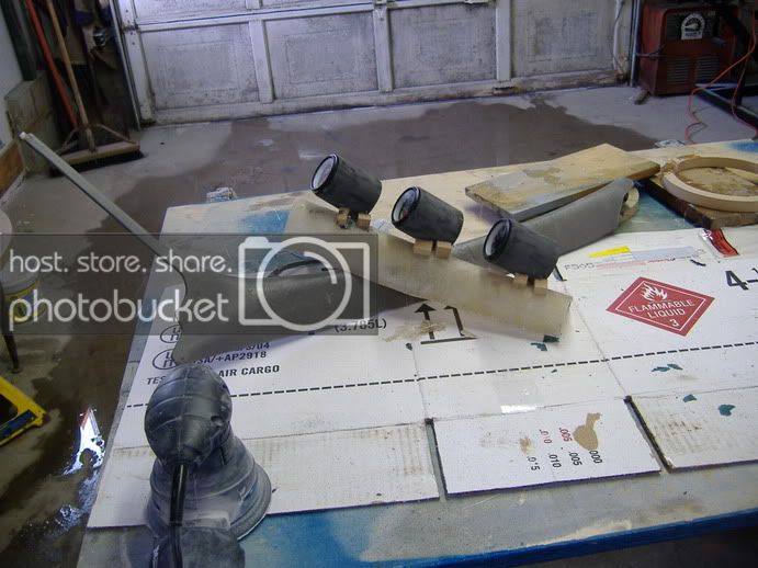

some more fiberglass projects from me
blue93corsica

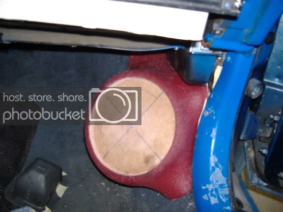

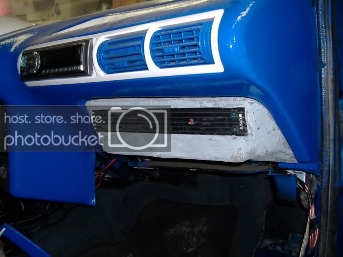

new glove box ps2 mount

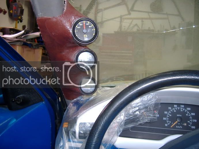

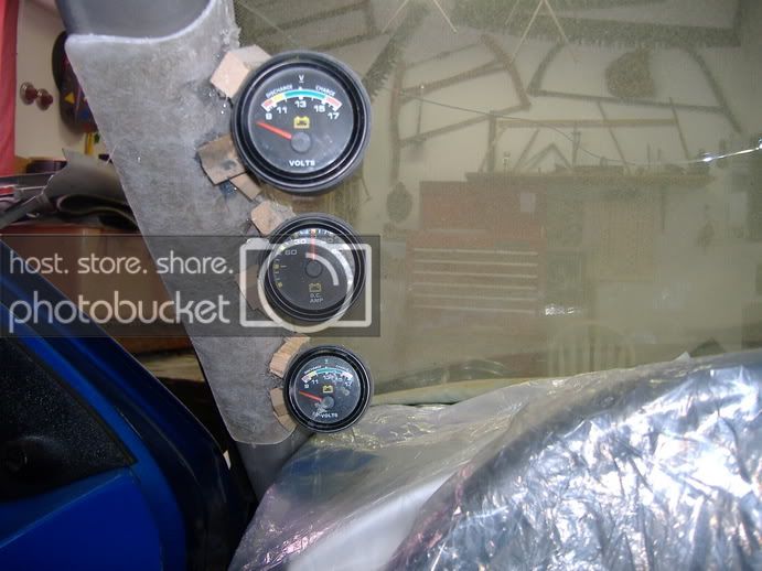

triple a-pillar guage pod

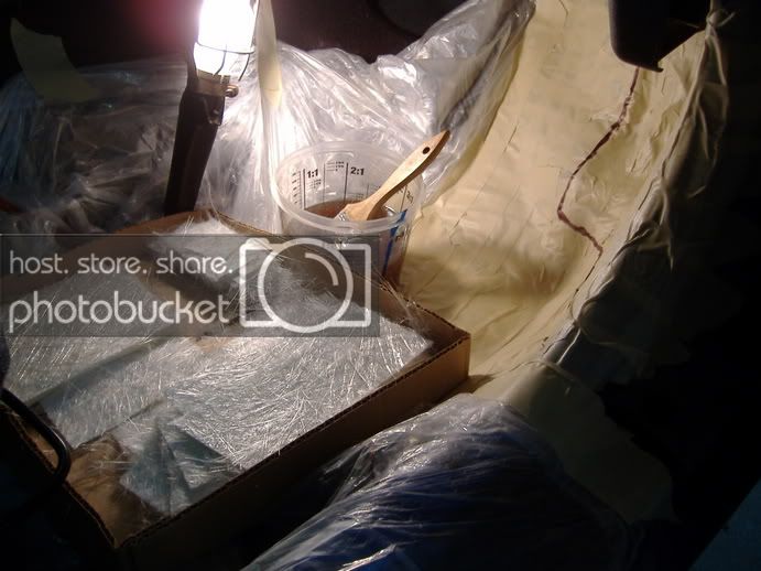

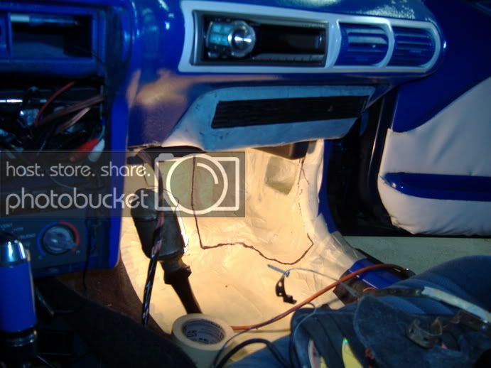

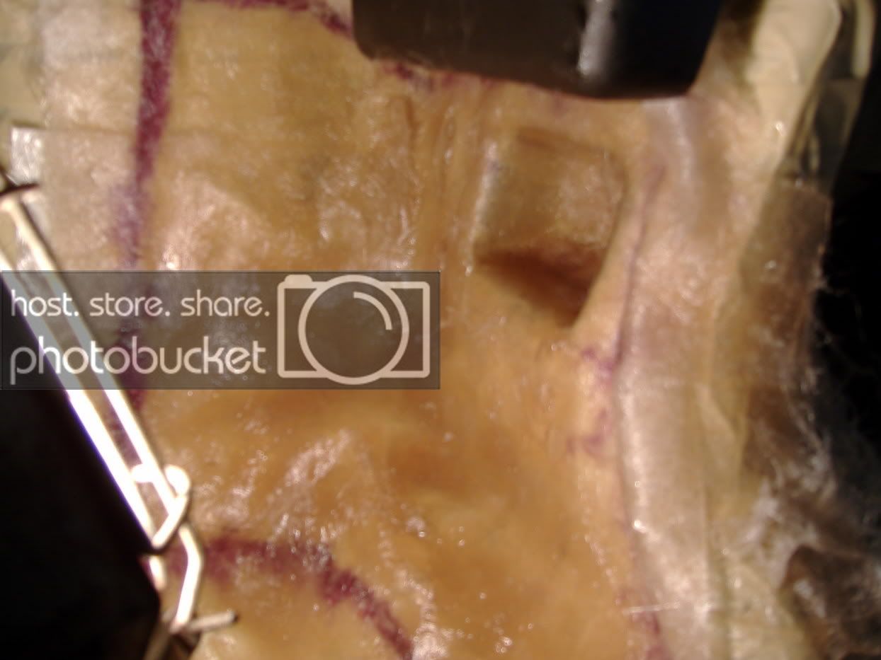

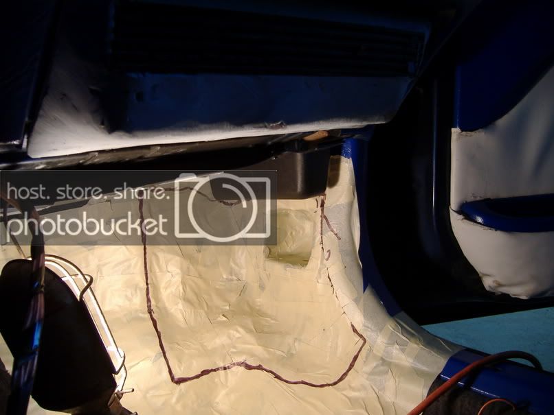

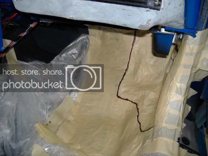

2 layers of tape, plus i added in sound deadener in behind the tape so when i install the kick panal the fitment wont be off by any aded thinkness from the deadener

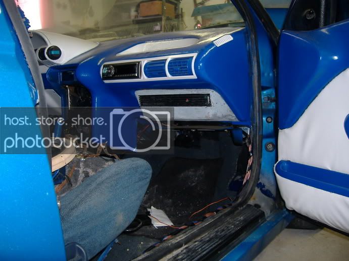

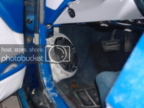

remote controle for the win?
//content.invisioncic.com/y282845/emoticons/wink.gif.608e3ea05f1a9f98611af0861652f8fb.gif
yep, plus i needed the stock location for my 7" lcd and plus having the HU over there really grabs attention, and almost gives it a real custom look to it, and you just have to becmoe very familiar with the remote
looking good man, is the dash glassed for just painted over the vinyl? how hard was it to remove the dash in the corsica?
its just painted and i just taped the hell outta my car when i painted it, i never actually took it out, i will be removing it next though for a re-spray with colour match

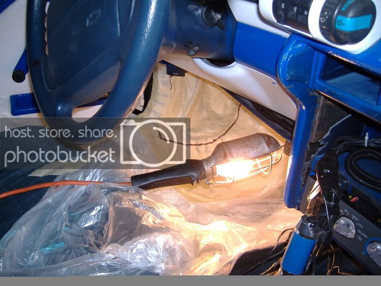

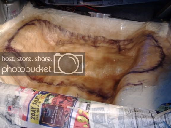

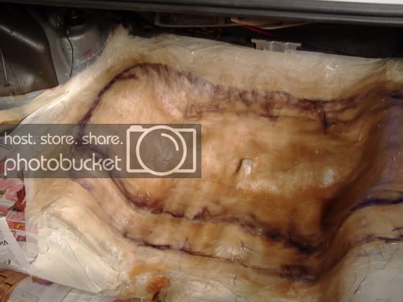

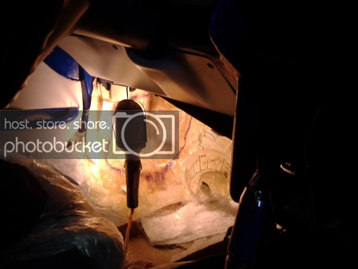

pooped the pass. side mold out and trimmed it down and layed down the glass on the drivers side
drivers side, got the trouble lamp going to heat it and help it cure faster

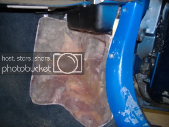

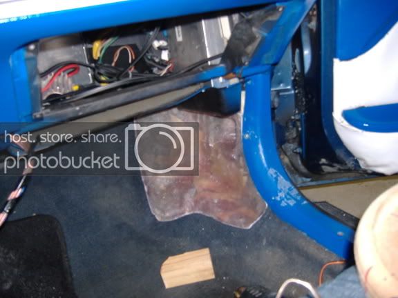

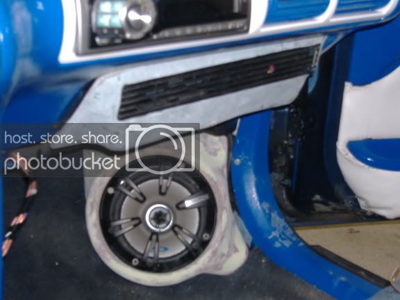

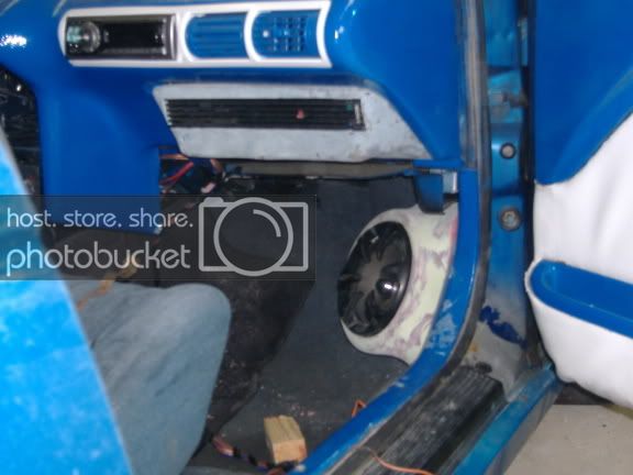

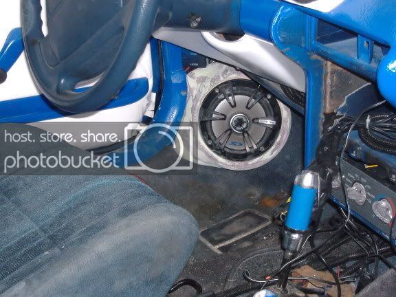

got the kick wrap and resined, just awaiting a light sand and ready for a coat of high build primer
a quick test fit in the car

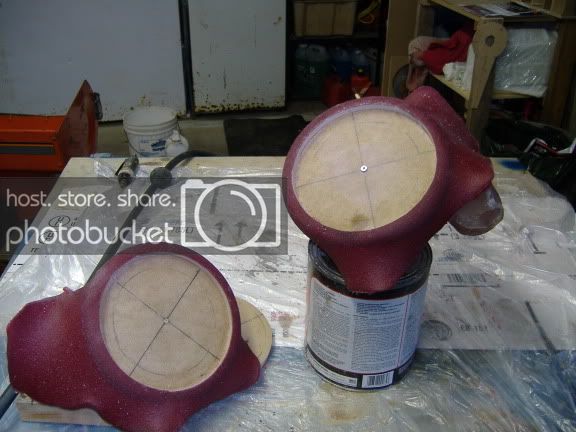

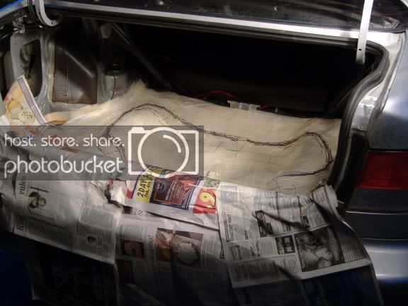

and heres the start of a spare tire well sub enclosure, basically just a foundation mold has been made so far
this is for a 2000 honda covic and will house 2 12" mephis(sp) subs
