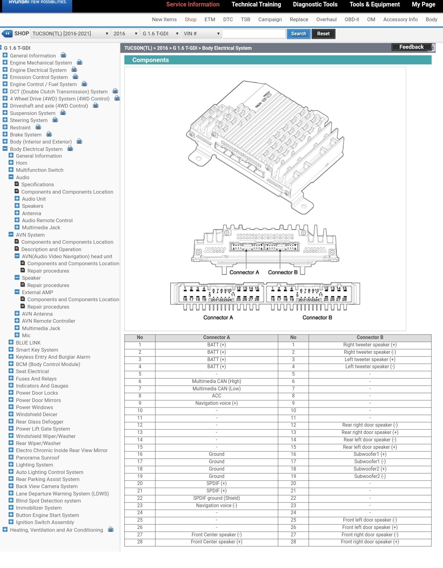

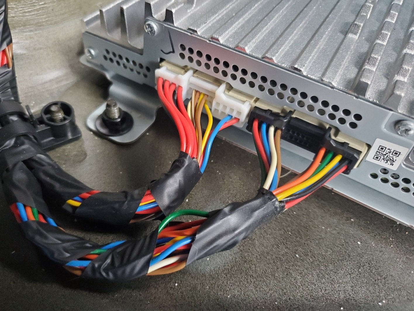

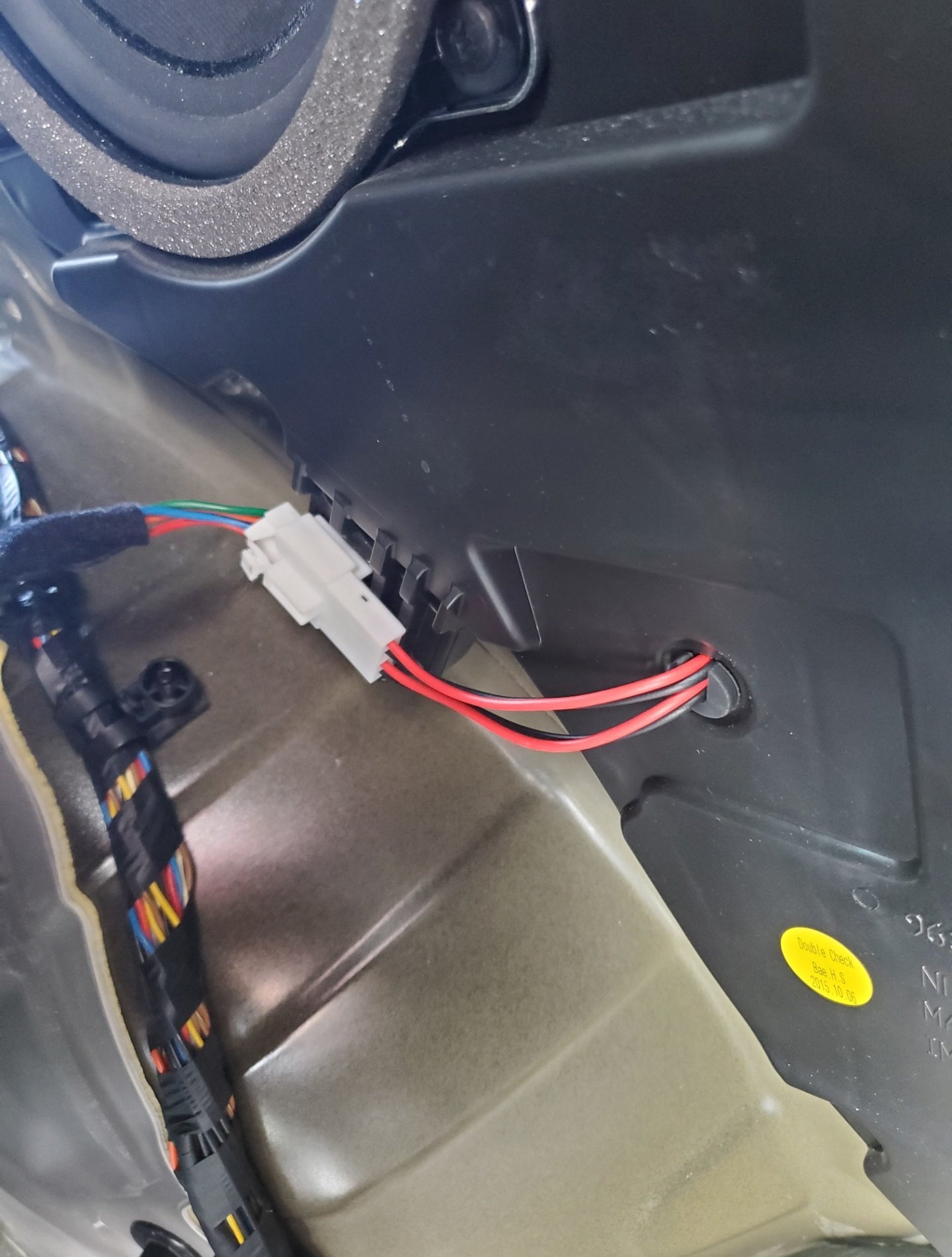

Adding a SoundQubed S1-1250 to my stock-everything 2016 Hyundai Tucson Limited. I'd love to not have to open the dash, as it's apparently a pain in the ass, and I seem to have just about everything else I need at the factory amp in the rear of the vehicle.
-Am I correct to be tapping into the front speakers for the Lc2i inputs? Better than using the subwoofer wires? Would I just disconnect the harness coming from the amp to leave that sub dead?

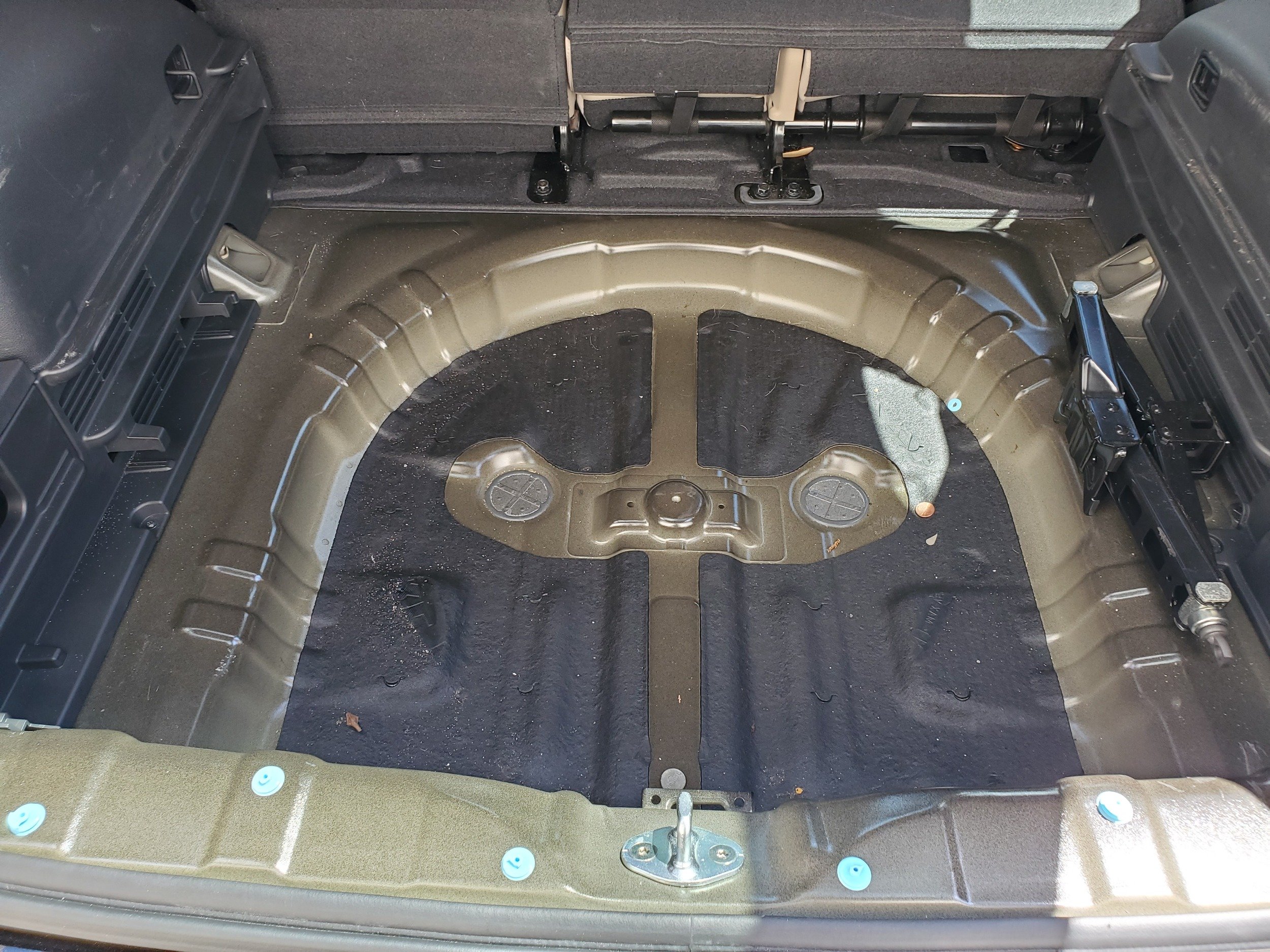

-Does the spare tire well usually serve as a good grounding spot, assuming I'm not hitting the fuel tank or something else? Will a self-drilling screw suffice if I can't access putting a washer and nut?
