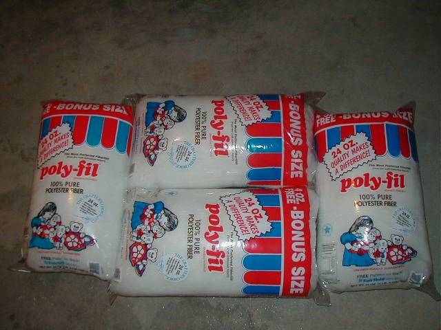

polyfill is to the best that I can describe it the stuff you would put in a normal pillow not a feathered pillow. Polyfill will make the sub think that it is in a bigger box.

Build a 1 cu ft box , and add polyfill until the box is approx 1/3 full .... This will smooth out your bass , but you will lose definition.
basically it will add the essance of adding volume to the enclosure without actually building a new box. it cuts down on the transient response (ie: tightness of bass) and making it sound smoother, and as blue said, less defined.
dont build a new box until you played with some plyfill with your current box.
polyfill looks like this
its basically a synthetic cotton-like substance that you can buy at arts\crafts stores... usually used to stuff stuffed animals and crap like that.
