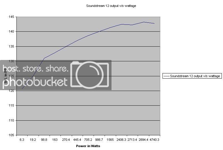

here's something cool chad and I did the other day...
details
my car, with the SPL box used from the test session..
soundstream splx 12
2 sundown audio 1500d's
61hz tone (loudest in car)
this testing was done to visually show you all output compression... the point where the woofer simply cannot produce anymore output... either due to BL compression, CMS compression, hitting xmech, etc...
each volume click was measured for voltage and current into the speaker, and spl output was measured via the TL note that the meter was in the headrest position, and the back hatch was left open, to allow me to see the meters..
this graph will be included in the test session post... but here it is for you now

its no suprise the splx12 can do high numbersi see 2 splx 12 in 2.5cubes shared ported box tuned to 42hz get well into the 150's at the dash
80
well the one did a 149.6 in my car, with the hatch shut... with 3 working coils..
then we killed it.. cause Toby said I could.. //content.invisioncic.com/y282845/emoticons/smile.gif.1ebc41e1811405b213edfc4622c41e27.gif
