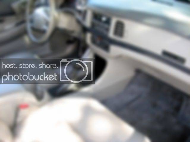

So I put a 6w3v3 in my center console...
Right now Im running the REVs 80 and up and the W3 at about 150 low pass. I know its a large overlap but it sounds pretty good. Im not running the subs right now but when I do Ill probably run it from 80 - 150.
I would try running your subs at 60 and under 12/db slope. The 6w3 at 60 -130 at 12/db and then then your mids from 130 up with 18/db slope. Thats what i think would sound good. Trying to keep the subwoofers below 60 hz and mixing it up with the 6w3 should keep the bass up front.

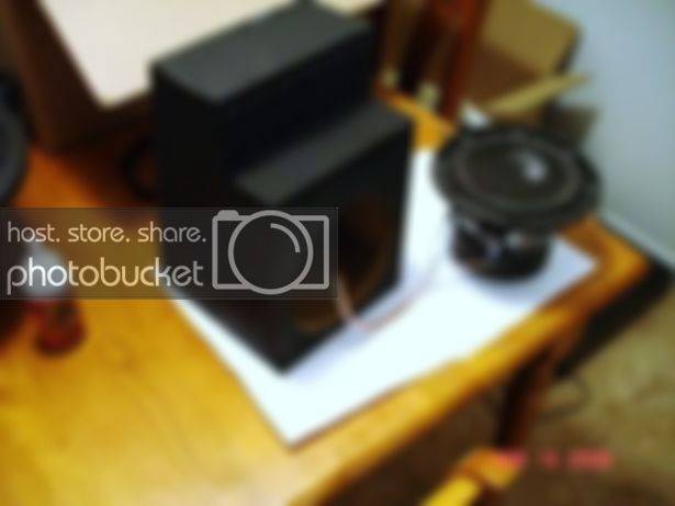

I used the storage compt. The sub was facing forward. I was a pita process. I had to remove the center console and measure and design the enclosure to fit. The final product was seamless.
I decided once I installed my Focal 165K2P's with 300w rms per side that the center sub was not really doing much, so I took it out.
When I had it though, it did make up for the lack of bass the REVS had.
