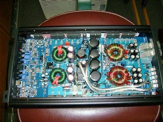

So, can anyone guess this amp?
Canaan
Beatin' the block down
Maxxsonics made.
Strappable.
What board do you think it is?
What amp is it similar to?
We just got em in at the shop.
What kind of power do YOU think is capable of?
(I'll post what amp it is and rated power later)

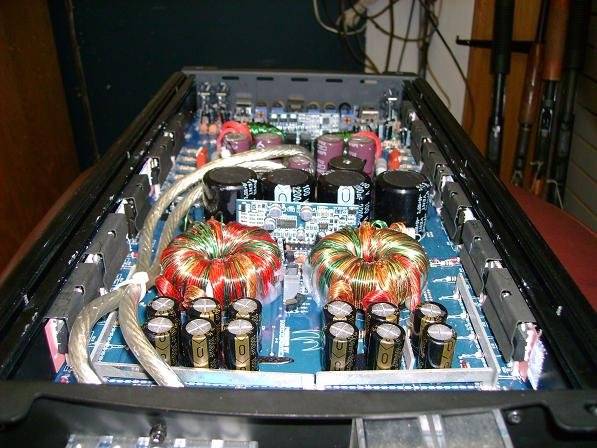

I guess around 1200 watts @ 12.8 volts.
I can't tell for sure but the power supply FETs look like TO-220 units and with eight TO-220s I wouldn't guess over 1200 watts RMS. If they are TO-247 units it could be a 1500 - 1700 watt RMS amplifier, although, the output section still would indicate a 1200-watt RMS amp to me.
Or my count could be off due to the clips and the pic angles.

Similar boards to IA40.1, and the DD Z1a
Probley does more then the rated 1500 at 1 ohm.
And it can probly burb at a near dead short, say .35 for I guess 3000 wrms. I would not hesitate to wager that it is 16 volt modifyable.

Well, played around w/ the mystery amp today.
Tested it at 1ohm nominal on 2 Clarion PXW1252's...it was alil much for em. The got were really moving and got stinky fast even on a perfectly clean signal (scoped).
At 1.7ohm reactive, it produced 340w more than an M1a at 1.83ohm reactive.
Tried it on a DD2512, lil more power than I would really recommend on that sub also.
Was nice on a DD3518 @ 1ohm though. I am replacing my roommates 2512/mb2 combo w/ this amp and a 3512 very soon.
Nice lil amp, especially for the $499.95 price tag we have on it at the shop //content.invisioncic.com/y282845/emoticons/smile.gif.1ebc41e1811405b213edfc4622c41e27.gif
