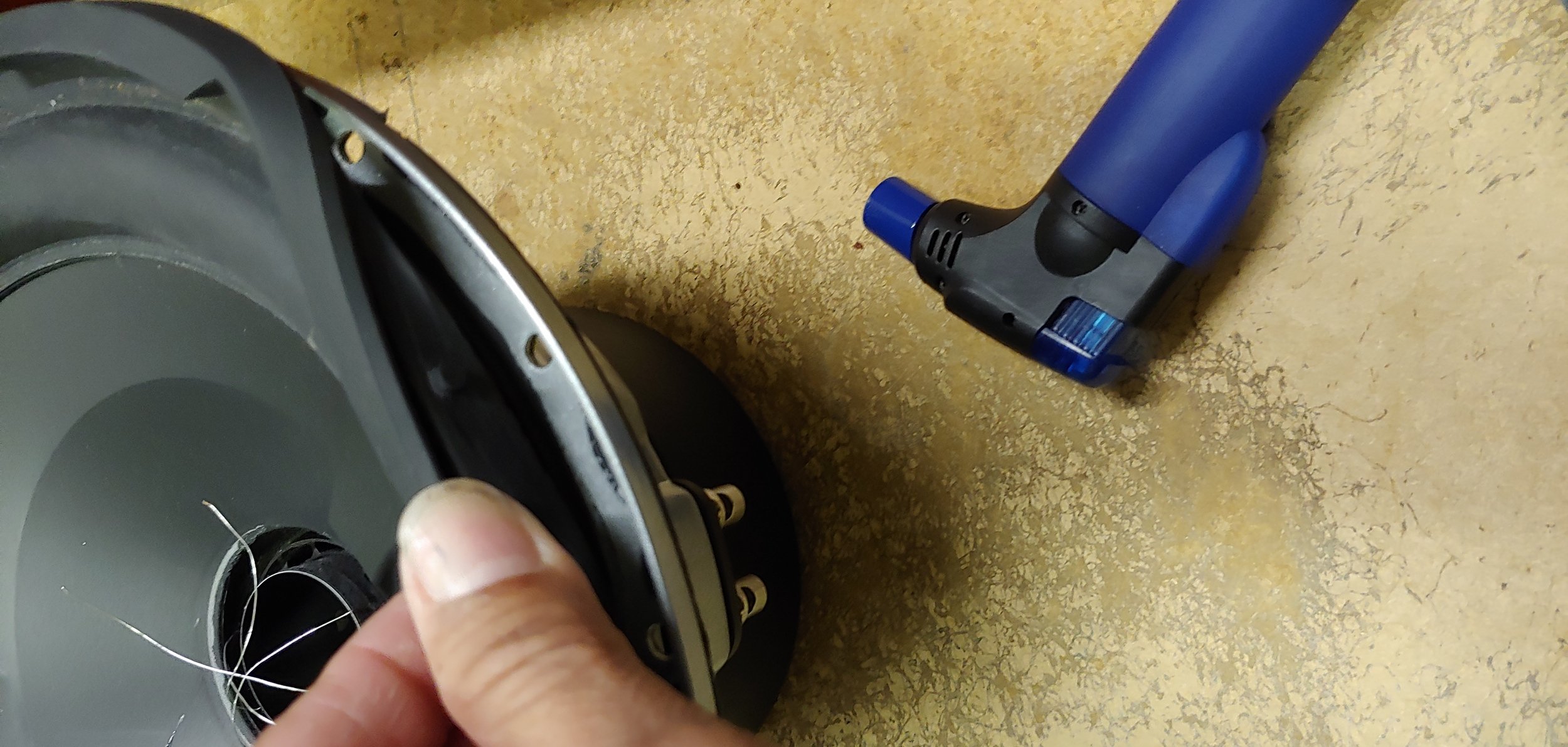

The mini torch method works good. I had a Power Probe brand butane soldering kit, and I'd take the head off of it and use it as a mini torch for this exact purpose, at any rate, likely works about the same as the one shown above.
I've taken apart many speakers / subs over the years. Heat the basket only from underneath, flame to metal only, go slow, but keep the short flame moving as to not burn anything, and use a flat head screwdriver to carefully lift up the surround after heating it (this will take some trial and error on how hot to get it). Same for the spider. Remove any magnet boots or trim / gaskets that are too close to flame, and again heat the frame only directly under the surround / spider, do a few inches at a time. This works with most OEM adhesive, might not for the rock hard super glue if someone used that, but it's less common in speaker gluing.
I've done foam and rubber surrounds with no issues. You can burn either if you try to go to fast and not careful.
Good luck with the project.
Last couple I took apart were a Kove 15 and an old 12, but have done quite a few over the years.
img_3587-jpg.38420
img_1553-jpg.38433
Did you use the flame on this ring as well? I hav a 12" Armageddon given to me by a member here but UPS broke it and told me to kick rocks. I have the new frame but do not want to destroy any of the soft parts.
I have never tried to separate spiders in a spider pack if that is what you are referring to, but, the entire spider pack will lift up fine though if you're careful heating the basket under the spider landing, the plastic spacer ring did not melt, the whole pack lifted as seen in the photo above. Pics of said subs shown in my thread below and where I grabbed the photos from. Sorry if you were referring to something else. The smallish flat head screwdriver is used to gently slide under the surround / spider once hot enough to slowly and gently scrape / lift. Practicing on blown cheapo subs is always a good idea.

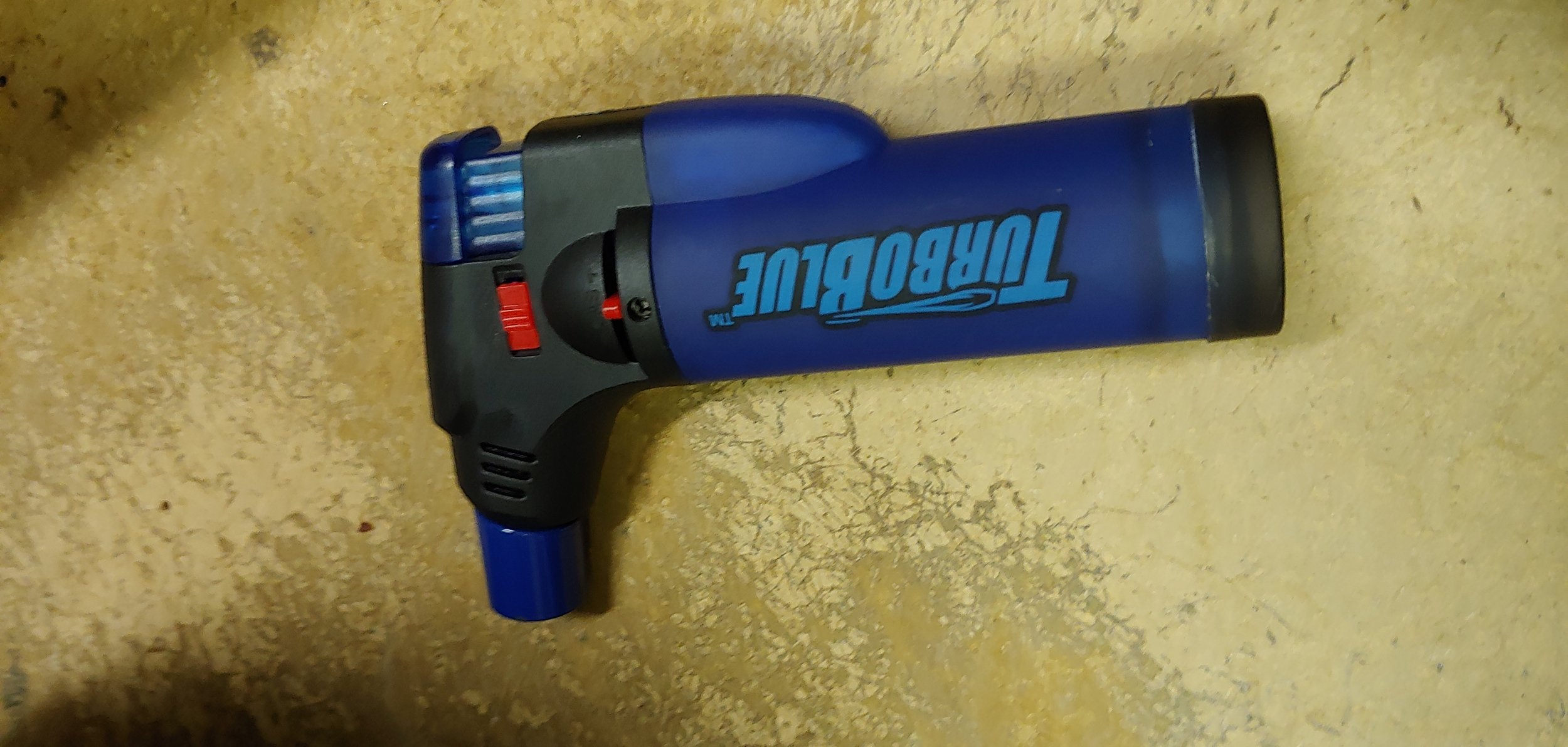

And this is the torch I use. It is a soldering kit actually, but I would unscrew the head off and just use the flame, was a pretty controlled flame that worked well.

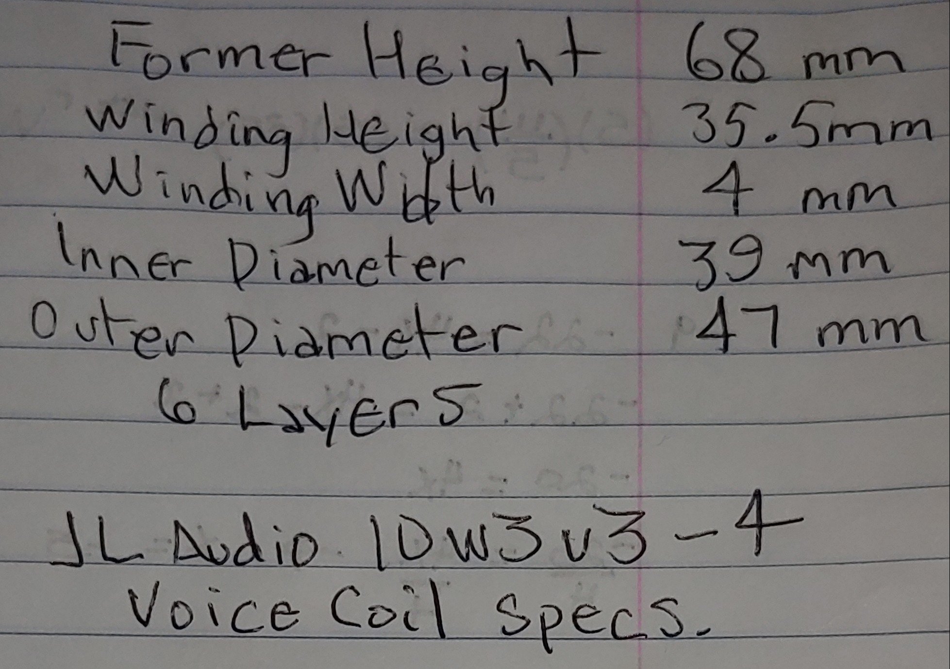

I know exactly what you mean. I just rebuilt a 10w3v3 and the OEM vc ID is 39mm. The only one that fit ID and former height was 38.5mm ID and 60mm high. I could only fit a sheet of paper as the coil center spacer! I got it on the second try and it is working great.
That is how I found those JL 13w7 coils on ebay. Hours of browsing.
That's getting to the point where you may have rubbing/failure if the coil expands slightly from heat or the coil rocks a bit. Probably not a thing in low power sub like the W3 but on bigger stuff I would expect something that tight to fail. You'd normally want to be able to stuff a playing card or two between the former and pole and coil windings and top plate, and most of the big subs everybody is using these days have quite a bit more wiggle room.
