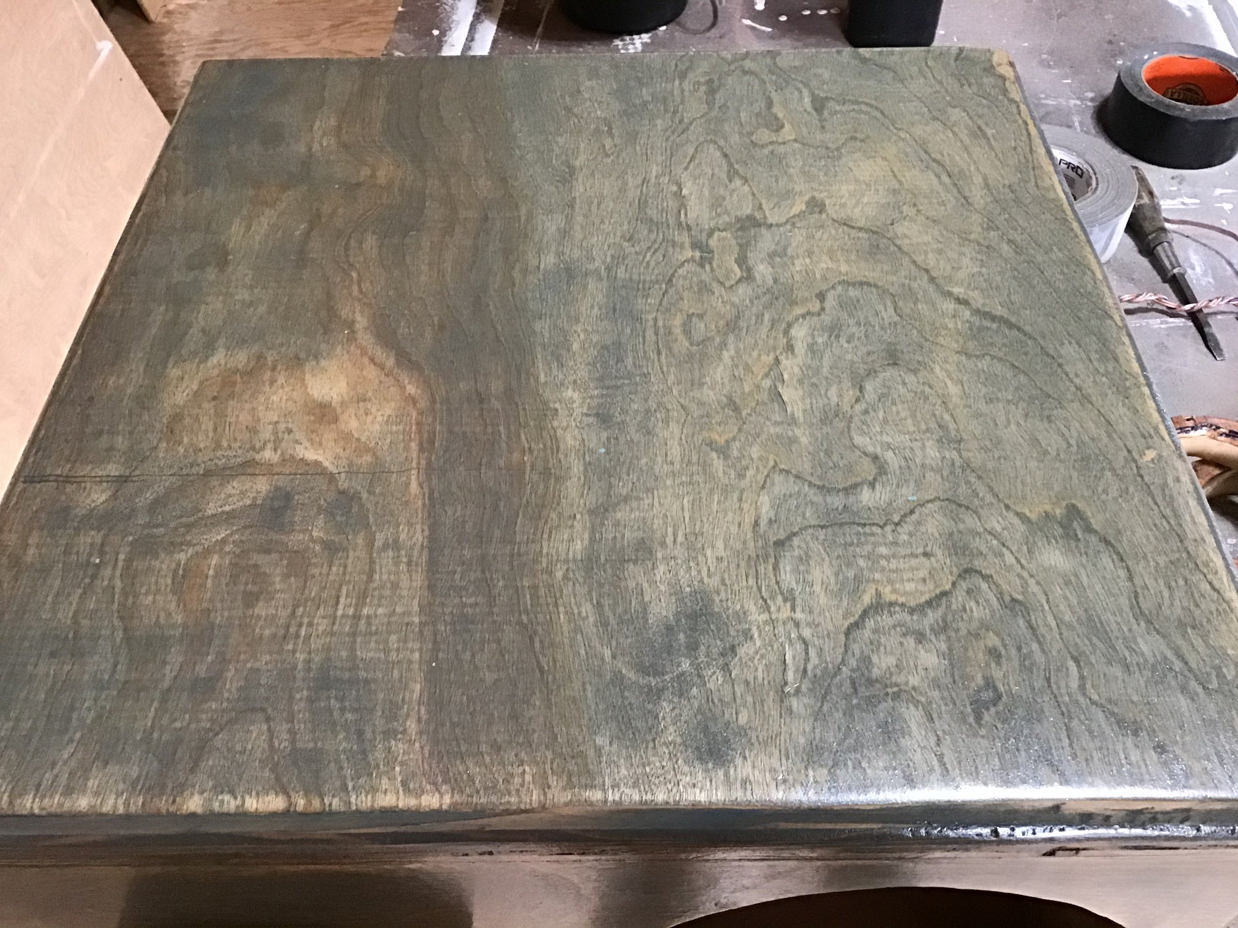

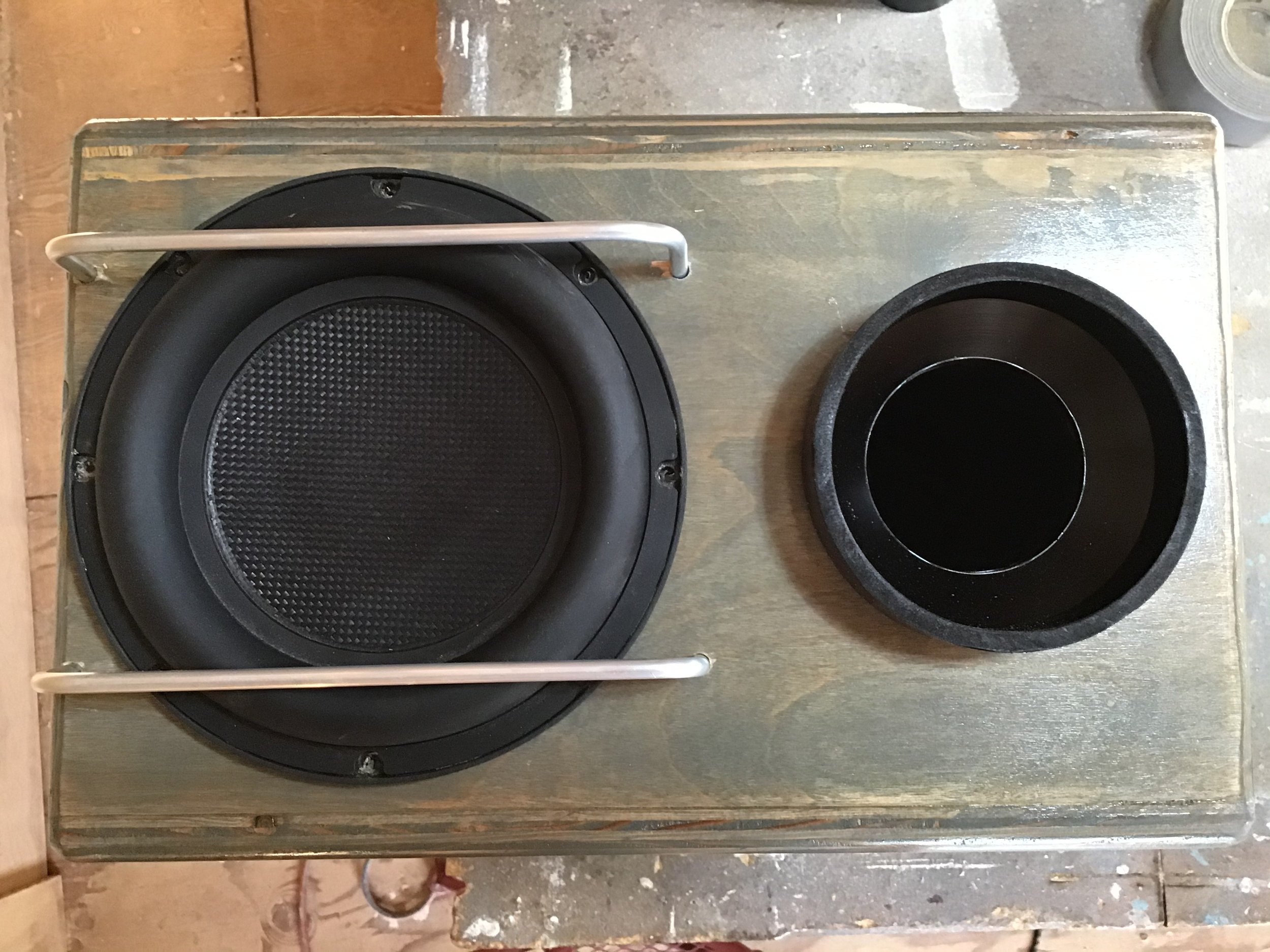

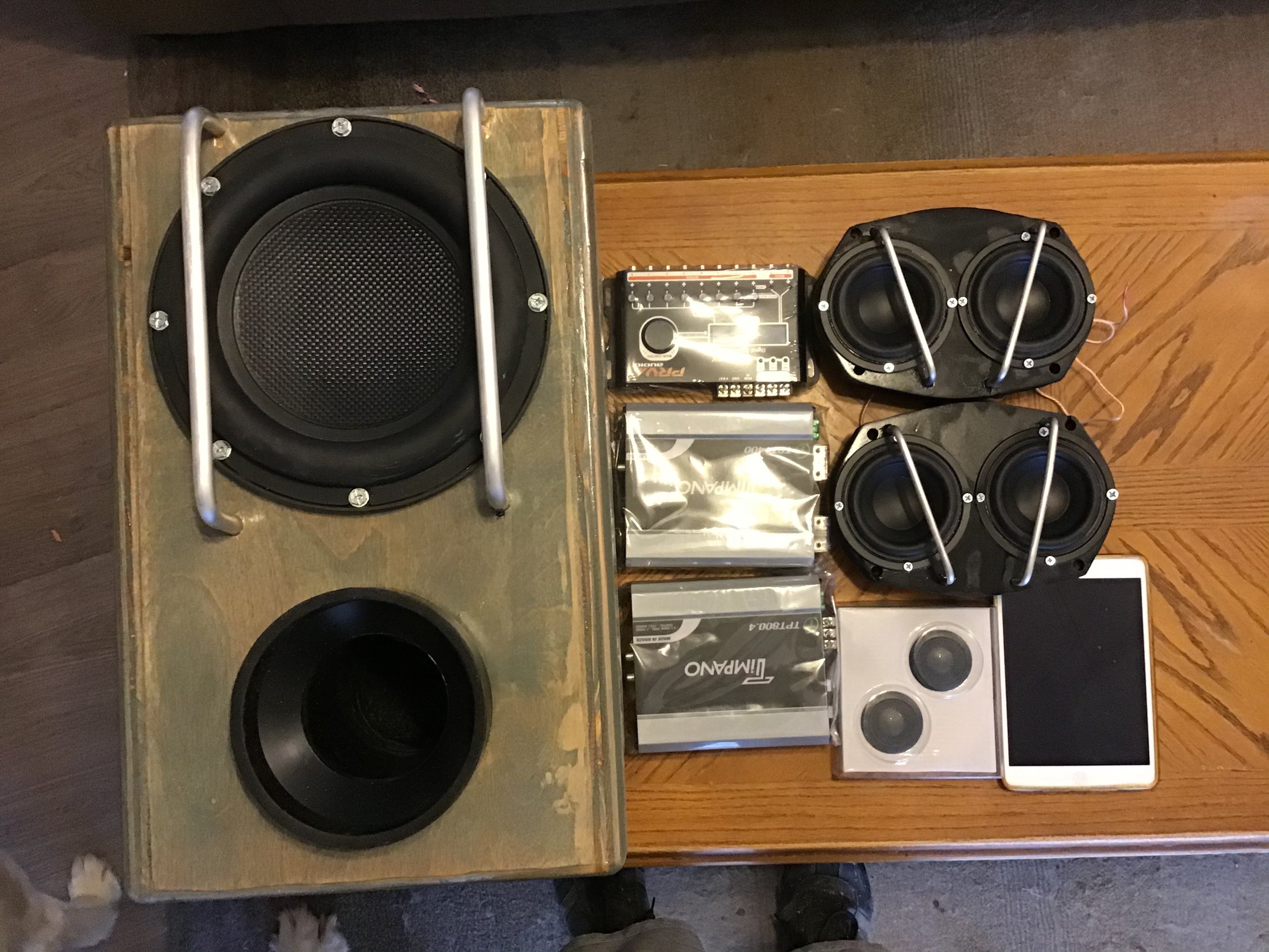

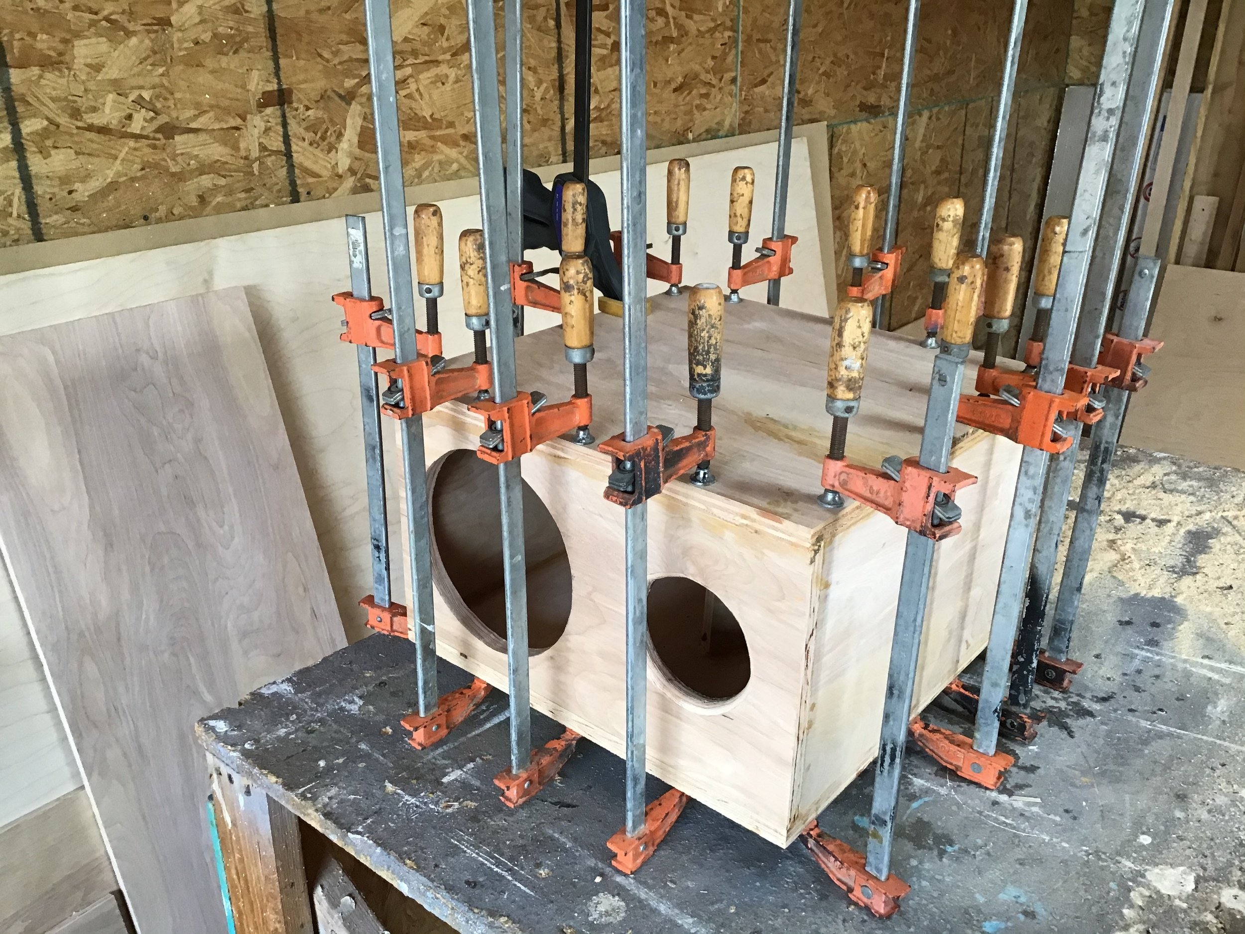

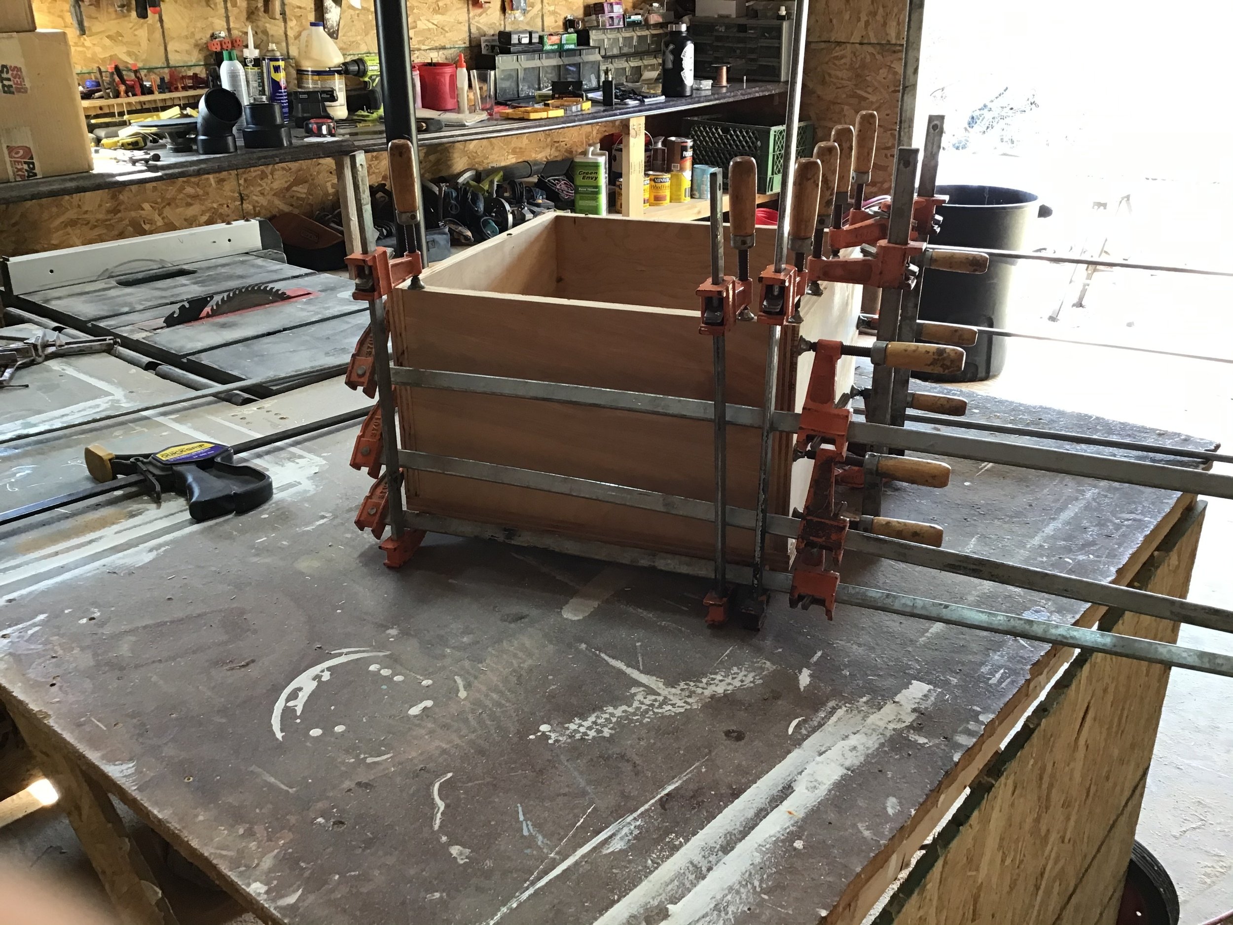

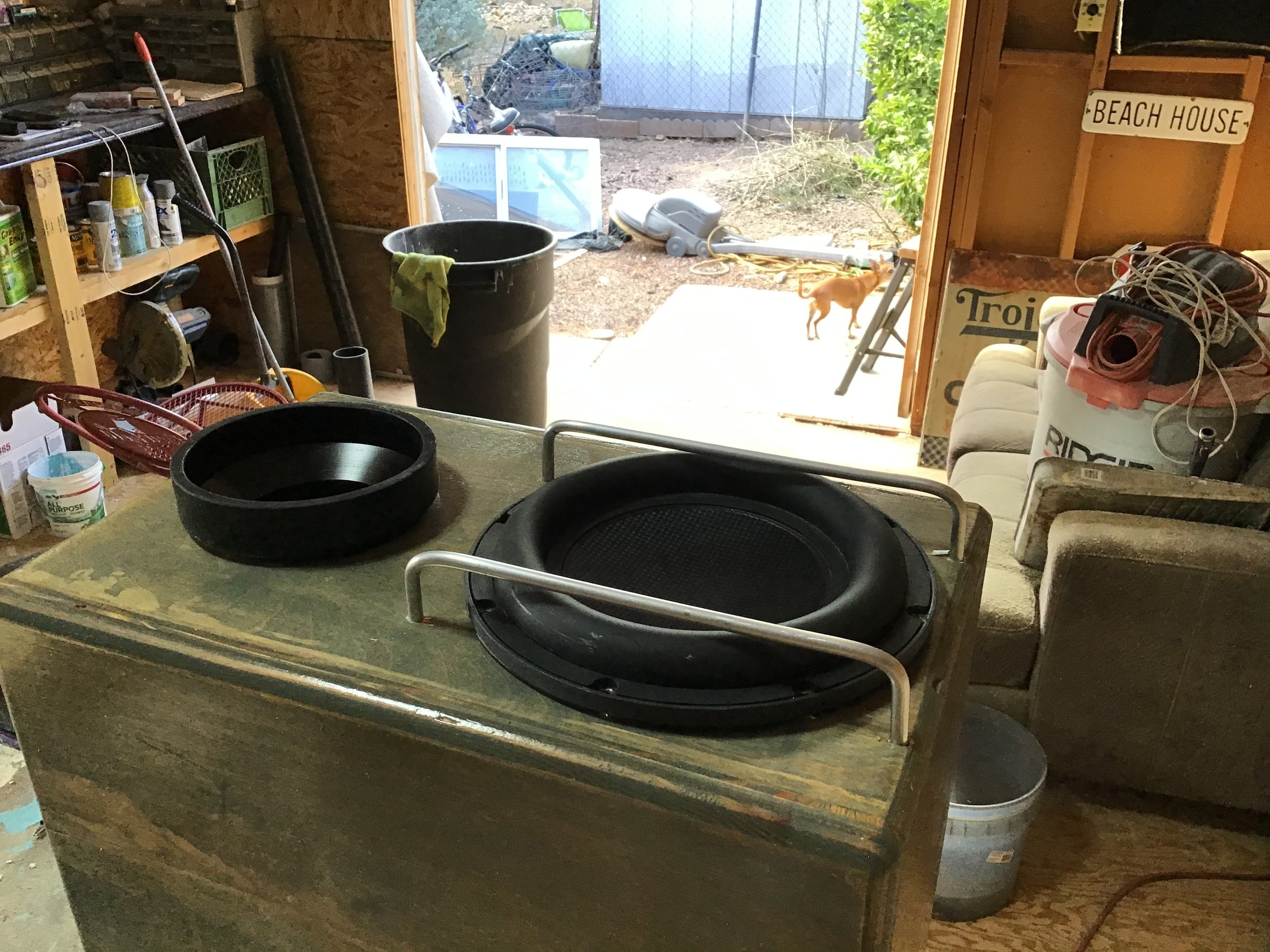

Box is finished. 1 cube @31 hz is what I ended up at. Close enough......I guess. Port gets too close to the back wall to get down to my plan of 30 hz. I screwed myself on the speaker bars and cut them short and made them too close to the surround on the sub, so I will have to make a couple more tomorrow.

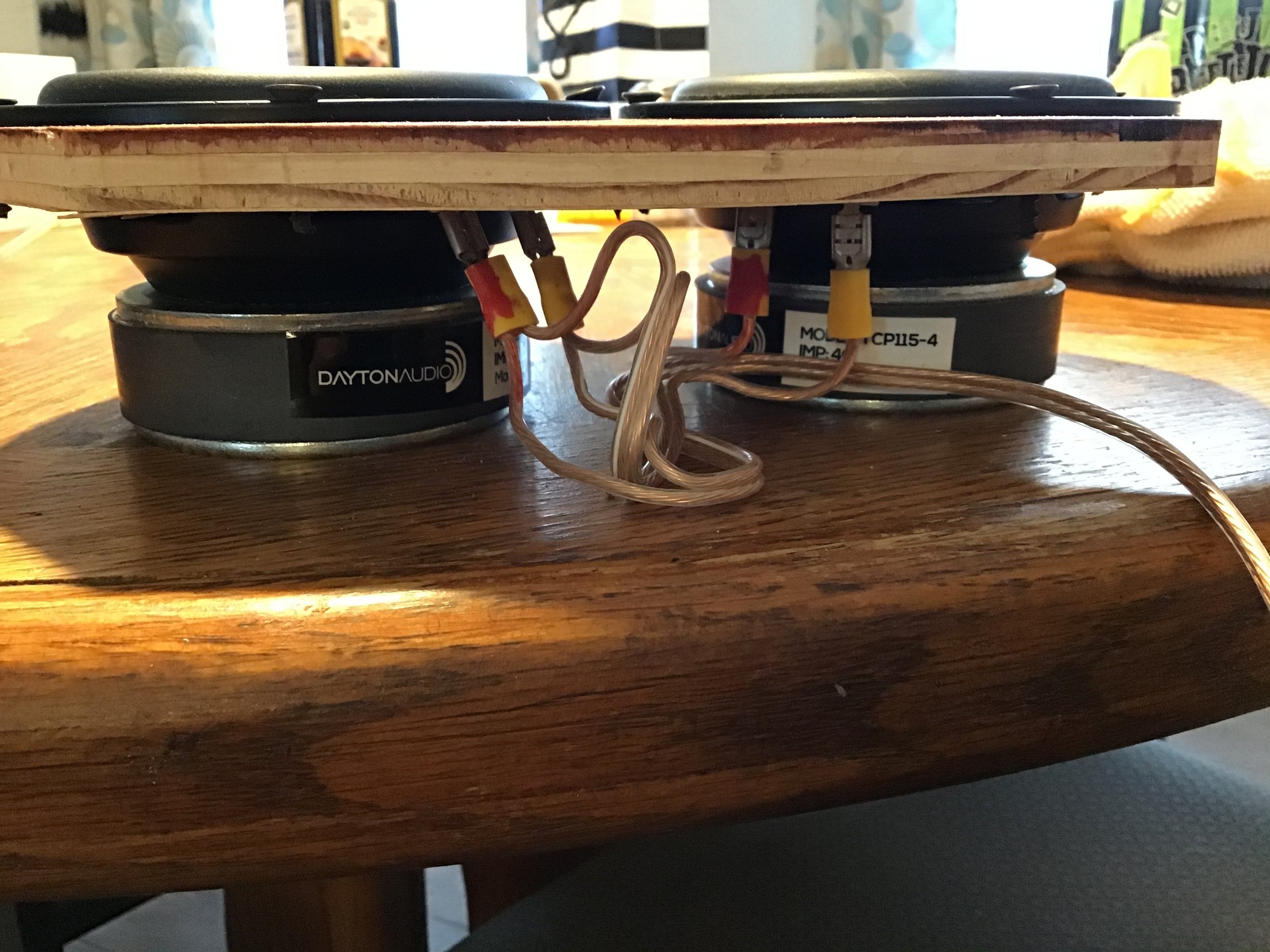

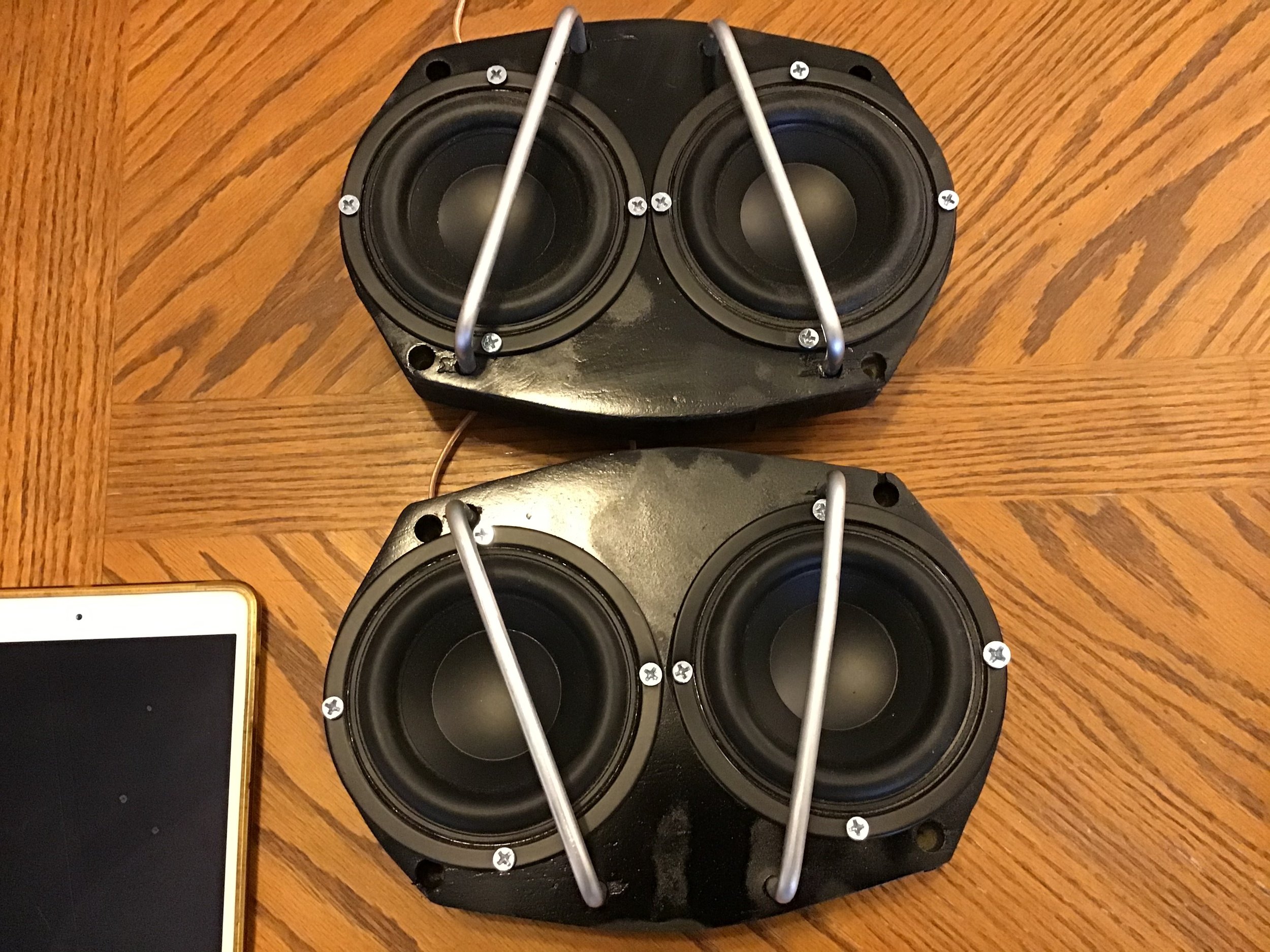

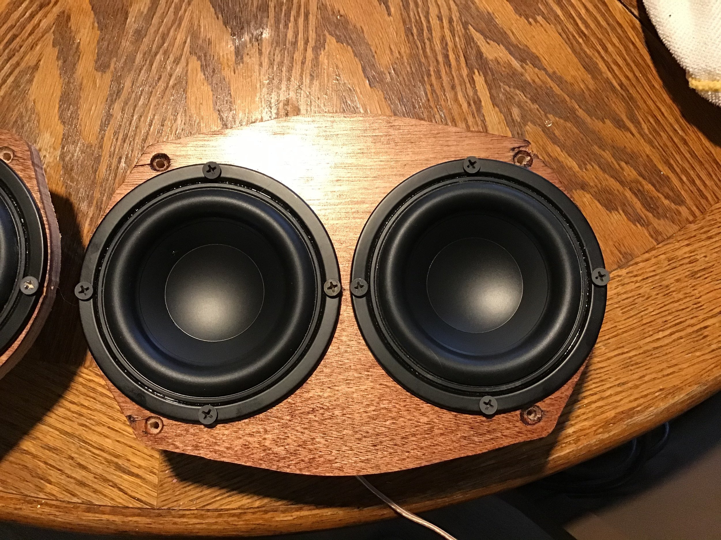

Finished up fabricating the adapters for the 6x9s and mounting the speakers and bars in them. They screw directly into the factory 6x9 spot. Full system ready to install in the car now. Just received my sound deadener for the doors, so just waiting on wiring to show up.

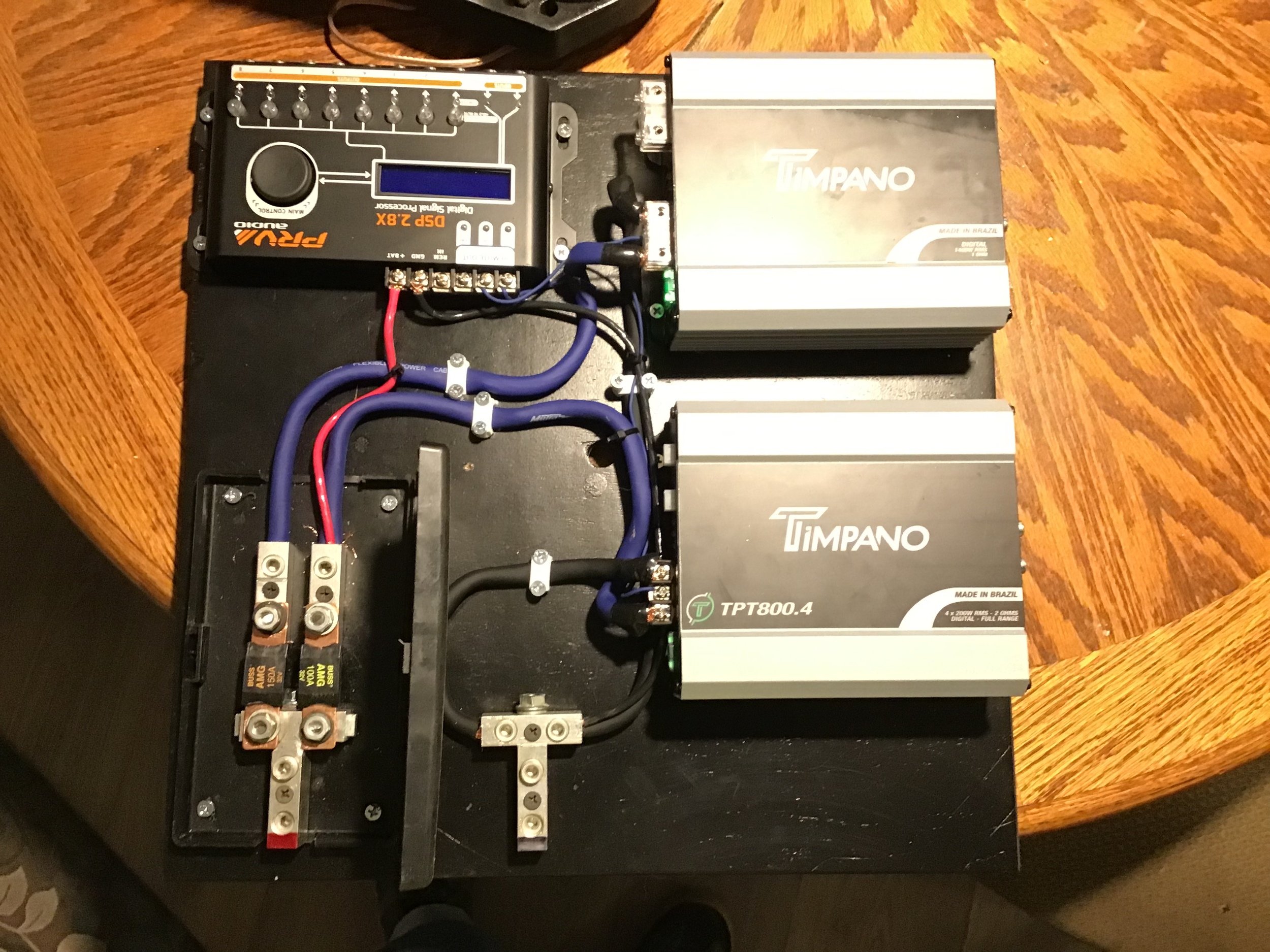

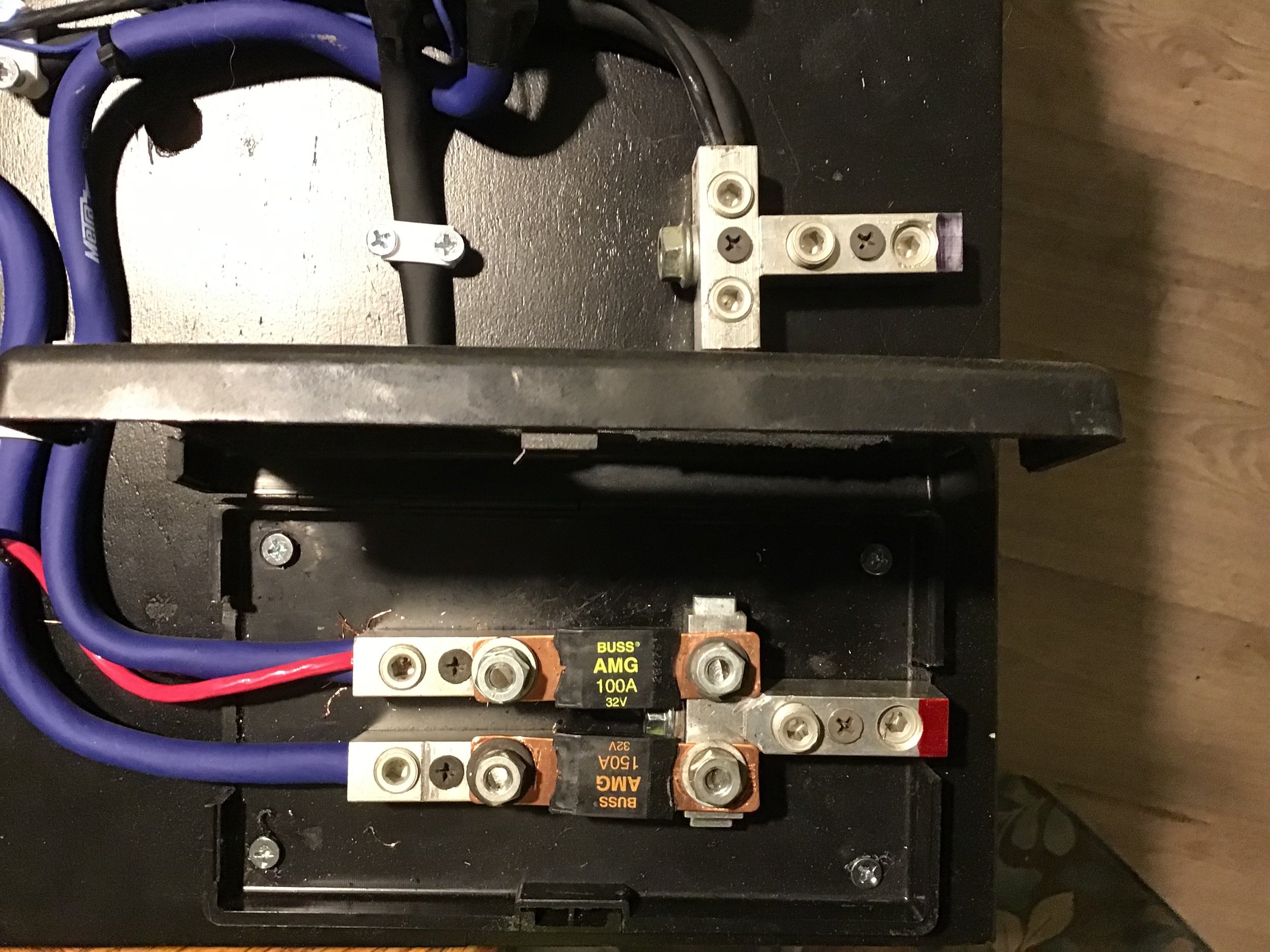

Decided to put the spare tire in the roof rack and use the spare tire well for the amp rack. I made my own fused distribution block and ground distribution.from some 0 gauge lugs I found in the dumpster at a construction site. Running wire through the Jeep tomorrow.
The 2 distribution blocks were made from some 0 gauge reducer lugs for solar panels. Probably going to have to replace the 2 fuses with smaller amperage. 100 for the sub amp and 60 for the 4 channel is what should probably be in there.
What do you think of those Timpano amps?
They seem ok. I’m only running a 300 watt rms sub on the mono amp right now, so it’s hard to say until I put a bigger sub in there. I have 2 audio legion 10s in my shop that I haven’t built a box for yet. In a couple of weeks I will throw those in and see if it will put out the 1200 rms it claims. I doubt it puts out what it claims though. First thing I noticed is when installing is that it doesn’t accept anywhere near a 4 gauge wire. I had to trim it significantly to fit it in the connection. 60 amps worth of fuses on the amp, yet claiming it consumes 150 amps with signal bass in the manual doesn’t quite add up either. If I had to guess, I’d say it’s good for maybe 800 rms, but who knows. These newer amps are designed differently and way smaller than I’m used to. I’m accustomed to even 800 watts rms being double the size of this thing, so I may just be out of touch with these digital amps. I just am not convinced yet that I will get anywhere near the 1400 rms at 14 volts it claims.
