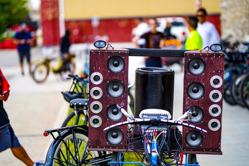

Ty for this and yes I can tell you now the speakers do not stop you from hearing my exhaust as well but im a music guy and love my sounds. Your not the 1st or last to understand speajers being on any bike let alone a sports bike but I refused to give up and I knew where there was a will there is a way
