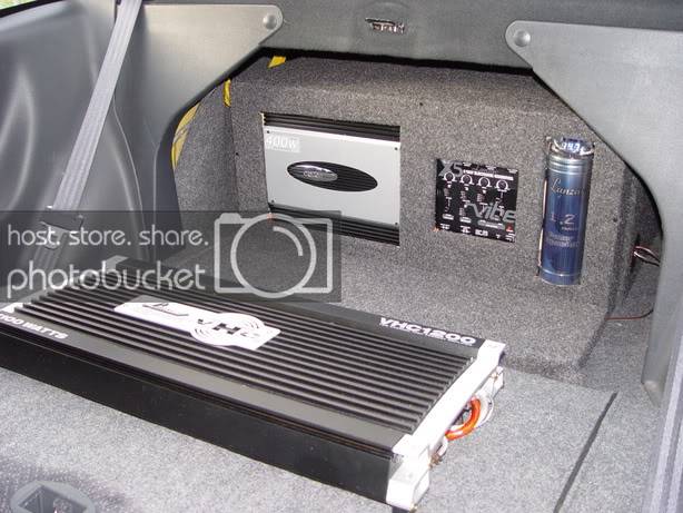

Maybe give you an idea for your amp setup. Was easy to do.

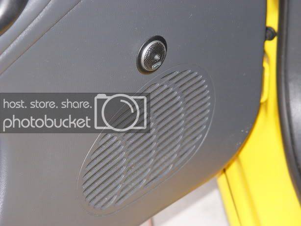

nice car. i love a good clean ls sport. i like what you did with amps and will consider that when i do my new box for sub. we also have our tweeters in same location. how do you like them there? do they get a bit harsh at times? or even blocked by passengers?

today i have a little work to do to the doors. my mid is right up against the door so when it moves it hits the door and makes an annoying buzzing sound so i have a ghetto plan to fix it. im going to put screws partially in my baffle and have them sticking out enough to hold door panel there out. you wont see the screws and doubtful the door sticking out a bit will even be noticed either.
here is a pic of mid to show you how close it is

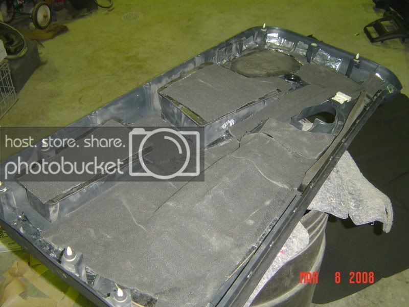

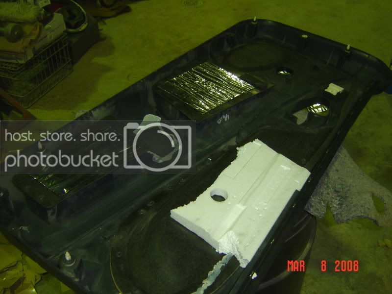

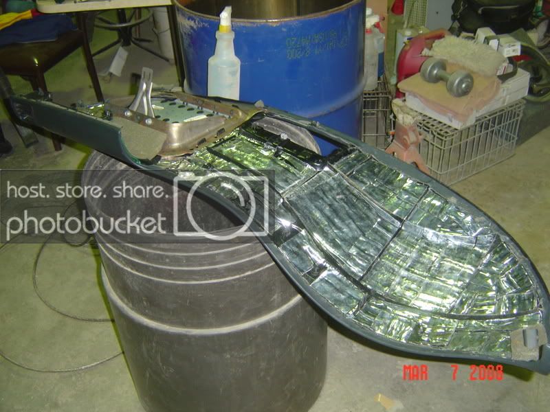

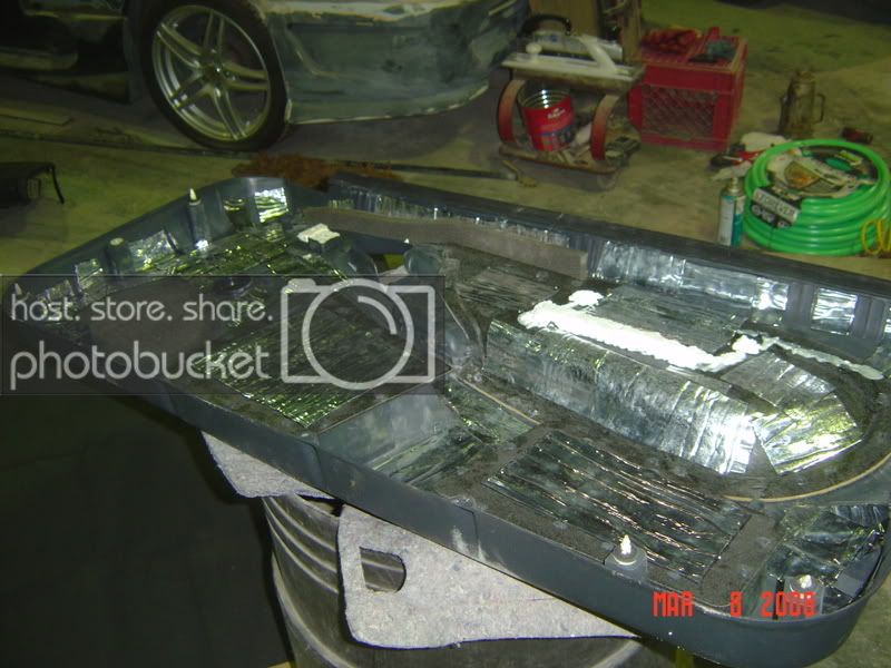

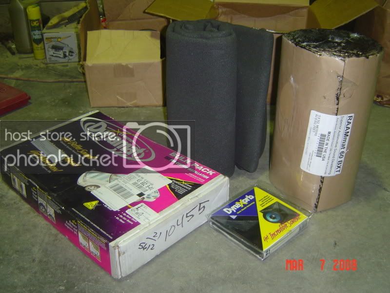

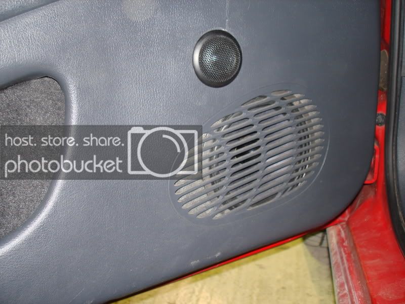

Some pics from deadening i never posted
supplies
before
after
i still need to do some more closed cell in here or maybe some open since its pretty sealed off from moisture
bottom of the top piece of dash

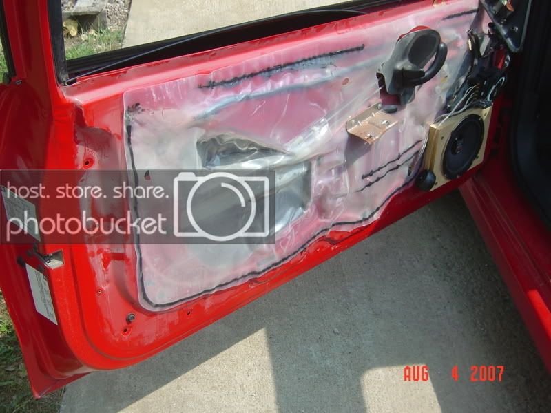

yuck (untreated door)
