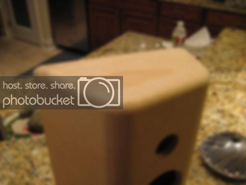

Making a set of Zaph's Slimline wall mount speakers for a 5.1. Had the parts sitting around for about a year. Didn't get pics until most of the way through the build. They're probabyl out of order and whatnot, but I'll caption and post more later.

Ok, so these are for a 5ch setup for my girlfriend's dad. He's paying for them, and they've been pretty interesting to build.

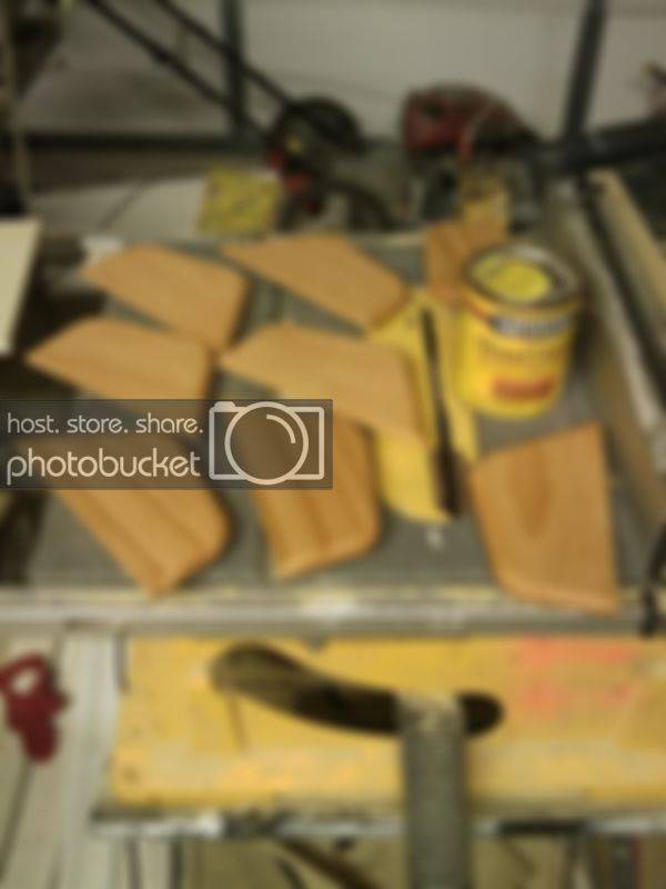

I plan to paint them an off-white color that matches the living room walls, with a satin or flat clear coat on top. The tops and bottoms are pine, and will be stained and finished in satin polyurethane. I'm not sure of the color just yet, as the floors and cabinets are different colors (natural oak vs cherry). I may also scrap the pine and recut new ones out of oak. I'm not so sure the pine is dense enough to not resonate or something.

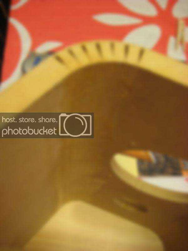

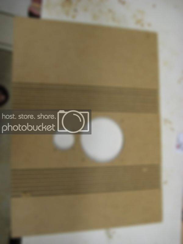

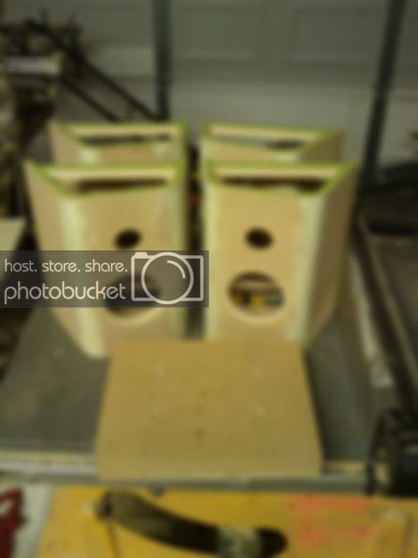

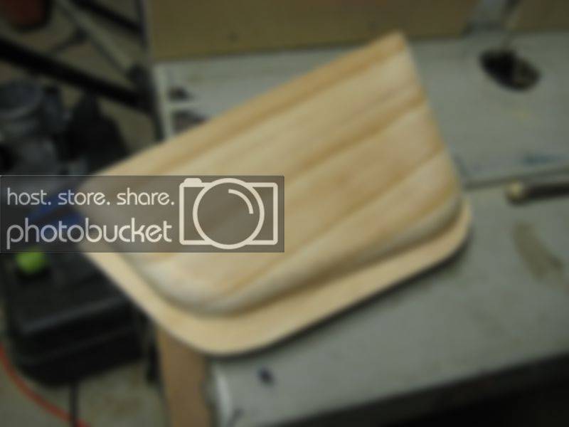

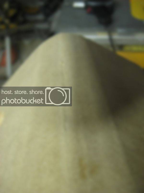

The first four panels I made to bend all failed in one way or another. I had cut the kerfs about 1/32" too shallow and they cracked when bent. I wound up scrapping them all and remaking all new panels. The second set took me 4 hrs instead of 12.

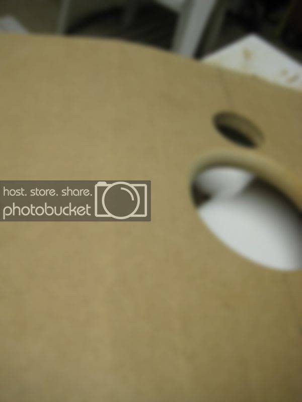

He wound up being a bit more interested in aesthetics than performance, as he has decided to make certain "changes" to the plans. When I made the first four panels, I used the right driver spacing, and he thought it was too thin and didn't look right or something and insisted on separating them an inch on the next ones. I'm guessing it'll raise the best listening angle or something. They're his speakers, so I guess I can't complain. The other change was rear-mounting the driver like I had done on other speakers. I didn't really say anything about it though, as I prefer it myself and I haven't ever really noticed anything negative about rear-mounting them.

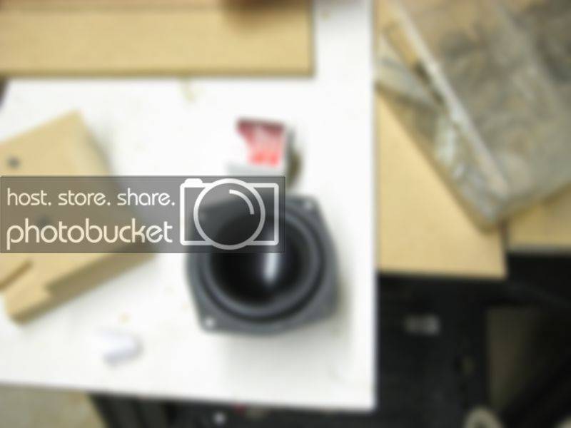

The drivers: Aura NS3-193 & Dayton ND20TB-4

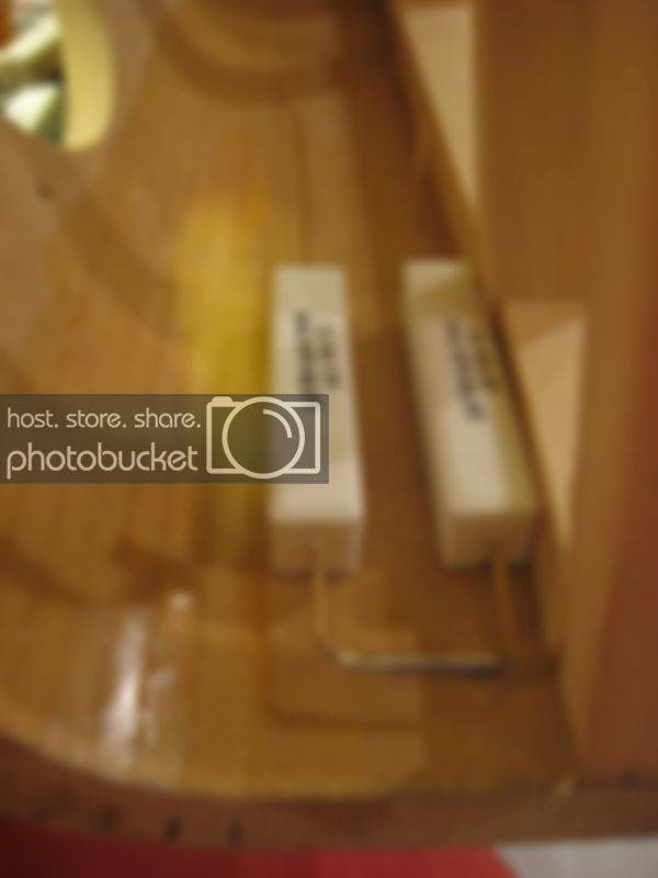

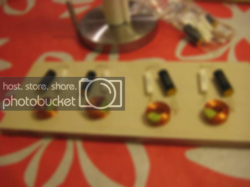

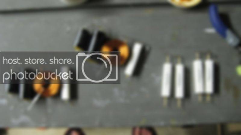

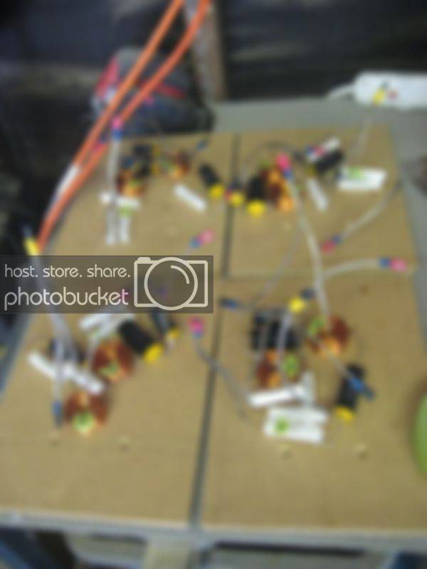

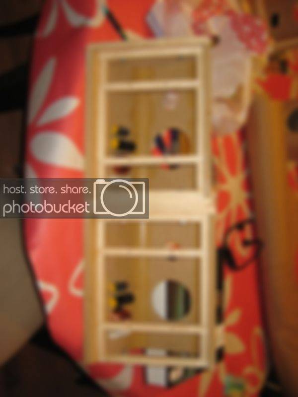

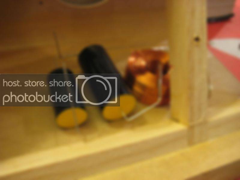

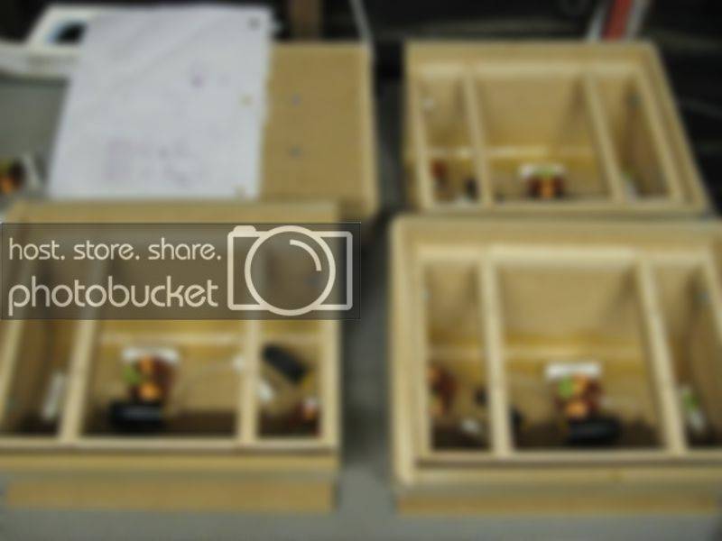

Crossover sections done for the night
Tweeter sections

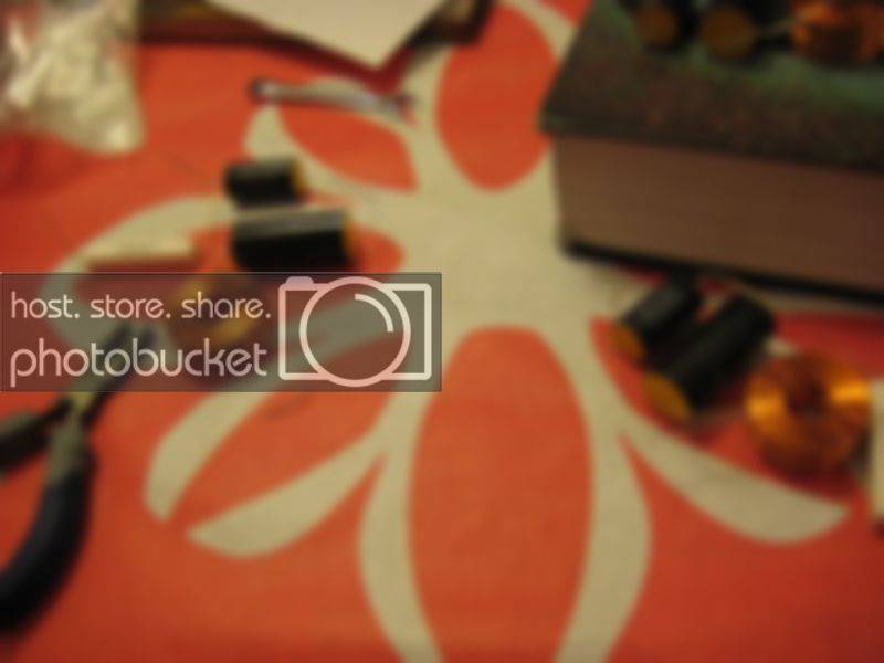

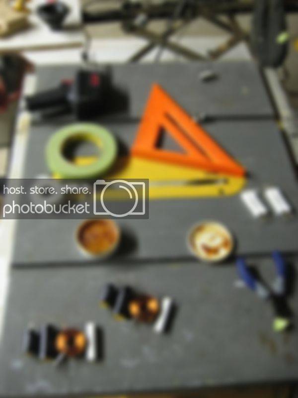

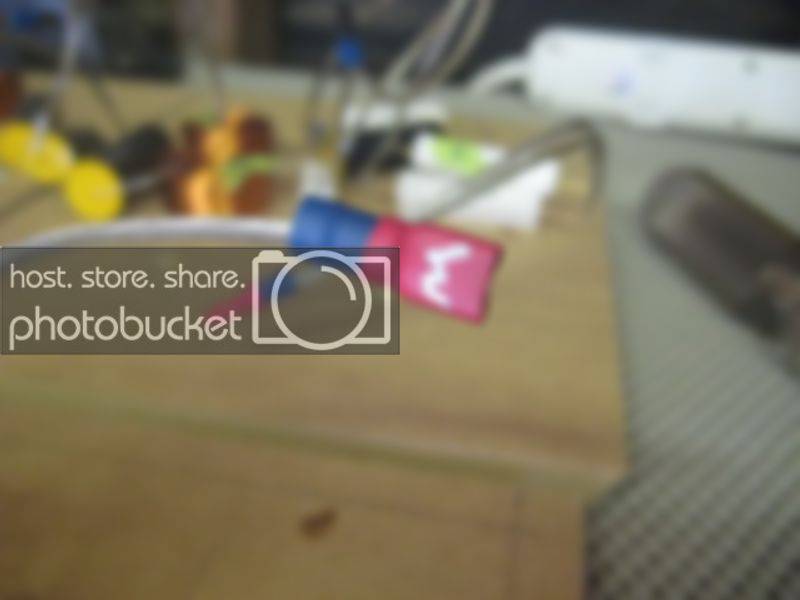

Solder station
Bending leads

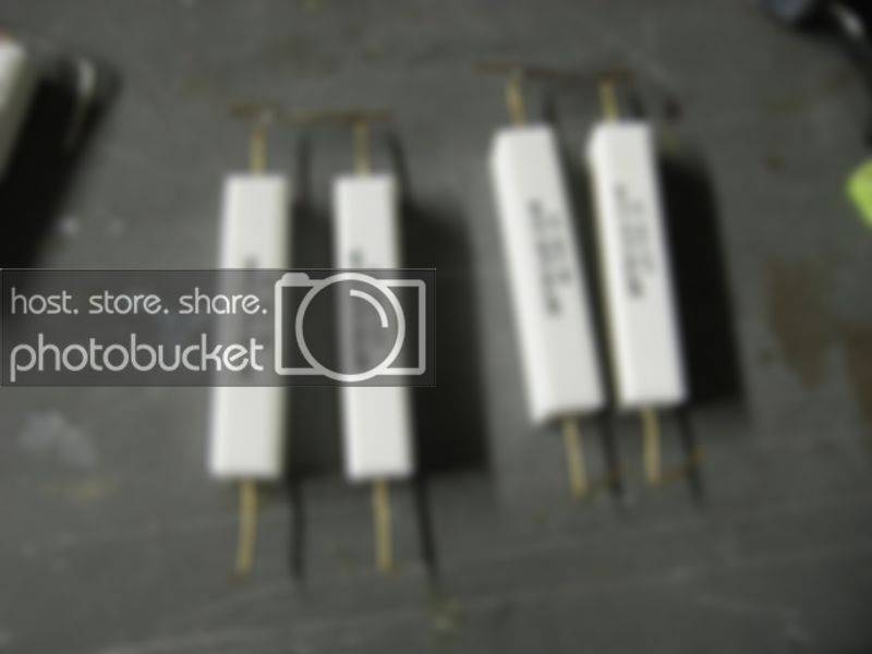

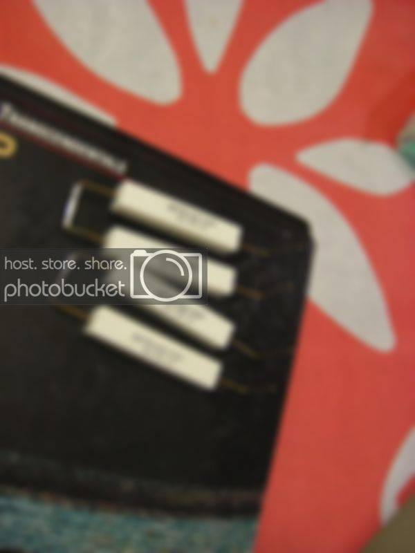

Separated crossover components

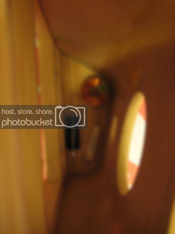

Placement on short side

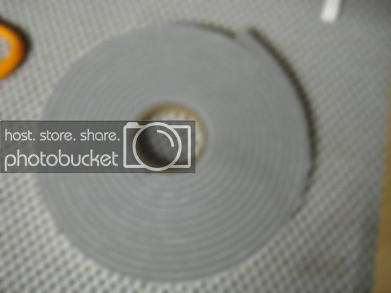

Gasket for backs

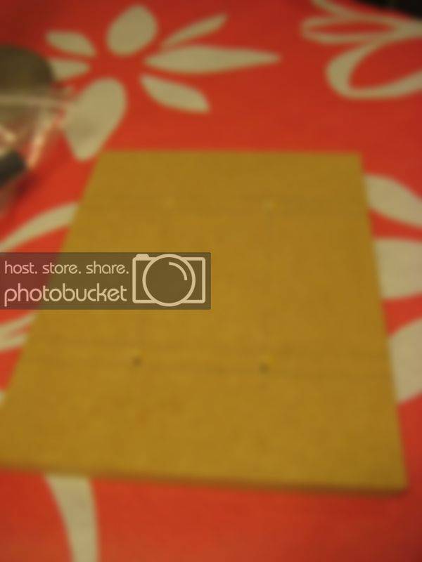

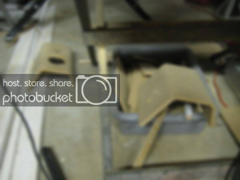

One of the orignal 4 panels
Cracks on the original panels
Scrapped panel
Pile of scraps and failures

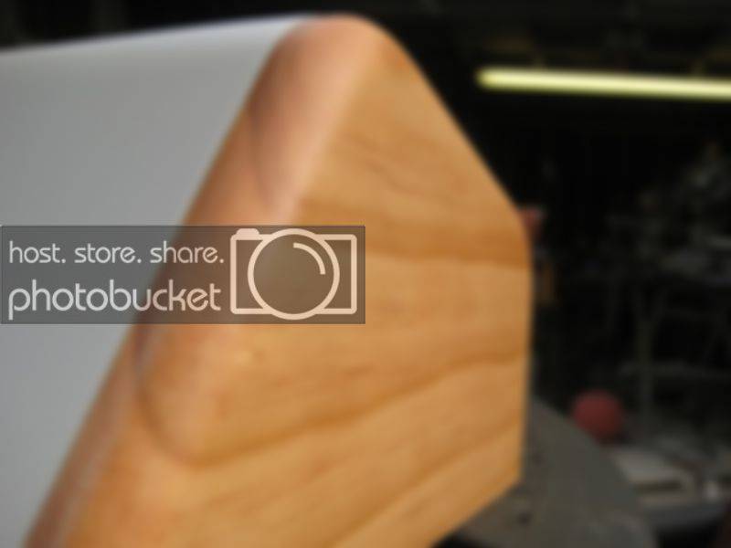

Pine top and bottom

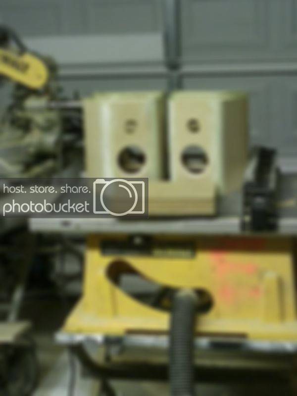

Woofer section placement
Kerfs
Back shot
Xover progress

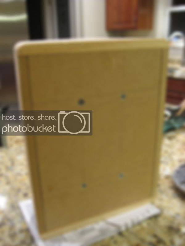

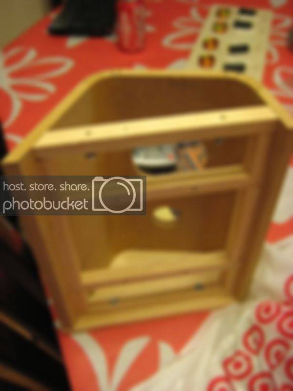

Back panel with predrilled and countersunk holes
Woofer sections done
Back testfit
Nice and flush

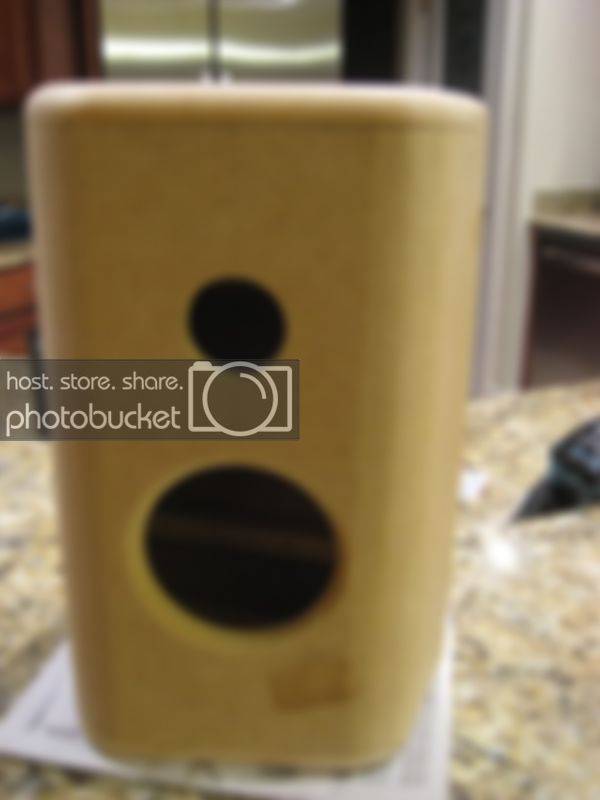

Tweeter section placement

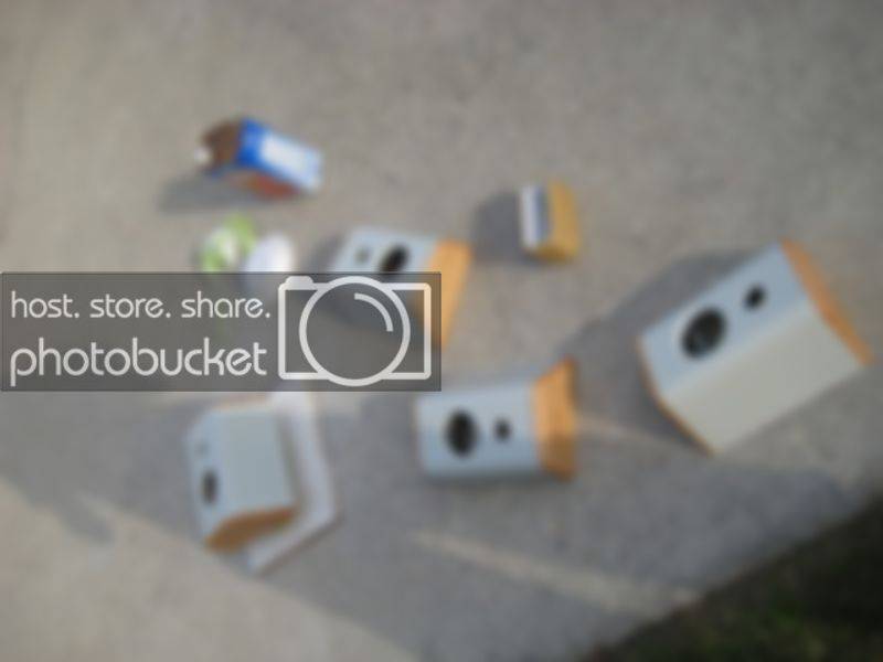

I also has some progress on these this weekend as well. I went to the shop on Friday to check out a totalled Jeep to see what was worth salvaging. Lots of nice interior. And a back bumper. //content.invisioncic.com/y282845/emoticons/biggrin.gif.d71a5d36fcbab170f2364c9f2e3946cb.gif

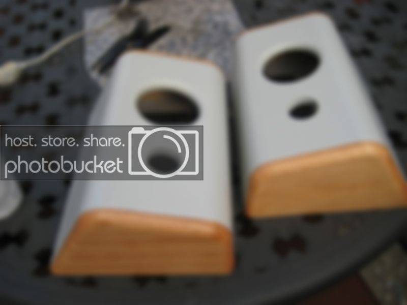

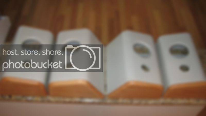

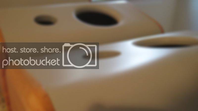

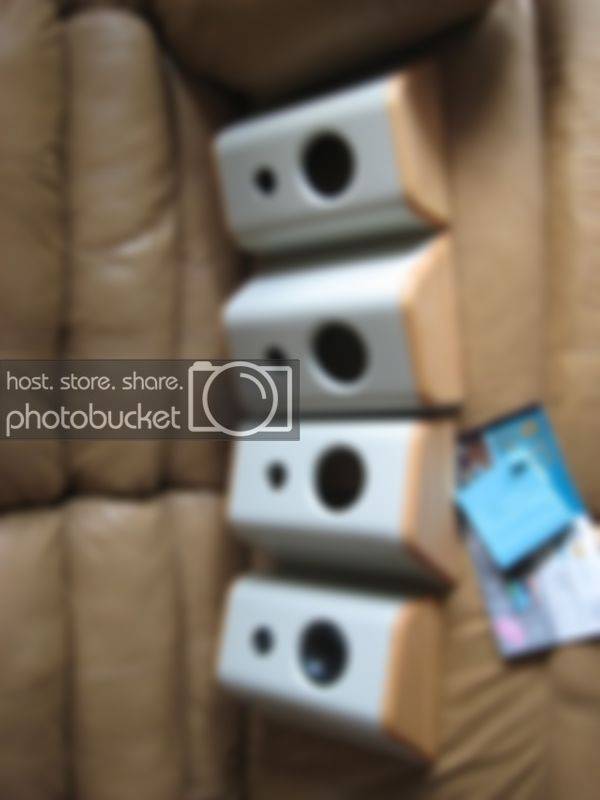

I also found the speakers in the paint booth, painted and dry. But there was a small issue. They were gray. I'm guessing he told the paint guy off-white (they were supposed to be a cream-colored off white, because the same color he uses in every **** house he lives in/renovates. I guss he paint guy decided it meant off white as in slightly grey...I dunno.
I asked him, numerous times, if we could repaint the, and if he was okay with the color, and hesaid he liked it, which was exactly not what I wanted to hear. I mean, I know they're not mine, but **** do I hate that color. It almost looks like someone just sprayed clear over primer.
Sigh...
The tops annd bottoms are all glued on, and next I'm going to hit the whole thing with a satin clear coat. Then I can put the croosvers in and finish them up. Still unsure how I'm going to mount them. I'll probably just do what Zaph did on his, which is flush mount some picture hangars.

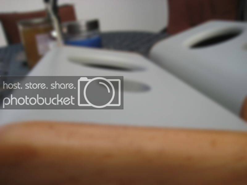

I'm getting close with these.

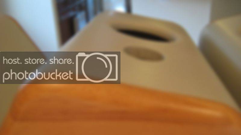

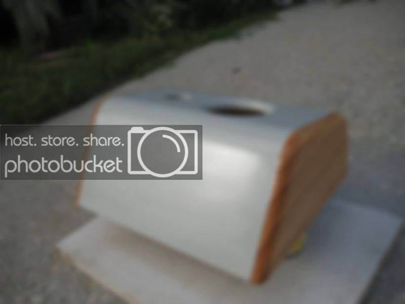

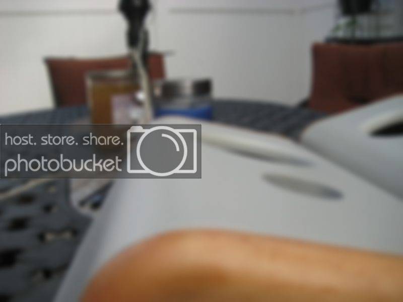

I got a can of satin clear from Lowe's, since it wasn't going to be worth it for the paint guy to mix a batch of flat clear just for these. But it actually worked out much better than I thought it would have. Just enough of a dullness. It also brought the wood out a bit.
Spraying this stuff was a little strange for me though. I'm use to thin buildup over time, but with this stuff you have to pretty much just pile it on all at once. I usually ruin stuff like that with glossy clear, but for some reason that was how it worked best.

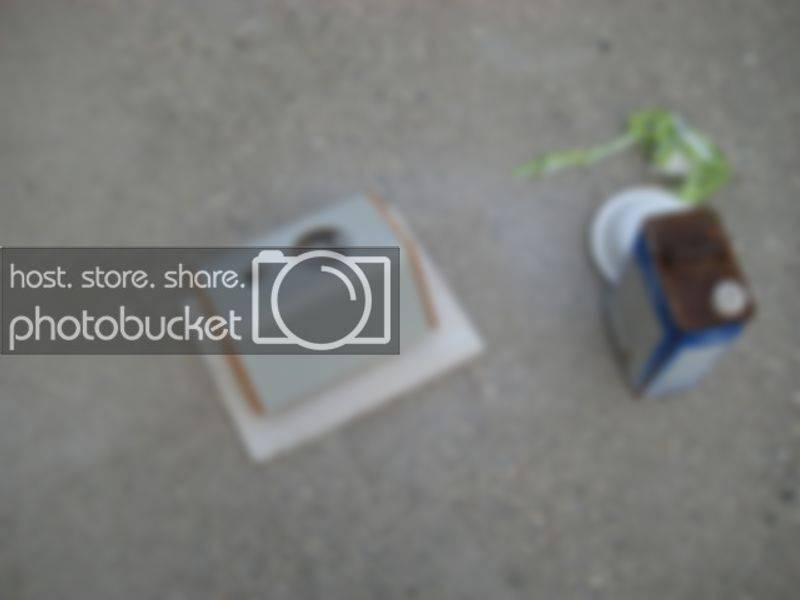

Drying

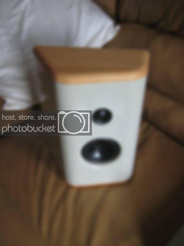

Ok, so I'm really starting to like the color. I think it's just the clear, but they look pretty **** good in satin.

Although I do have to ask, what kind of response are you getting with those NS3's mounted below the baffle surface? I can imagine some massive baffle diffraction step issues with some of the radiating area just running into wood //content.invisioncic.com/y282845/emoticons/crap.gif.7f4dd41e3e9b23fbd170a1ee6f65cecc.gif
**** you're good //content.invisioncic.com/y282845/emoticons/omg.gif.05aa02c3095d6ce9338996654eca0863.gif
Haven't seen you around in a while. Not really sure the effects from rear-mounting, but I just can't bring myself to put that ugly *** stamped frame and exposed surround out front on a nice build.
I don't have a calibrated mic or anything, so I can't really test with any accuracy, but I imagine it would mainly just **** off-axis response. The mtm I did with them is VERY directional.
