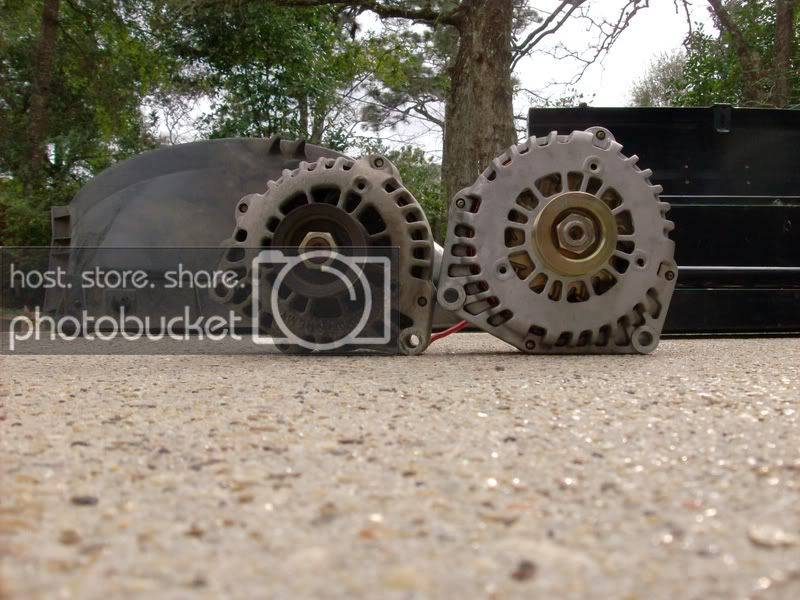

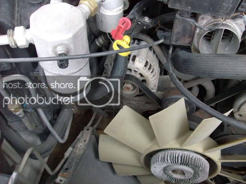

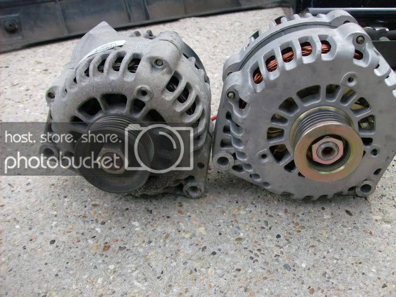

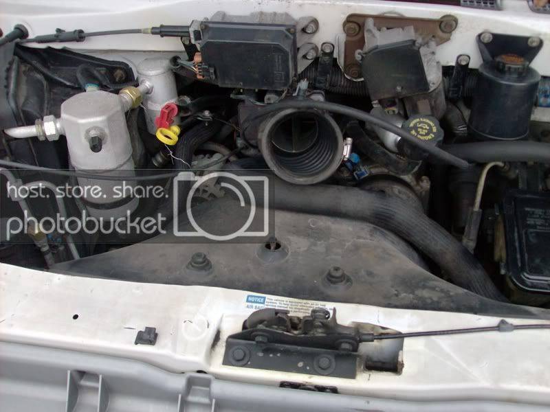

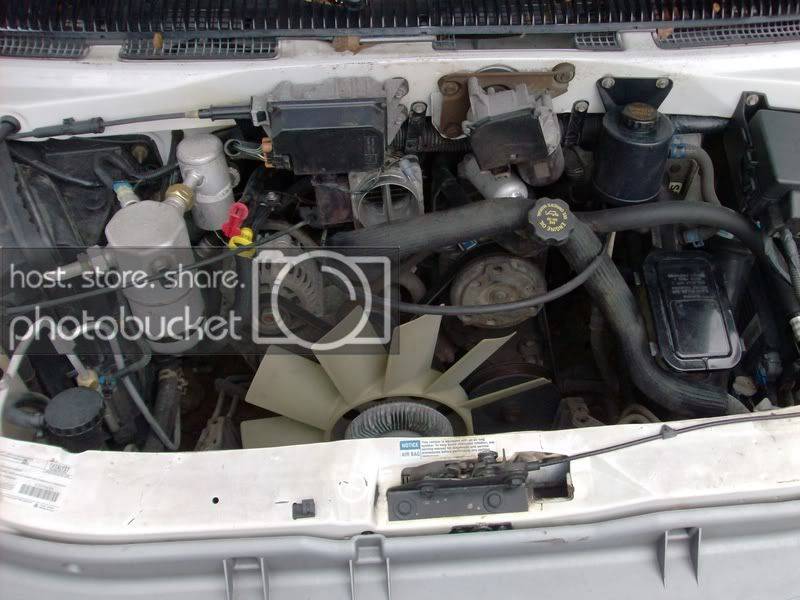

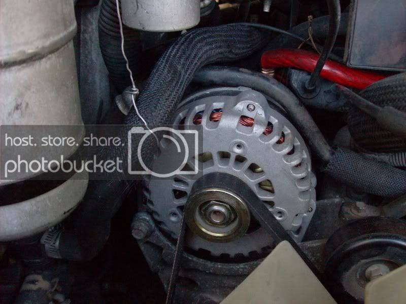

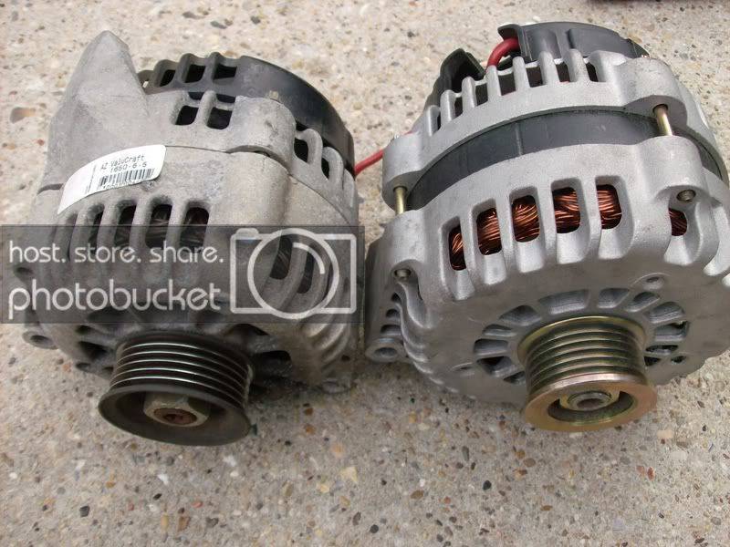

got started on the alt install and big three. the engine compartment in this van is very tight and it don't help that i have big hands.

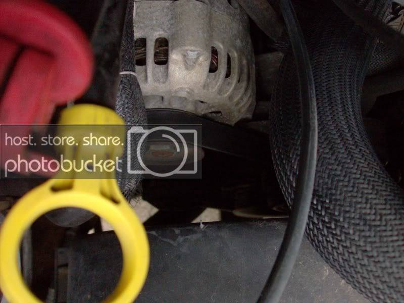

upper fan shroud aready removed for pix.

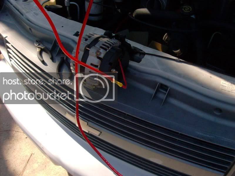

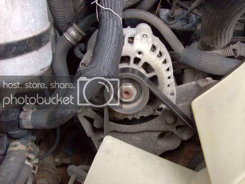

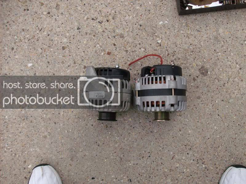

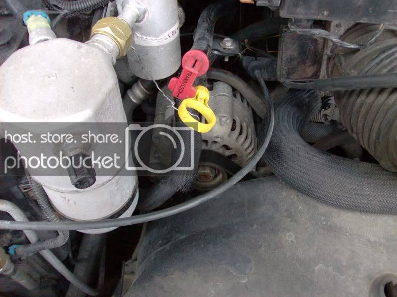

alt gave me hell getting in. it fits fine but had so many harneses and hoses that did not want to budge...lol

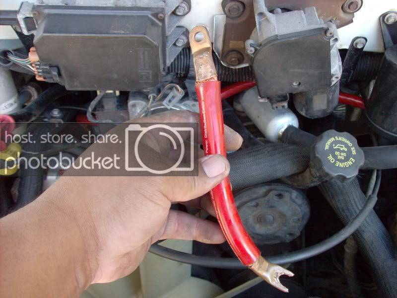

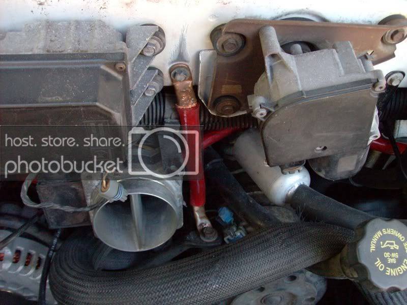

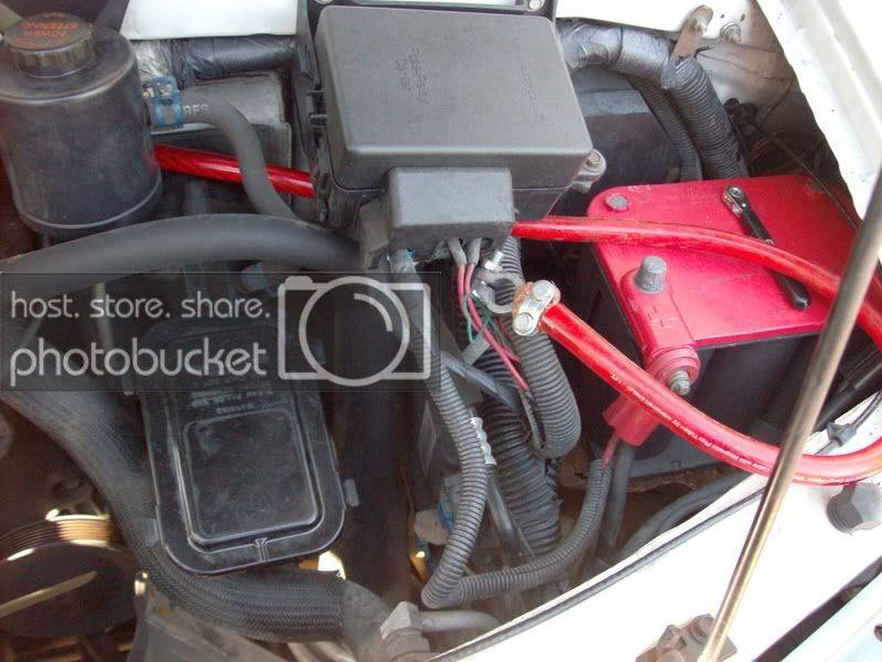

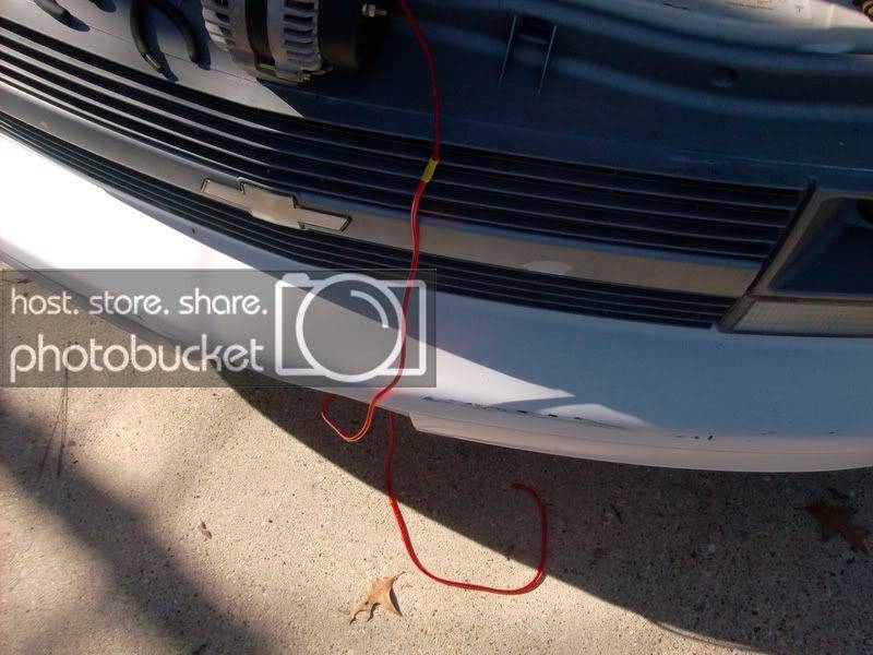

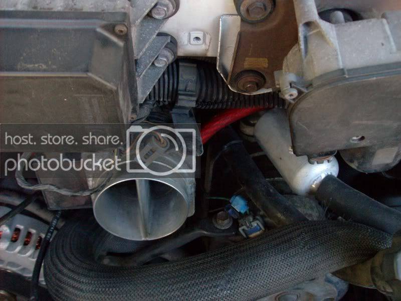

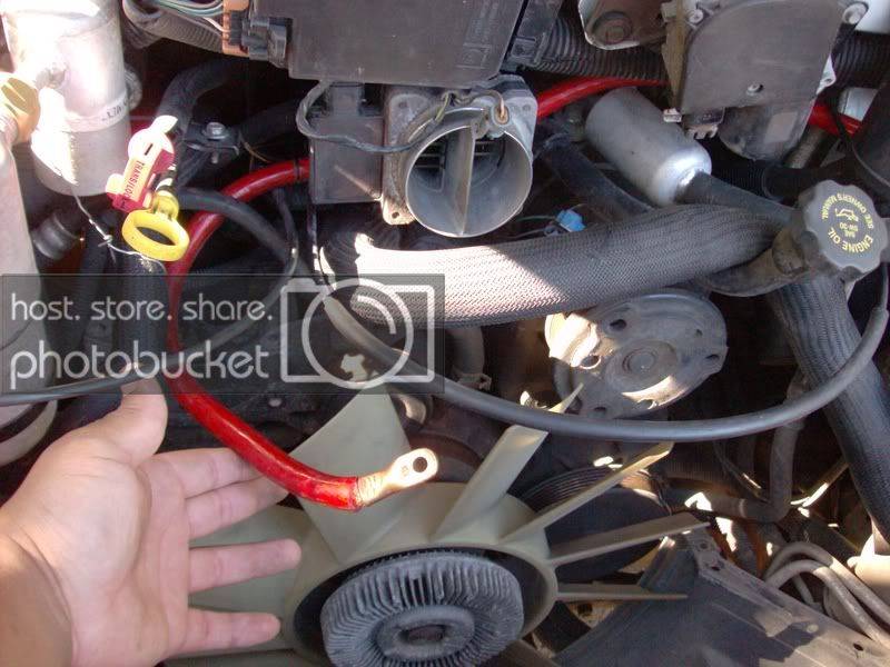

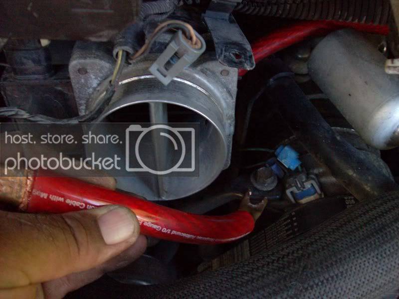

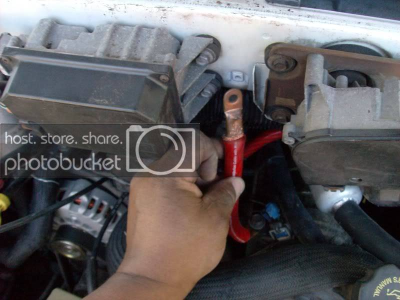

got two of the big three don. tomorrow i'll do the third, 1/0 batt to chasy. i got 2 8' runs of 1/0 that i'll run from the front batt to the inside sence i got the engine cover removed from the inside and don't want to got threw the truble of buttenning it up and takeing it back apart in the future. lol i'll just use cupplers to complete the two runs all the way to the back.

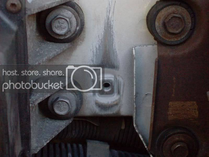

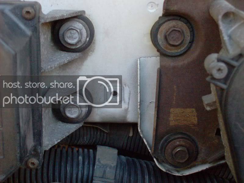

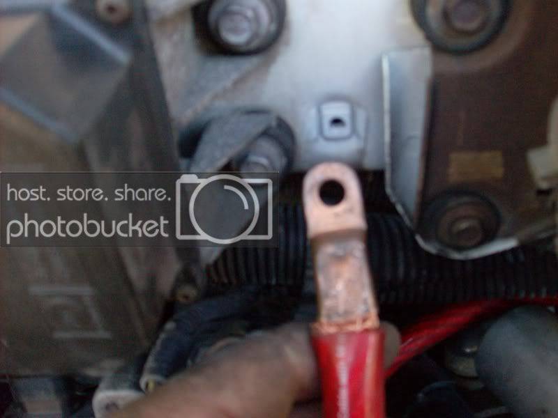

//content.invisioncic.com/y282845/emoticons/confused.gif.e820e0216602db4765798ac39d28caa9.gif is that where it should have been? what's wrong with this location?
well check where your stock ground is, mine went right to the frame. i do have my batt grounded to the frame and to the firewall. with the power your running, i would run the ground directly to the frame. where do you plan on grounding your amps? nothing really wrong with that location if you plan on running grounds up to the front too
well i'll find a frame ground too then. amps will be grounded in the back. their are two metal loops bolted to the floor of the van in the back for the cargo net. i think they are bolted into the frame.
