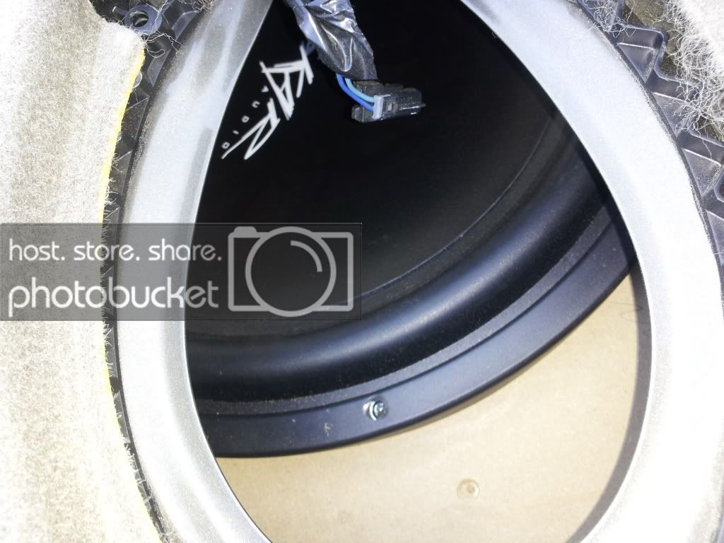

with it sealed within the cabin (which it already was I guess since the trunk wasn't 100% sealed since you could see the sub through the speaker hole) would this hole be adequate enough for the cone issue? or could I drill more holes in the sheet metal (minus damaging the carpet)
And I'll be uploading another video of some music with (Decaf) Gucci Mane - what u know bought me, it sounds pretty beast
it is good you can see the cone, but you're still losing energy to the trunk. i would want a 16" dia hole above the sub with trunk airspace sealed off. sealed in the cabin means neither cone nor port air can make it to the trunk. if you wall off around the box, tight to the rear deck on all 3 sides, you can get close enough and leave the rear deck as-is.
that may not be possible with your trunk arrangement.
Take the expanding foam and put a wall of it around the backside of the box so air escapes from a smaller area. When you open your trunk you don't want to be able to see the subwoofer.
[quote name='mazdakid']Your sub wont fit on the front next to the ports?[/QUOTE]
Not really, I've got about 15" between the left wall and the closest port opening, after a few months or a year or so I may rebuild the box into something different, maybe worm out 2 15's, for now I'll work on fine tuning it to the best that I can without too ma.y body mods, maybe later I'll cut out the rear deck, thanks @keep_hope_alive for the help.
They are right....it's like half assin right now how it is.
How you did works in 4th orders because the sub fires into the box and then out the port.
You will need the sub and port firing into the cabin //content.invisioncic.com/y282845/emoticons/smile.gif.1ebc41e1811405b213edfc4622c41e27.gif In your case
