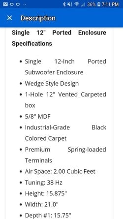

I purchased the enclosure and sub directly from Skar through ebay and okay my wording wasnt so specific that you interpreted generally. I'm fairly novice obviously. Thanks for your time though. No farther questions
the sub sonic filter should be set to just about where your box is tuned to. Anything below can cause damage to your woofer, but if its sealed, set it to its lowest setting. Gain setting in the video above and the lpf should be a tad higher than 80 imo. Depends on what you listen to i guess. If youre a strictly rap guy, 80 should be fine, but anything other than that will have bass up to around 100, 110 or even 120 just be sure to not let your mids be doing the same frequencies or itll sound like poo
"When used with a ported enclosure, we always recommended turning the Infrasonic Filter on your amplifier on. In some cases, the filter has a fixed center frequency between 25-30 Hz. When this is the case, you would simply turn the filter on. In other cases, the Infrasonic Filter Frequency may be variable. If this is the case, we suggest setting the frequency to 5 Hz below the tuning frequency of the ported enclosure."
