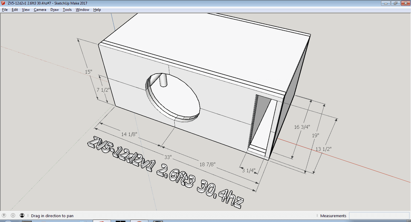

Single box for a sundown z v.5 2 ohm dvc “12
I tried a kerfed enclosure... I'm not ready for that in Sketchup apparently... lol
Just playin' around... //content.invisioncic.com/y282845/emoticons/nerd.gif.c6fa51ddf7ff75f1c0371fbc648f70ae.gif
3 cubes, 30-35” of port tuned to 28hz //content.invisioncic.com/y282845/emoticons/yumyum.gif.0556df42231b304b9c995aefd13928a8.gif
My Xv2 12 is tuned to 29hz. Tuning to 28 when I get my Zv5 18s //content.invisioncic.com/y282845/emoticons/yumyum.gif.0556df42231b304b9c995aefd13928a8.gif lowz4lyfe
