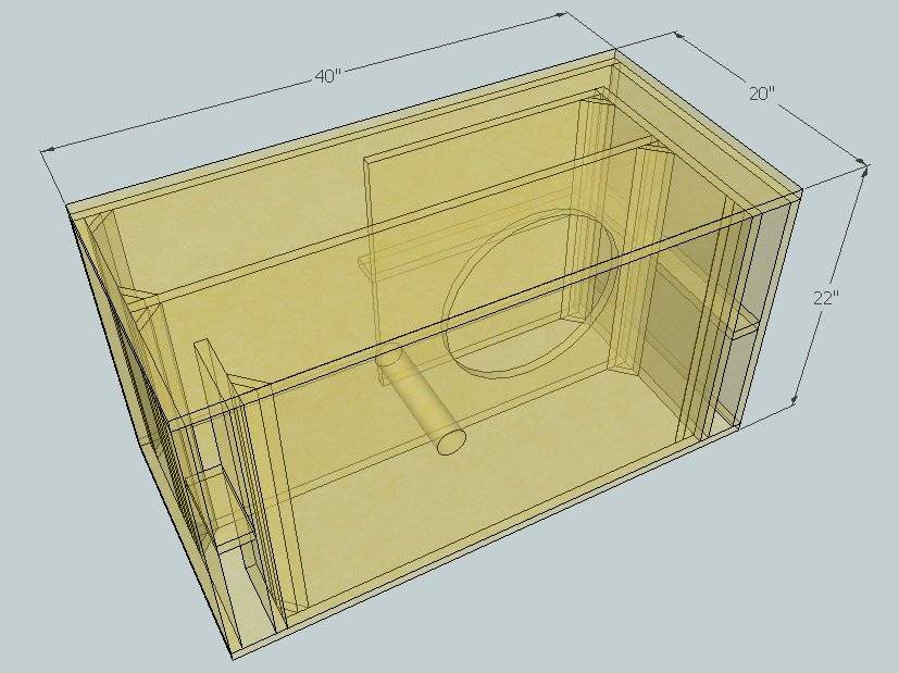

Hey everyone, i am going to build a new box tomorrow for my single xfl 15. I have a few questions on the box design. My goals for this box are to get really loud (wake the dead loud haha) while still sounding good musically. It will be running off a ppi bk1300, so not exactly a lot for the xfl. I have an eclipse so i want the box to be placed where the back seats would be. That will give me the most space. I just really want to wake this sub up with an efficient box.

What sort of dimensions are you working with? How much room you have will be your biggest limitation to efficiency. Having a lower Qts and wanting to be very efficient, I'd suggest a parallel tuned 6th order. Really comes down to how much room you have though.
Around height 22, width 40, and depth 20
With your dimensions I came up with 3.15 cubes @ 28 Hz and 3.37 cubes @ 56 Hz. This sort of enclosure will be very efficient and still cover a nice daily bandwidth.
