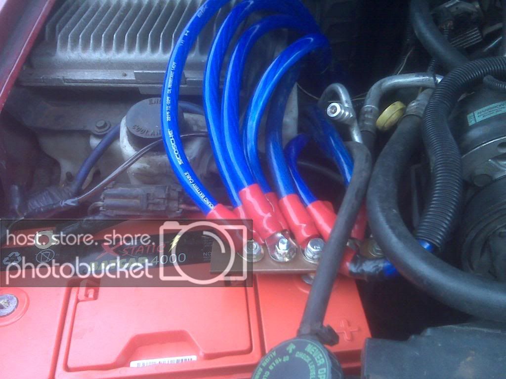

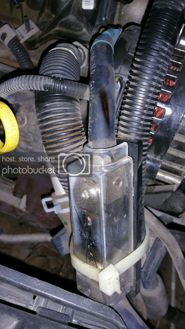

I have two 1/0 from front batt to rear batts and one 1/0 from alt to front batt. Add more from alt to batt as well?
Well I've got 3 runs front to back batteries then to the amps. And I drop to 12.5 on heaven notes. Whate amp ? So I'll be adding more wire soon myself
Yea ok that explains a lot. Amps aren't efficient at all adding more wire will help. But maybe not by much make sure you have grounds front to back as well and a well secured dedicated ground to the frame
