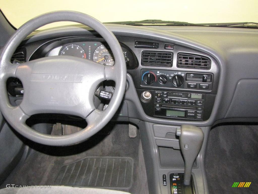

Nice, I just put in my deh-prs80 the other day and it has a rear usb as well. i had to run a usb extension from the HU, screwed a hole in my lil dash pocket and hooked up to my ipod from there.
not my car but you can see the pocket on the bottom
