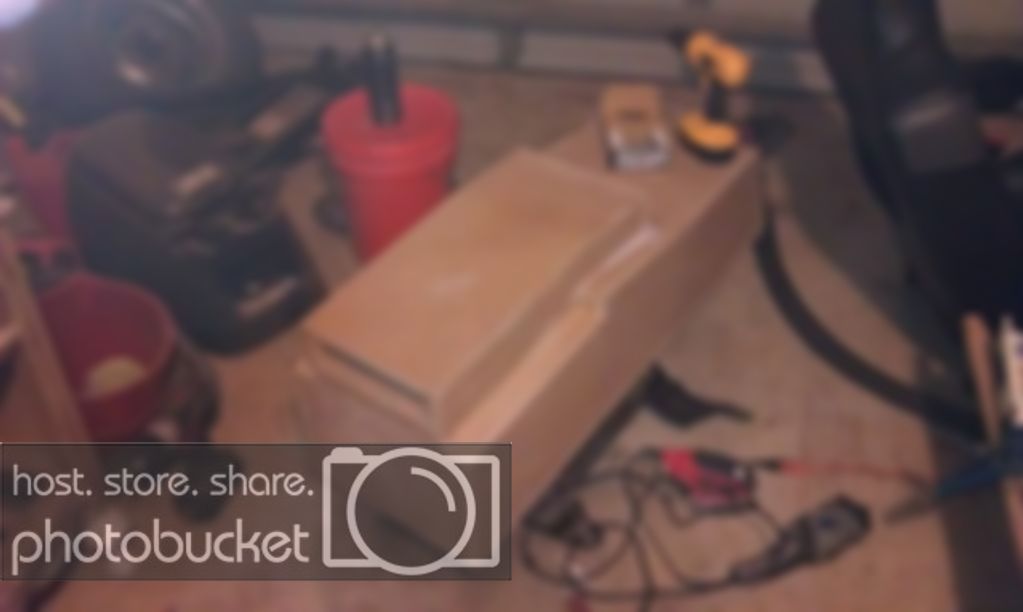

so this is what I have so far but I have some more questions at this point. Any recommendations for wrapping this thing it's far from a simple rectangle? I still have quite a bit of sanding ahead of me but it is coming along pretty well I spent a lot of time trying to make corners and edges smooth inside and now I am trying to smooth out the outside. feel free for input
