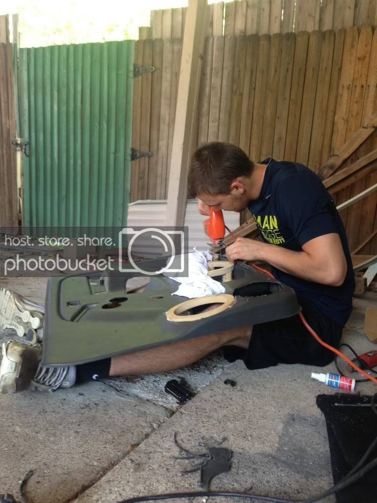

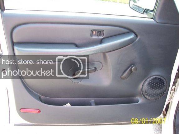

Started off like this
Me workin on em

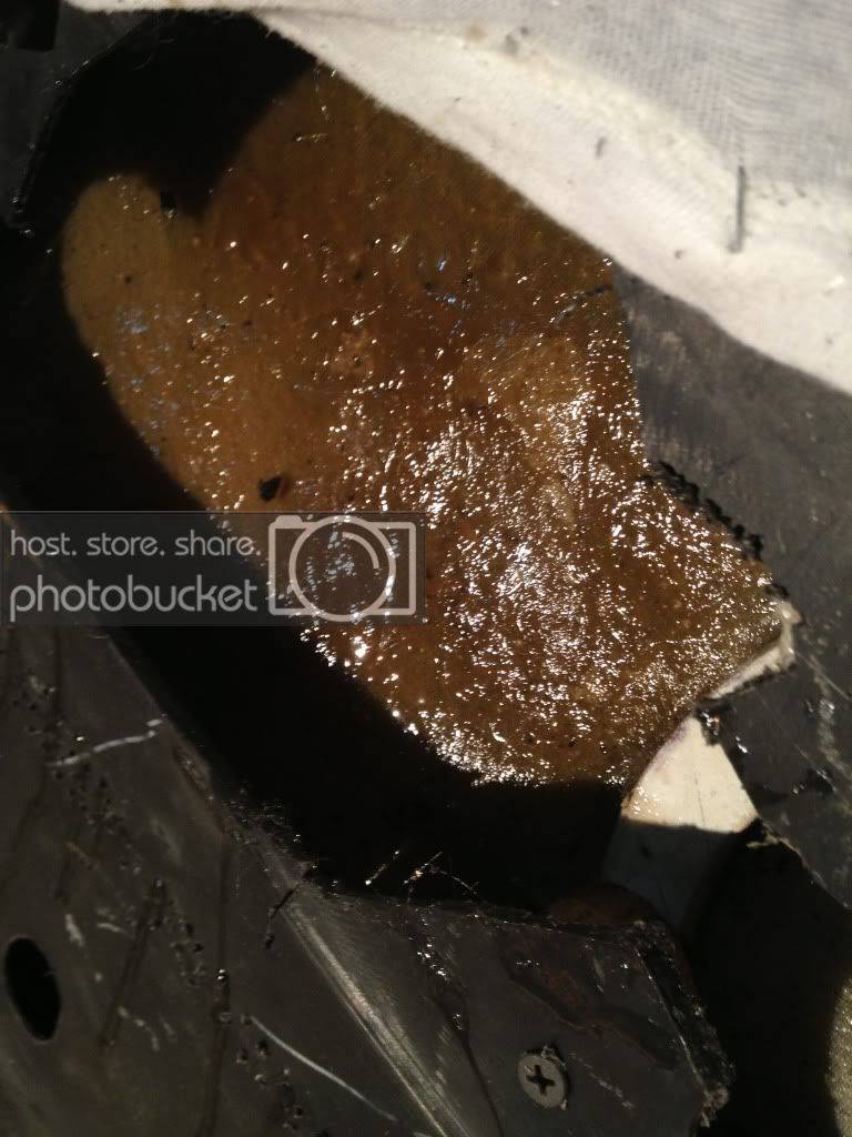

Resined

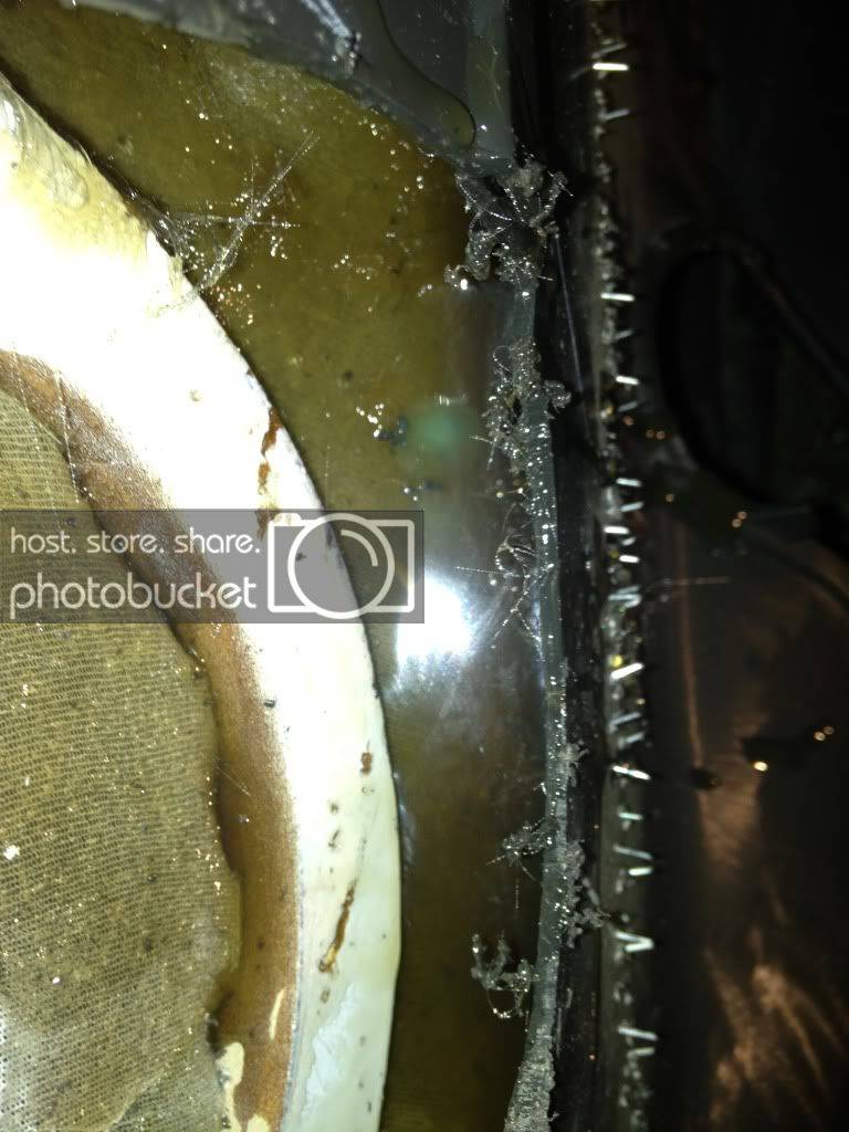

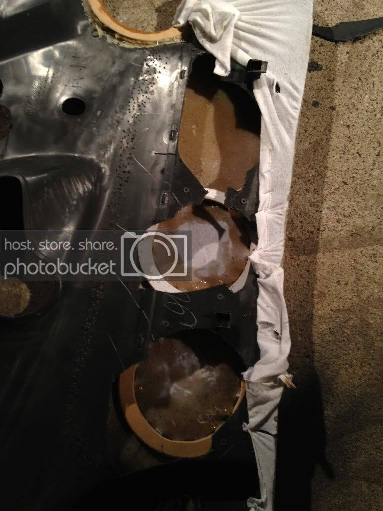

First of 3 total layers on these doors, they are heavy as fuck but I didn't want them to ever, ever come apart so he could run these door panels for as long as he wants
I was laying down lots of fb mat at one time so I would pool the resin like this picture then once I dropped about 2-3 layers of mat in there it would soak it all up and lay up really nice.

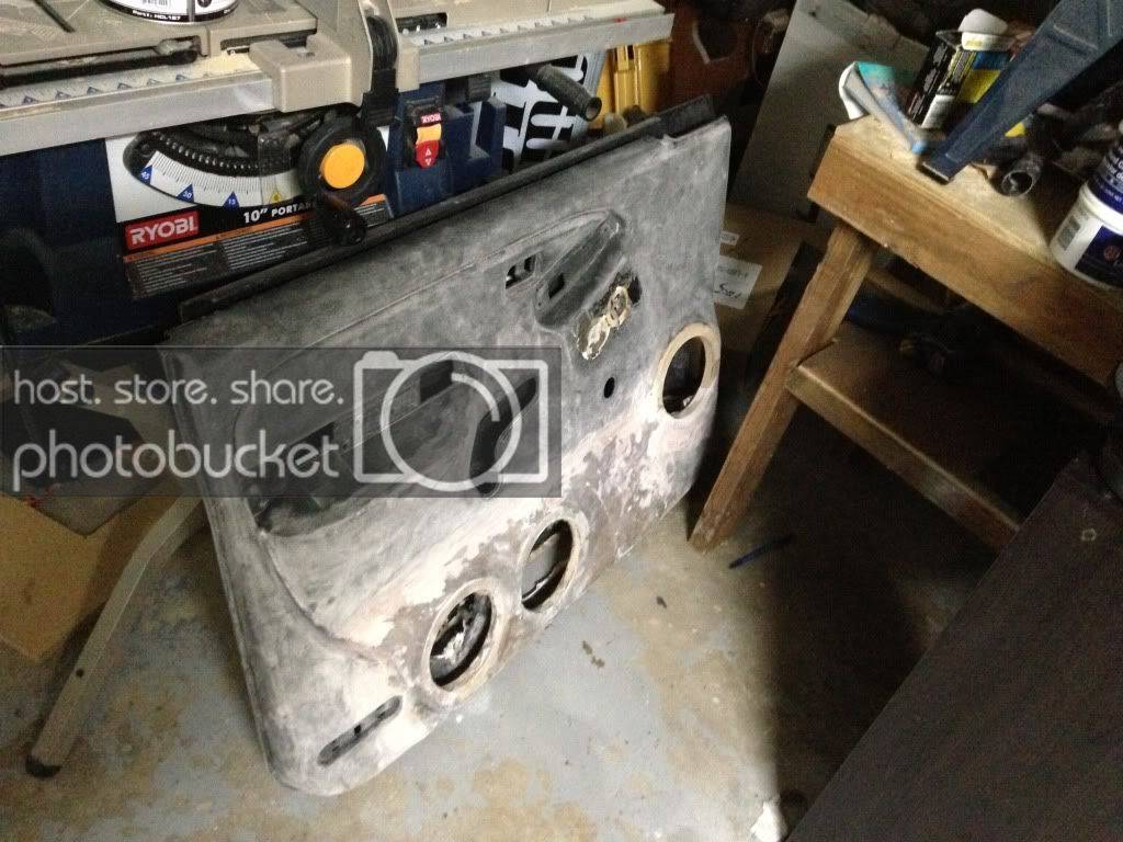

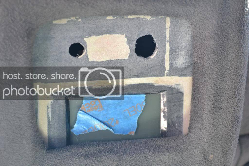

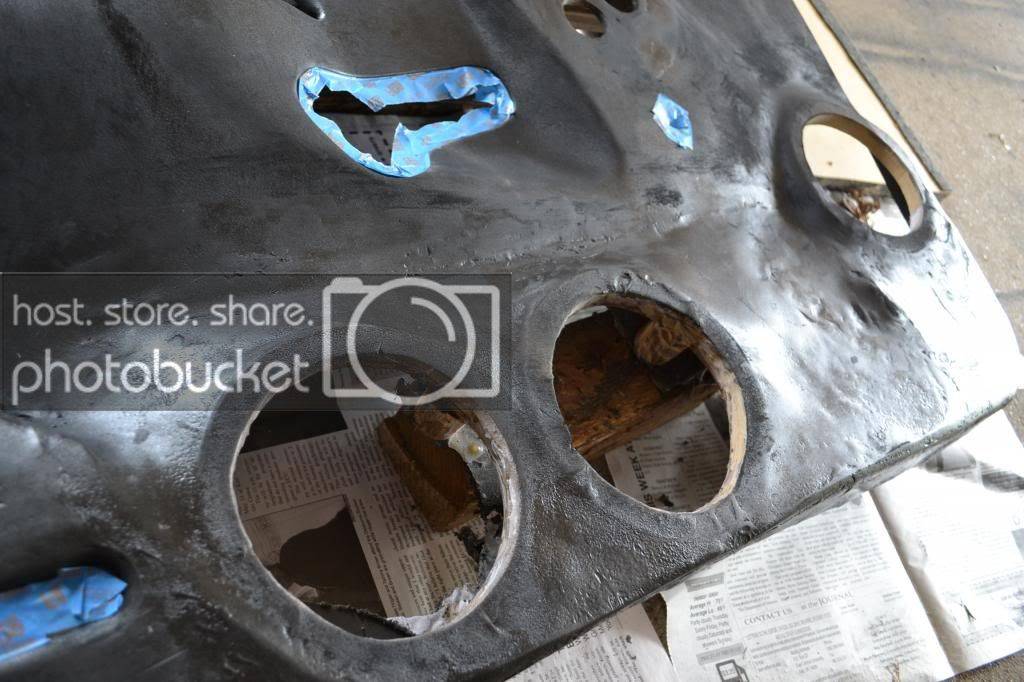

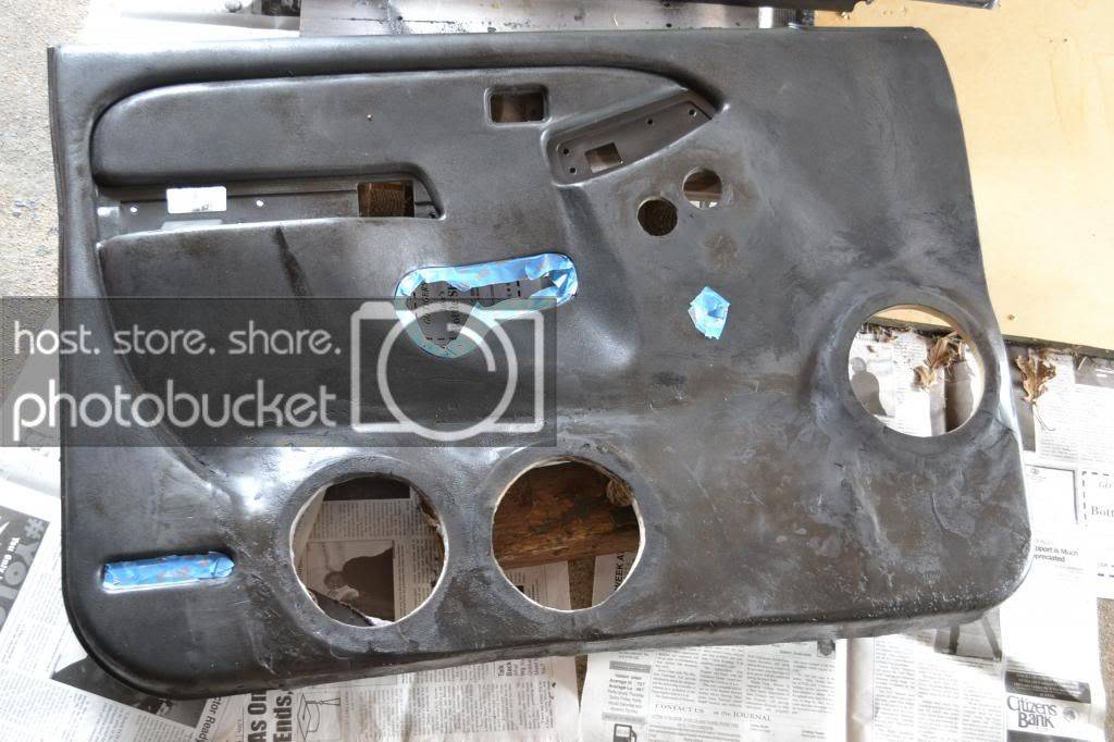

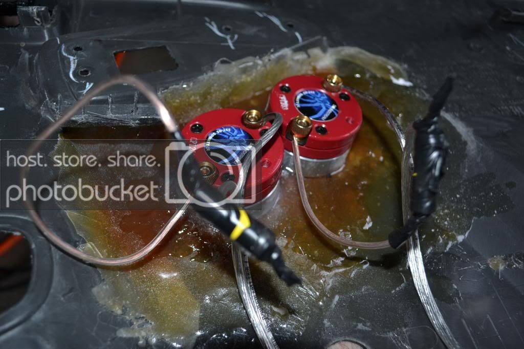

Holes cut, MDF rings glassed in, again 3 layer thick so the tweets had a solid mounting surface, these bitches are heavy guys. Like 4 pounds a piece heavy, that's alot of weight on a plastic door card so I had to reinforce them

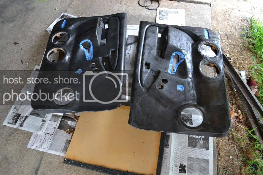

Doors sanded down and all the body work that needed to be done, is done by this point
See now if these were getting painted obviously I'd have alooooott more body work ahead of me but with bed liner you won't be able to see any of these imperfections so I stopped at this point

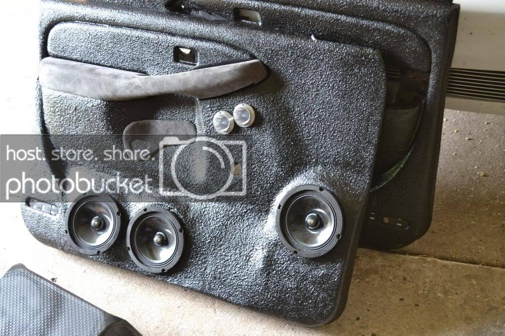

Ready for bedliner

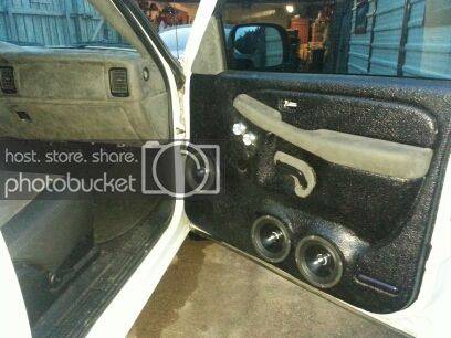

Test fit

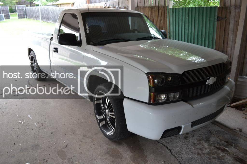

Here's the truck they are going into

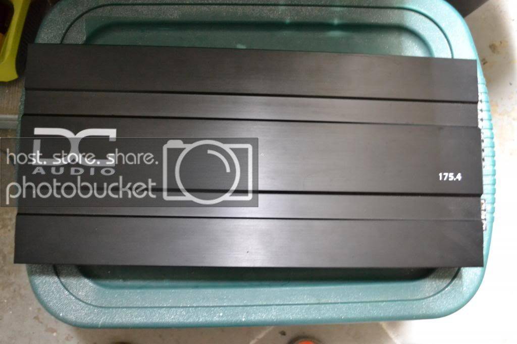

Sexy ass 175.4 for the doors

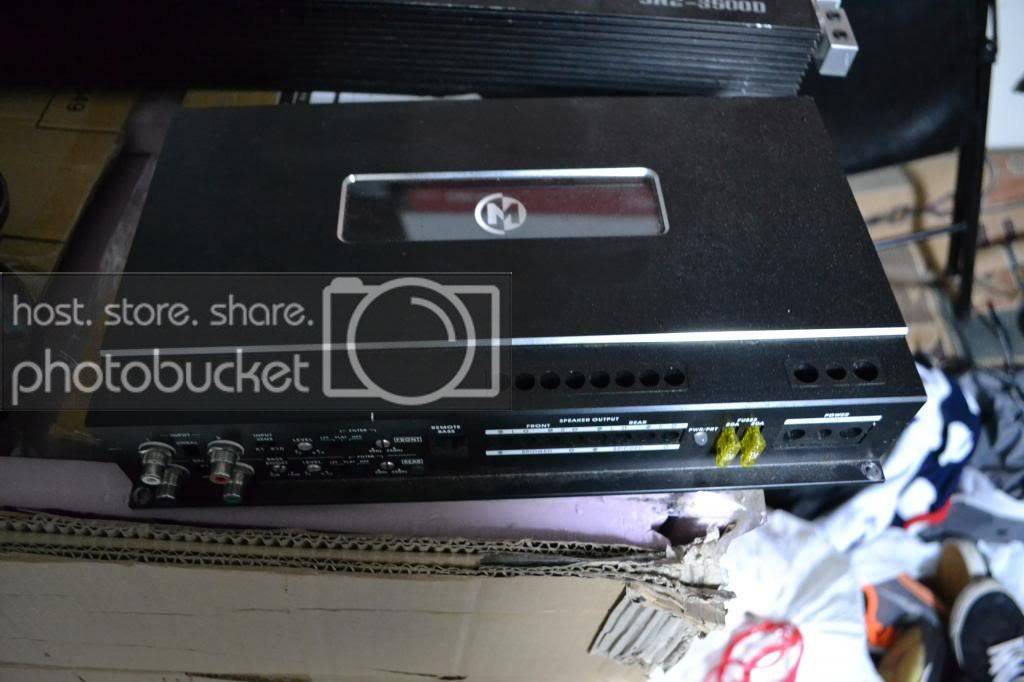

Memphis for the tweets, probably gonna be a sundown 50.4 soon
Wired up

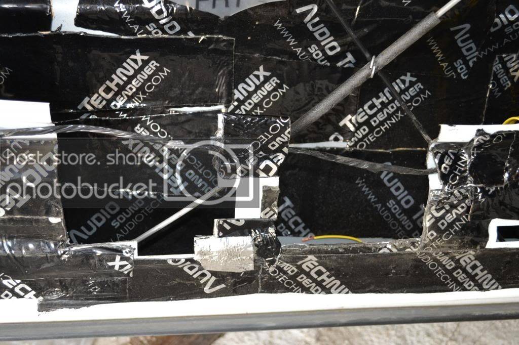

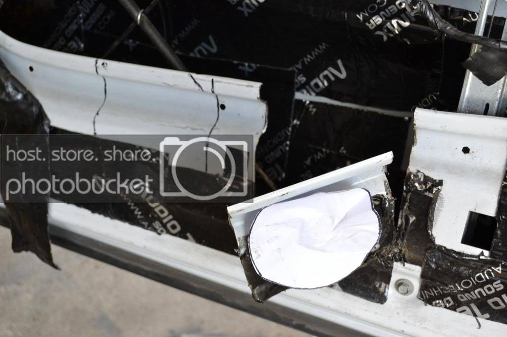

I cut out a piece of paper that matched the magnet, use painters tape to tape the paper to the magnet, gorilla tape that would hit the metal door skin, put the door panel on, and pushed the mid through the mounting hole till it hit the door skin, needed about 1/2 inch of clearance. So I had to use an angle grinder and cut out some of his inner door skin for clearance.
All cut out
Installed and done

**** jeff, these look sweet! Great job bro!
Thanks mayne
Where did you get the bed liner? What kind is it?
Autozone actually, it's called Herculiner, I use it on boxes, people's beds, all kinds of sheit
I've done a piece of MDF in it, dragged it behind my truck for about a mile and it barely scratched it at all, it's only 33 a can too.. Great stuff I highly reccomend it

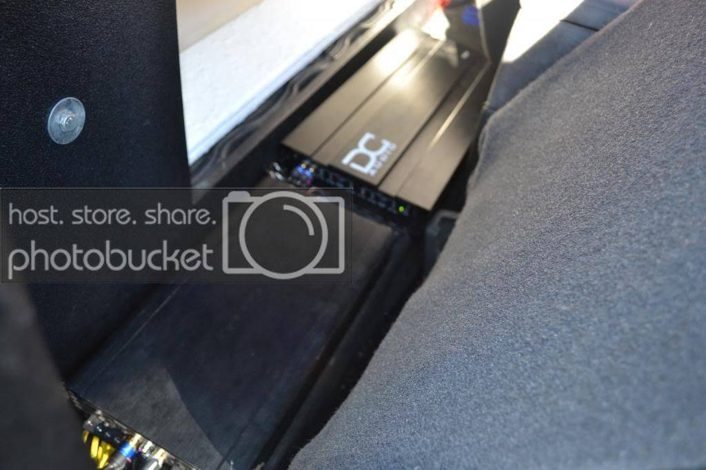

whats he got in the bed?

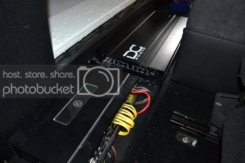

4 DC level 4 15s on a Crossfire 8k, does a mean *** hair trick

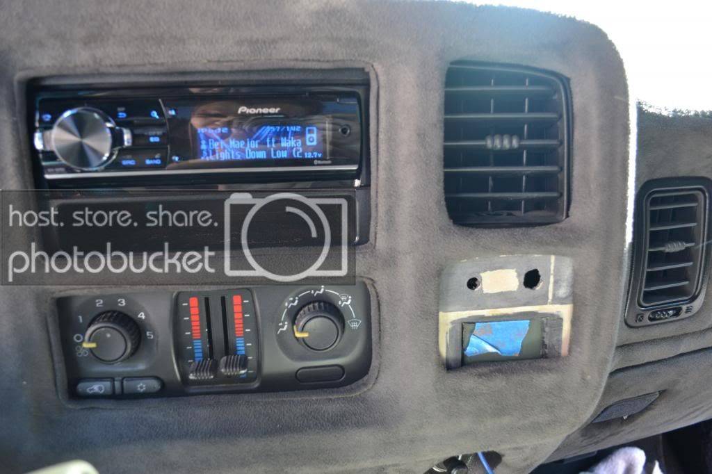

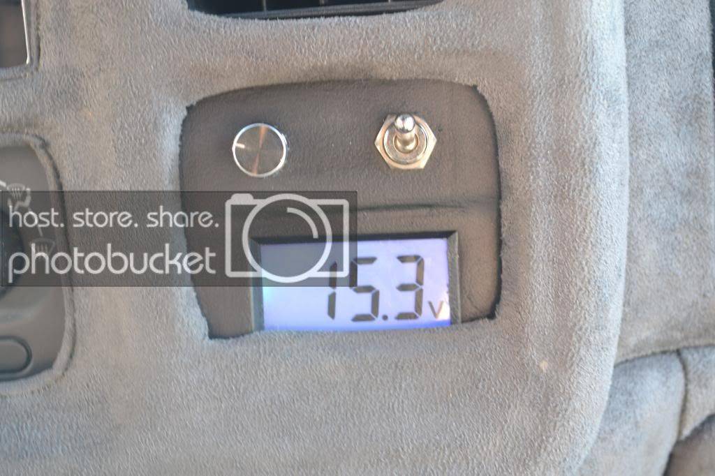

So Cameron decided he wanted to add some additional shit into the truck

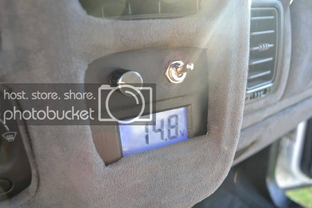

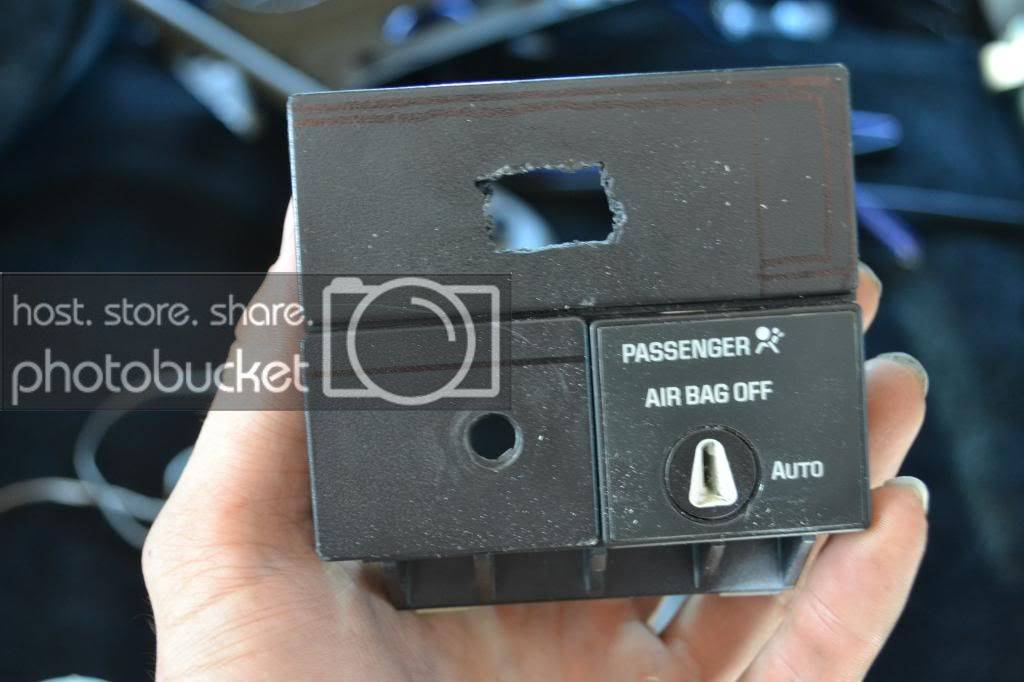

relocated the air bag switch to the glove box

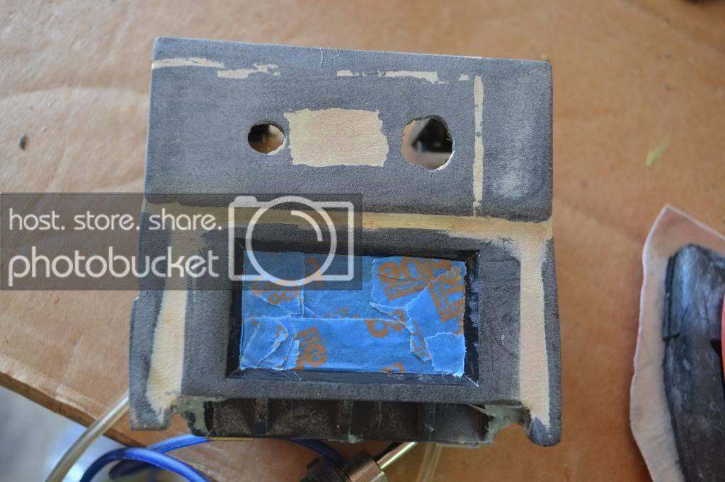

chopped it up, glued and bondo

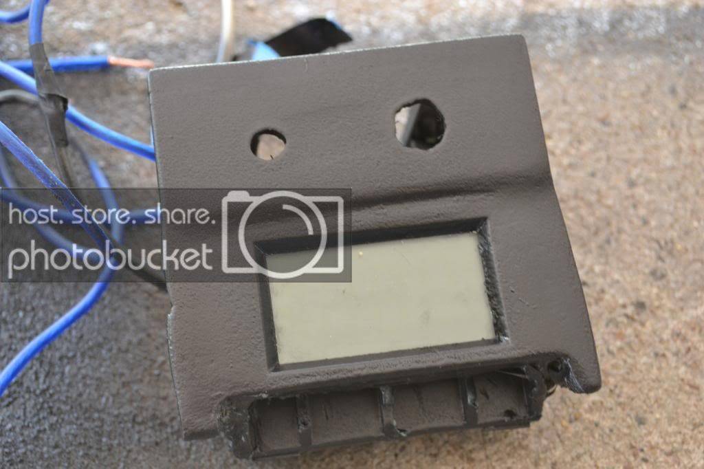

test fit
plasti dipped, he wanted a rough look to it to match the bedliner but i didnt have any at the time, will probably go back and redo it later but for now, this is how it sits

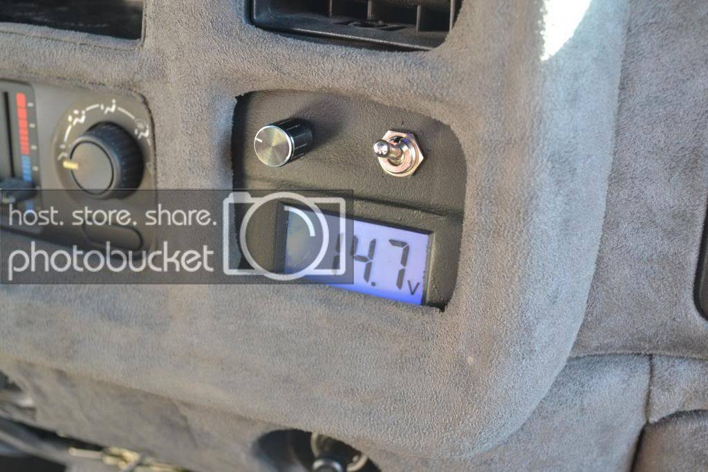

in the truck, switch to turn it off on the right, bass knob on the left
MLA turned up
another angle
