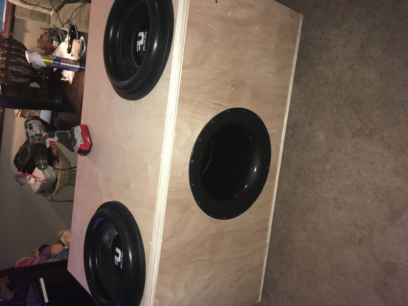

Nope. No word. I'll measure magnet tomorrow. I'd assume bl is a little more but who knows.. @gotgixers has 1250 ts specs after break in. Anyways box almost done. Now to sand stain and gloss.
[quote name='Lbetts818']Nope. No word. I'll measure magnet tomorrow. I'd assume bl is a little more but who knows.. @gotgixers has 1250 ts specs after break in. Anyways box almost done. Now to sand stain and gloss.
[/QUOTE]

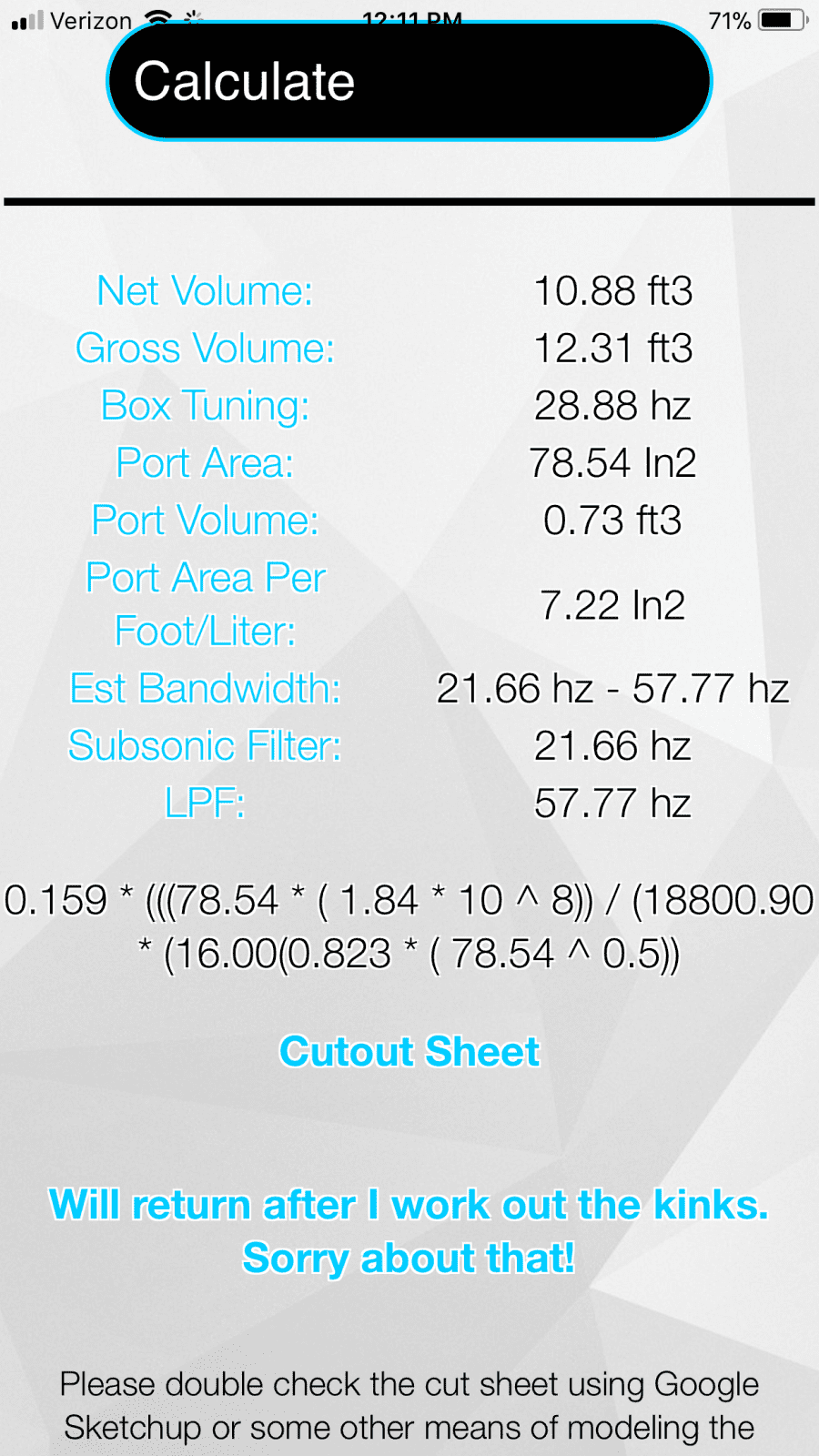

That looks awesome!!! Give us some specs.. volume, port diameter/width, tuning frequency I want all the juicy details ;)
That looks awesome!!! Give us some specs.. volume, port diameter/width, tuning frequency I want all the juicy details //content.invisioncic.com/y282845/emoticons/wink.gif.608e3ea05f1a9f98611af0861652f8fb.gif
---------- Post added at 07:43 PM ---------- Previous post was at 07:43 PM ----------
I know what I like music wise and want to dig into low 20s with authority.
That and the 20hz part of my sub by big krit I wanna play strong. Also mr.mister by bob had a low low part in the middle
The box I'm running now is my first good ported box and I thought 31hz would be low enough but I'm wanting lower! It plays nice down to 26hz tho but I want it ported lower so I'm not on the roll off end of the tune ya know. I don't really care for anything over 45hz I like the low **** that makes everything wobble lol
