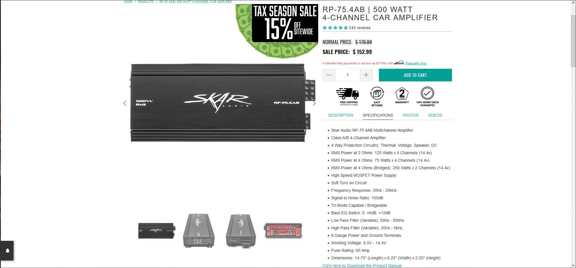

4 channel amp. 4 speakers. Two - 4 ohm speakers together on 1 channel @ 2 ohms. How are they connected (At the amp?) Pics? It may be bridged and you may not be aware... which is ok if you catch it in time.
This amp??

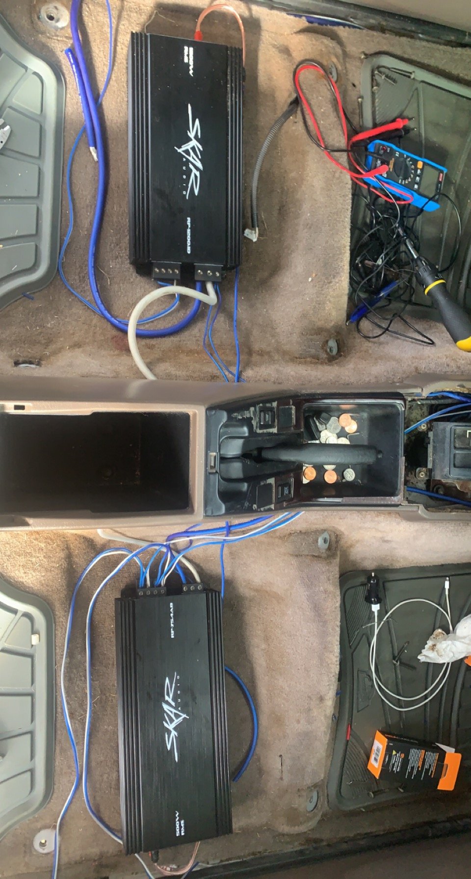

i’m not at my car right now, this is the only pic i have.

Yeah that's not bridged, either gain issue, or I'm leaning towards possible head unit issue. Those super cheap head units can get weird sometimes for sure.

Looks wired correctly. RCA's in channel 1 and 2 and the speaker wires are in channels 1 and 2. Look for cut wires going into the doors as this can happen and short the amp. Make sure no metal is touching the speaker terminals... this too can short the amp. Make sure those speakers say 4 ohms and not 2 ohms... ya neva know.
this could be it too. thank you both i’ll look into this
Update: I got it fixed, I believe what was happening was the connectors to my rear door speakers had came off from either opening or closing the door or the bass, not sure. And they were grounding out putting it in protect mode. Thanks for all the help :)
