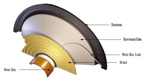

Oh ok. Wanna do me a favor...What exactly is the "suspension" on a sub?
What is the coils? That pole in the middle of the sub?
I don't even get how the current from the tinsel leads...traveling to wherever they go...make the speaker play.
Suspension - referring to the surround and spider.
A passive radiator is basically the woofer without a magnet or voice coil.
Suspension - referring to the surround and spider.A passive radiator is basically the woofer without a magnet or voice coil.
OH...that's what the spider is. That yellow/orange ripple looking stuff. What exactly does the spider and voice coil do?
Voicecoil is what is energized by the amp creating a magnetic field which pushes/pulls the cone assembly through the motor's magnetic field (the large magnet on the bottom). The spider is what actually supports the cone and keeps it from tearing apart.
And now I know. Thank you!
