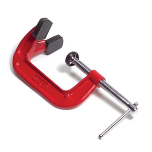

You could try something like this.
Put the double head on the top of the amp with the mounting hole in the middle and use a nail, screw, or small rod to push out the screws as you tighten the clamp. It should work like a ball joint press, but it will be a bit awkward getting the clamp and nail/screw/rod lined up.
