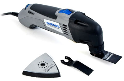

I didn't read all the posts, but what about a Dremel Multi-max with a metal blade and cutting the screw from the bottom of the amp then just pull the head off?
In case you've never seen one...
