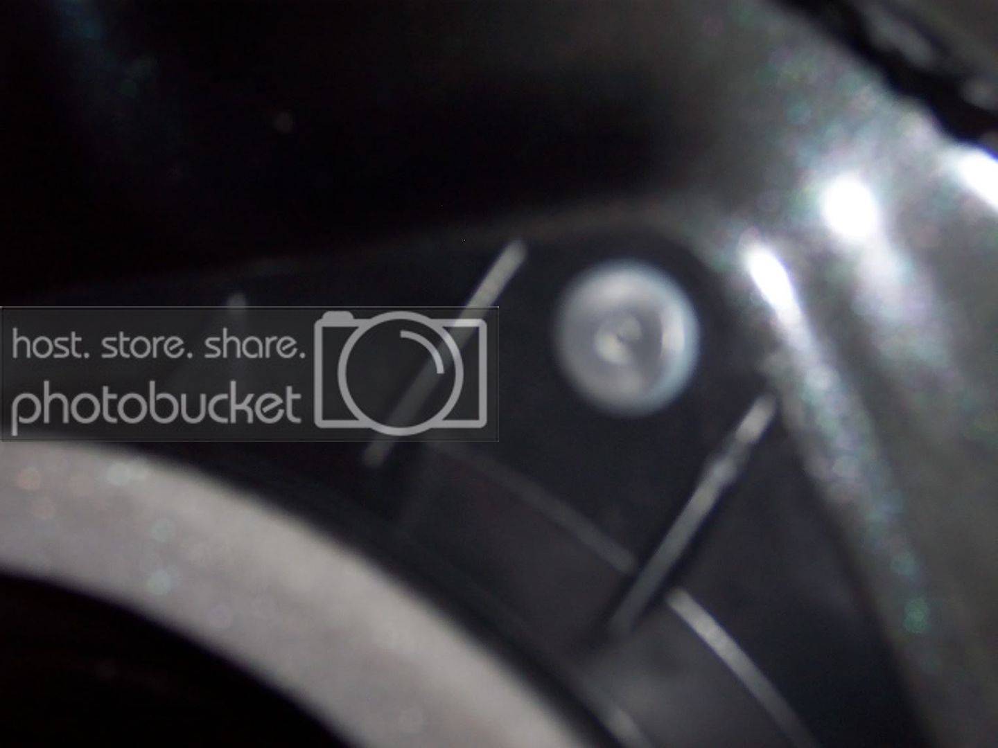

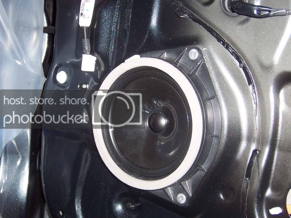

anyway we're at the point of taking the doors apart in more detail, but i have no idea how to take out my speakers.. there's some weird screws on them
pic of speaker in door:
close up of the screw things..... sorry its excessively blurry, might be better off just looking at the first picture
If anyone has a good solution on how to take these out it would be great... thanks
Those are not screws. They are rivets. My XB has the exact same setup. What you need to do is to drill the centers out with a small drill bit. The baffle and speaker is one piece and will not separate. You will need to make a new baffle. Trace the speaker onto a piece of mdf, cut it out and drill your holes in the exact location. You will need to cut the center out according to your driver size. Mount the new baffle to the door using new nuts, washers and bolts. I also used non hardening modeling clay between the door and the baffle, this made a much nicer baffle and also helped with the window clearance... do not tighten baffle completely as this will just squish the clay out.

thanks so much for the tips, although a similar tutorial is in the Proper door deadening thread, your step by step should help me considerably =)
