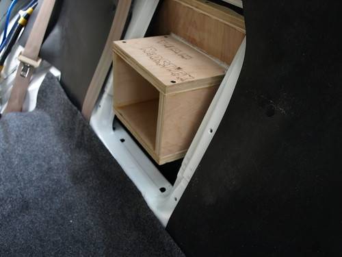

Also, I dont want a giant port sticking through my ski hole blowing air all over me and my passengers like an air cannon (see pic //content.invisioncic.com/y282845/emoticons/smile.gif.1ebc41e1811405b213edfc4622c41e27.gif ) - is this an issue or is the air dispersed quickly, feeling more like cabin pressure?

you will end up in the 4 cubic feet gross-ish side of enclosure with a 4th order. What a 4th order blowthrough does is bypassing the trunk and getting all the sound into the cabin properly. Generally gets you waaaay louder. Its more like cabin pressure unless you stick your face right at the ski hole. You can go down to an Xcon 10 in a proper 4th order and it should still get louder than ported if you have a thick dense trunk where its hard to get the sound into the cabin.

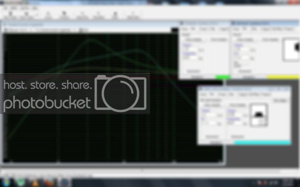

Here is a model that someone did trying to get the flat response of a sealed box but louder; not the traditional 4th order with a large ported section looking to be louder as certain frequencies. I thought it was interesting.
