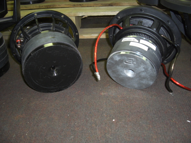

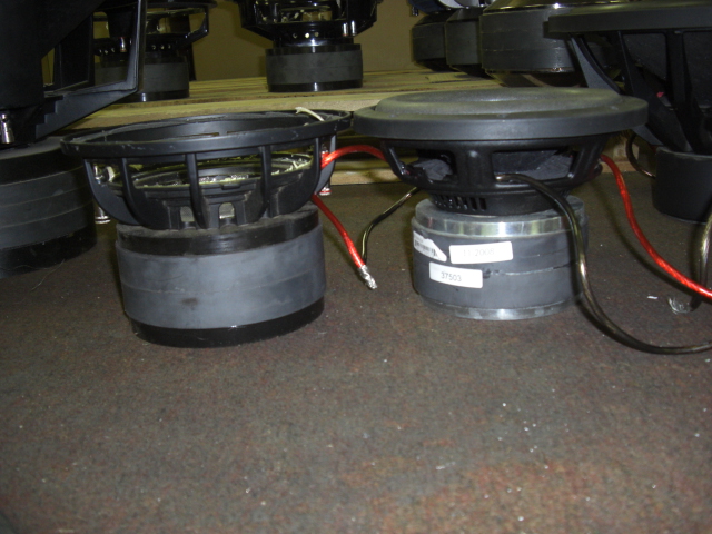

I bought two DD 1508 to compare T/S specs to... the DD 1508 is WELL broken in as it is used.
Sundown SA-8 (D2) / DD 1508 (D4) :

For comparison shoppers this will give you an idea of what works best for you -- I couldn't find the T/S anywhere else for the 1508s so I got some //content.invisioncic.com/y282845/emoticons/smile.gif.1ebc41e1811405b213edfc4622c41e27.gif
Had ALOT of people asking me how they compare to the 1508. If the cut-out of the 1508 works in my box I may try them in there as well.
yea do a swap would love to see #'s compared!!!
I am not quite sure if my current box will work as we actually got the hole a little too big for the SA-8 and the DD is even smaller.
Derrick is going to help me with a second box with a tighter cut-out this time and the DD may seal up with tape in that one. But I don't want to break them *laughs* since I plan to re-sell them when I'm done playing.
I am re-building the SA-8 right now so I don't have a side by side cone shot //content.invisioncic.com/y282845/emoticons/smile.gif.1ebc41e1811405b213edfc4622c41e27.gif
