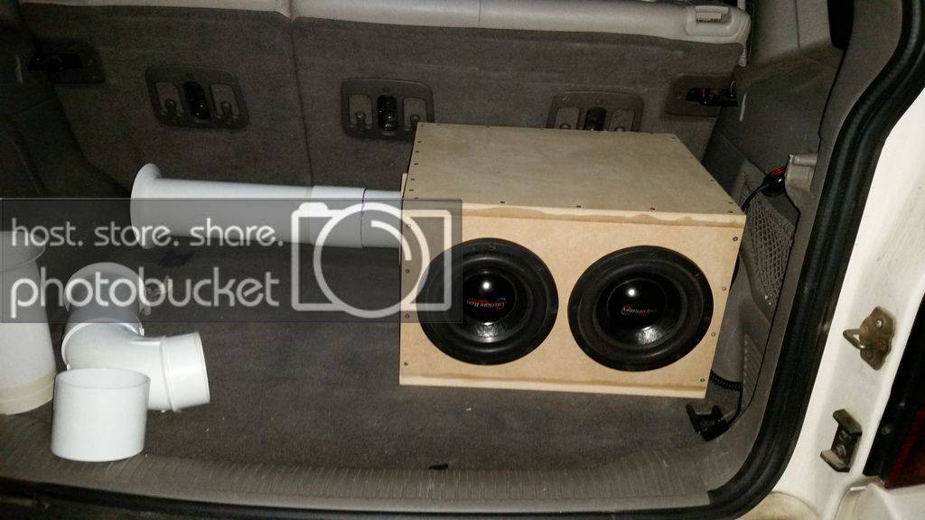

here is a picture of my Ranger box in my Liberty. I wanted to see what it would look like. It dosnt' sound good in my Liberty at all. thats why I want a new box. Sounds great in the Ranger, but not in the Liberty. The port is facing up in the picture. YOu just can't really see the picture very good.

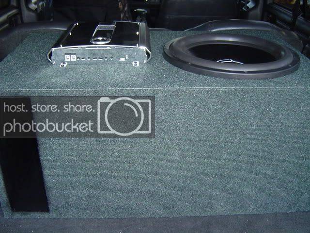

Here is a picture of a box that I am wondering if that box would be good?

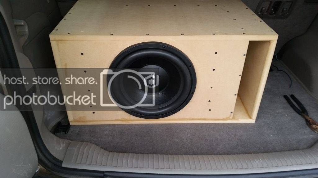

This is not the rite size etc, just showing the port and sub etc.. Thanks for any info.
Thanks for the info. Does anyone suggest I use sa-12's recommended ported box stats "1.5-2.0 ft^3 @ 35hz" .
Maybe I should use 32 hz? I will be using it for music, but just want to get a little bit more spl if I can get a little. Amp is going 900 watts @2ohm .Thanks again everyone.

I've tried every way imaginable in my liberty and it's really depends on cone area, power, and distance from the rear door.

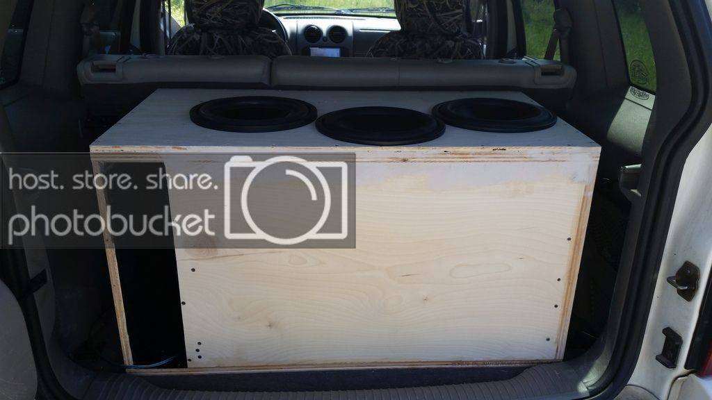

Sub up/port up plays deeper, also gets louder with the windows down but you don't feel the bass. Sub rear/port rear lets you feel the bass and gives better numbers on the meter for smaller setups. I've tried sub up/port rear, but the only time I liked the outcome was when I was running 3 Diamond Audio 10's. The box was 4.5cuft net and

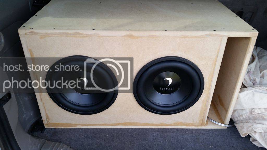

pretty **** close to the rear door. I couldn't fit the subs and port on the same panel, so I didn't have much of a choice. I'd do around 1.7-1.8@32-33hz with 17-18^2" per cube, port rear/sub rear. I've played with boxes for a guy running a single sa12 in his liberty, and it turned out extremely good. Here's the box specs, but I can send you the cutsheet and sketup design if you want it.
Sub/port rear,Double baffle 1.75cuft@32hz 18.63^2" port
16h x 23.5w x 17d
Port- 14.5h x 2.25w x 43L
