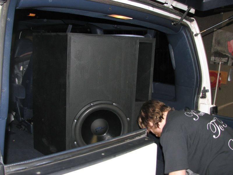

KHA does an SPL build - 1996 Astro Van
The van was slightly louder than the Silverado, on half as much power. Combination of the box and placement.

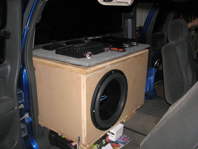

This went in a Silverado but I wasn't happy with the result due to loading - port should have been against the side wall.

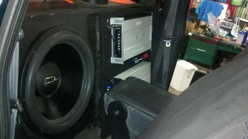

A buddy put this in his Dakota, the silverado was louder and more musical

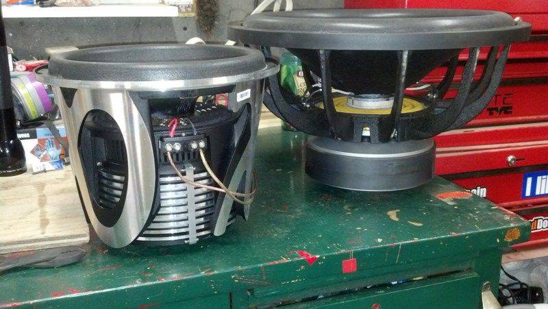

Go as big as you can for maximum efficiency. It can take 4kW RMS but it wasn't strong enough to overcome cabin pressure. We swapped an Alphasonic 12 for the 18 (same amps, same box) and the 12 was nearly as loud.
