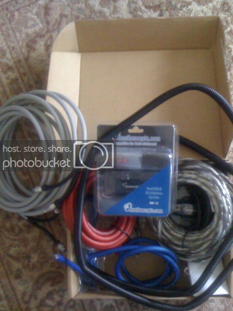

Knu amp kit Kolossus Flex 4 Gauge
RCAs: Monster cable MPC I402 SW-6M 2-Channel Xtreme Subwoofer Cable
Monster cable MPC I302 2C-6M

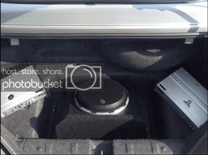

In this picture I just placed everything inside..
I'm in the process of making the amp racks. The 500/1 is going to go above the gas tank and 300/2 is going to be mounted vertically with the heat sinks pointing up.

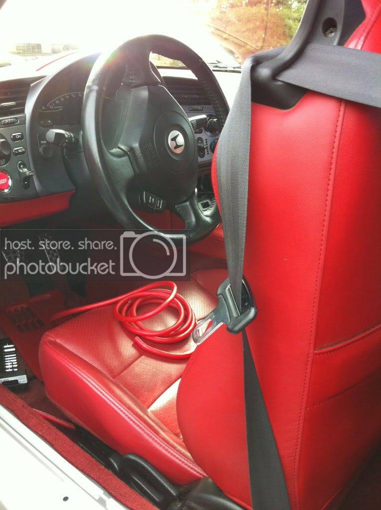

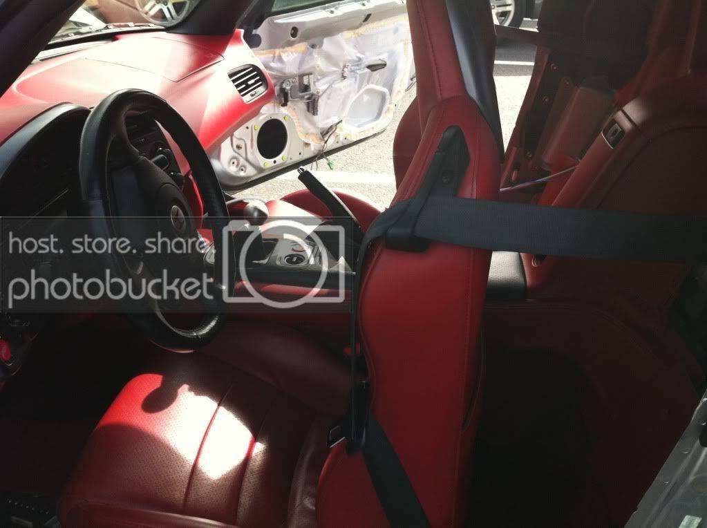

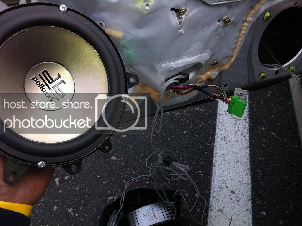

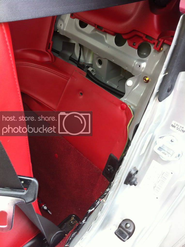

I started the install today. I ran new speaker wire in both doors into the xovers. I ran the power cable along the drivers side into the trunk. I still need to use the d-block and power up both amps. I ran the rcas, remote turn on, speaker wire along the passenger side in the trunk. I'm going to finished up tomorrow. Here are a couple of pics.
I'll add more pics tomorrow.

Update.
I just finished wiring up everything. Couldn't turn the volume up that much because it's midnight and the neighbors would kill me. Amps still need to get tuned... I think I might buy a voltmeter for that. I still need to put all the panels back on and clean up the wiring and make it look nice.
