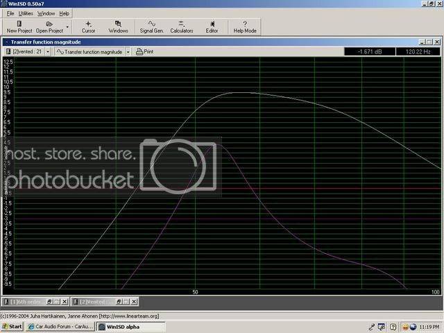

Id just give up on it and go back to ported. Sure you might get it right eventually, but unless you are planning on competing big time, its not worth the time IMO. Believe me I tried it, and this is how the box ended up...
Whenever I used WinISD and modeled it out, I got that a simple ported box would peak higher.
The white graph is ported box: 10 cu. ft. tuned to 52
The colored line is the bandpass box.
Yeah, I'm going to try cutting the port for the rear chamber down, and if that doesn't work I'll just go back to ported...
Hm, I was using normal winISD, the beta version, and I was able to get a huge peak doing the bandpass design...I'll probably just go back to ported and use the 6 4" aeroports I just ordered.
