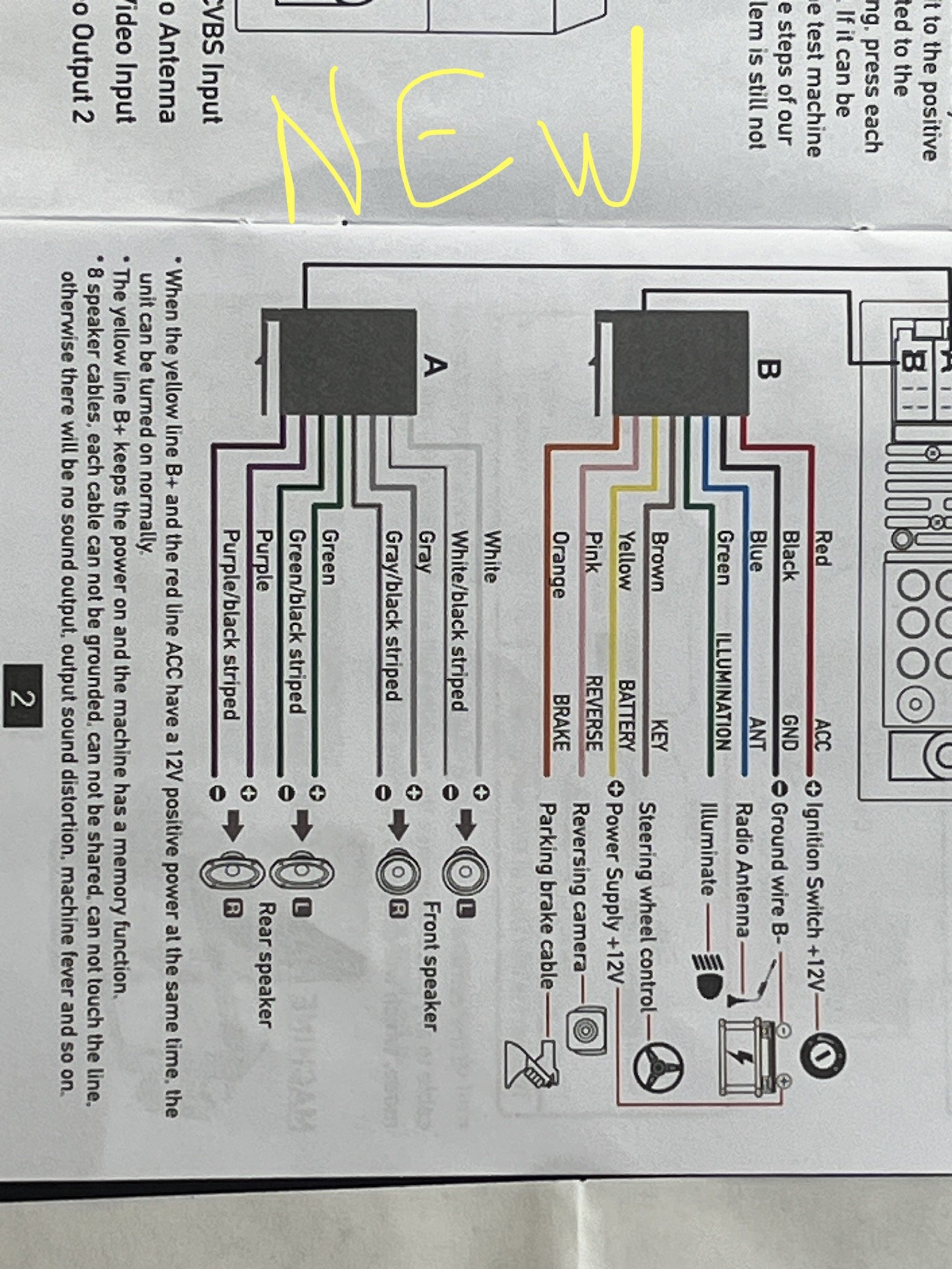

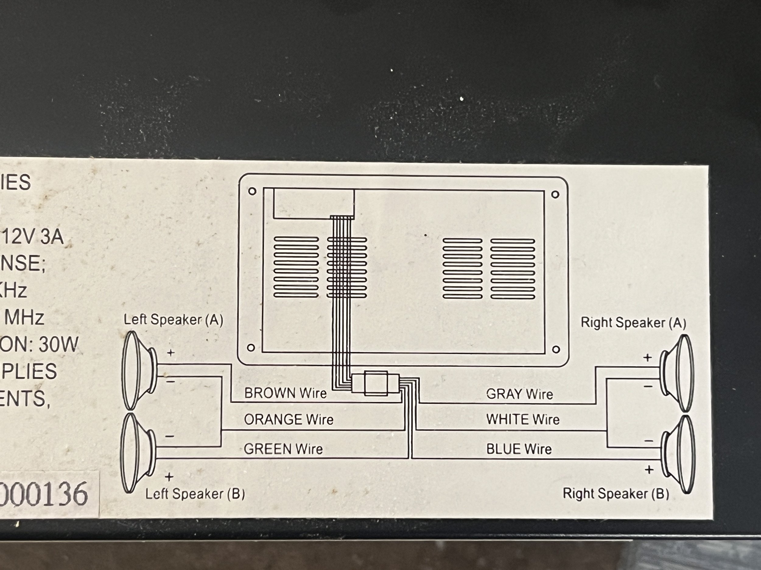

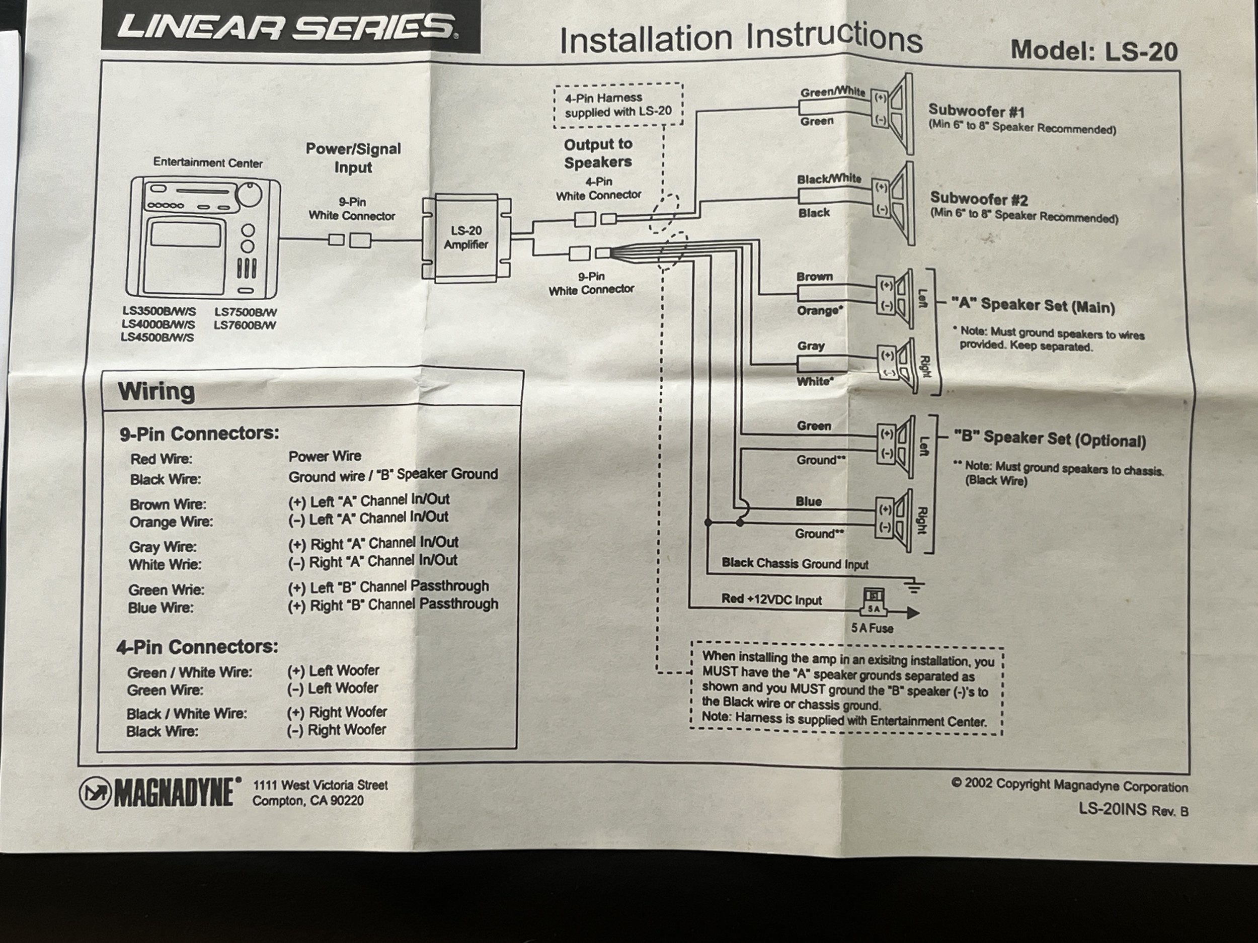

So I wanted to upgrade my old RV head unit. It’s an ancient Linear series. I bought just a cheap regular android radio off Amazon. Following the diagrams on old and new, I have power and functional headunit, but no sound at speakers. Amp keeps cutting off power. I also tried to bypass using the amp, and connect only non amplified speakers etc…. No luck any way I’m trying.
Is there a special way to make this linear series setup work with a regular car stereo headunit?
