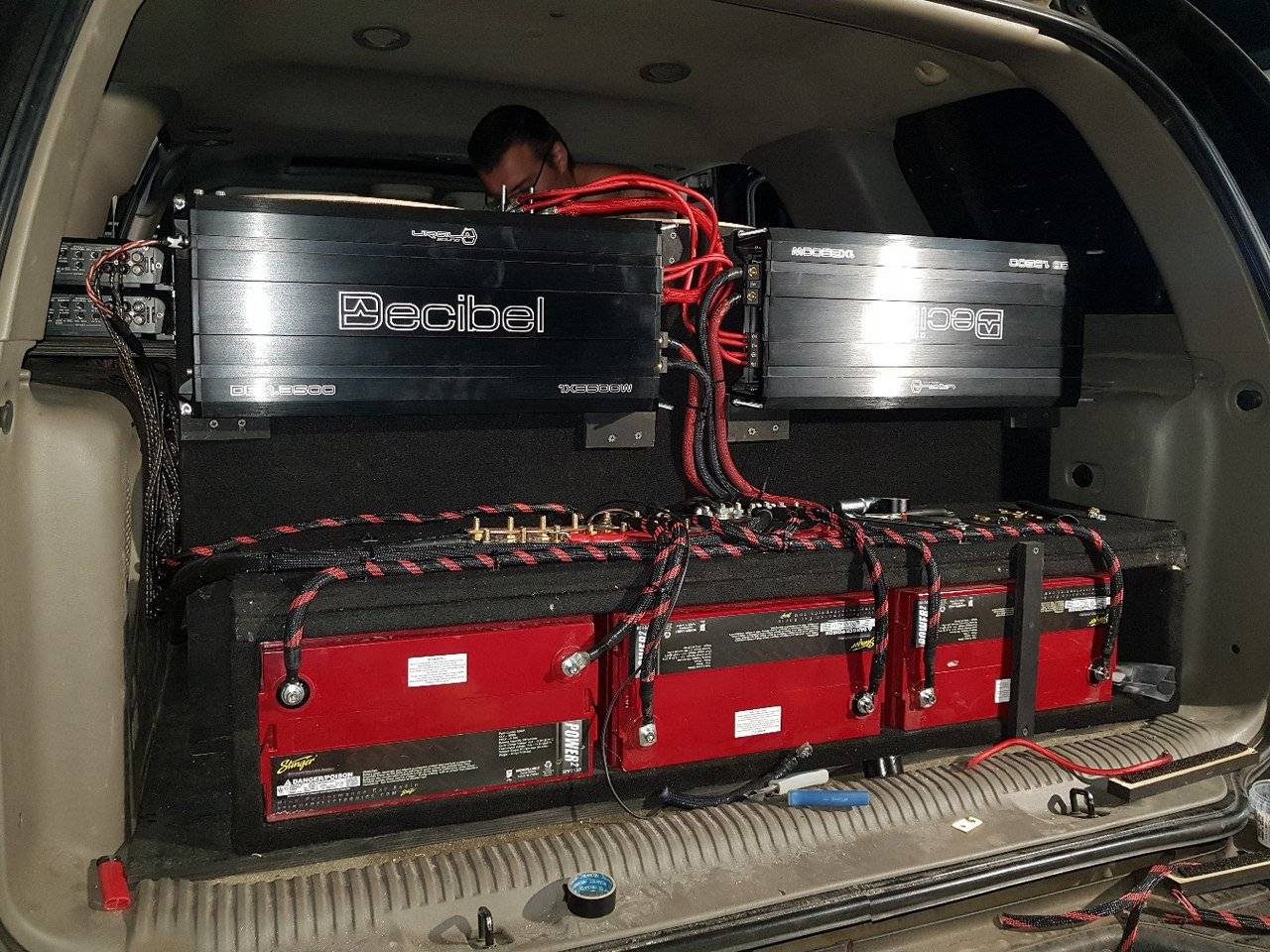

Sound System - Alpine INA W-910R + Alpine PXA H700
Subwoofers - Ural Ultimatum 18" 4 pieces
Amplifiers - Ural Decibel DB 1.3500 - 8 pieces + Ural Decibel DB 6.180 - 3 pieces
Front - Ural PT200NEO. Neodymium speakers
Power cable - 00GA
Alternators - Triple WPS253A

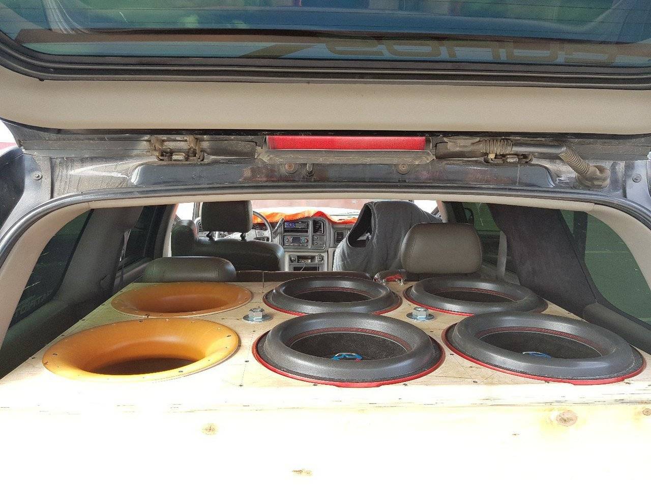

Assuming your amps are true 3000W your numbers are low for the power and cone area you use. Is your box tuned very low? Is it big enough for 4 18s? Would 15s be better in your airspace? Similar builds in my area that win in northeast region are 155 and up.

These results were obtained with 4x15" subwoofers. Counterparts subwoofers Sundown Audio SA series.
It is the result not 4h18" subwoofers. These subwoofers only planned to put.

Yes. I can see from your pictures now. Do those larger woofers with the tall frame use "standard" sized parts (spiders cones coils)? I recommend people to avoid buying woofers which use proprietary parts. If you plan to get loud, you will break woofers and if you chose something with common size parts it will be cheaper/easier for you to rebuild them when you need.
