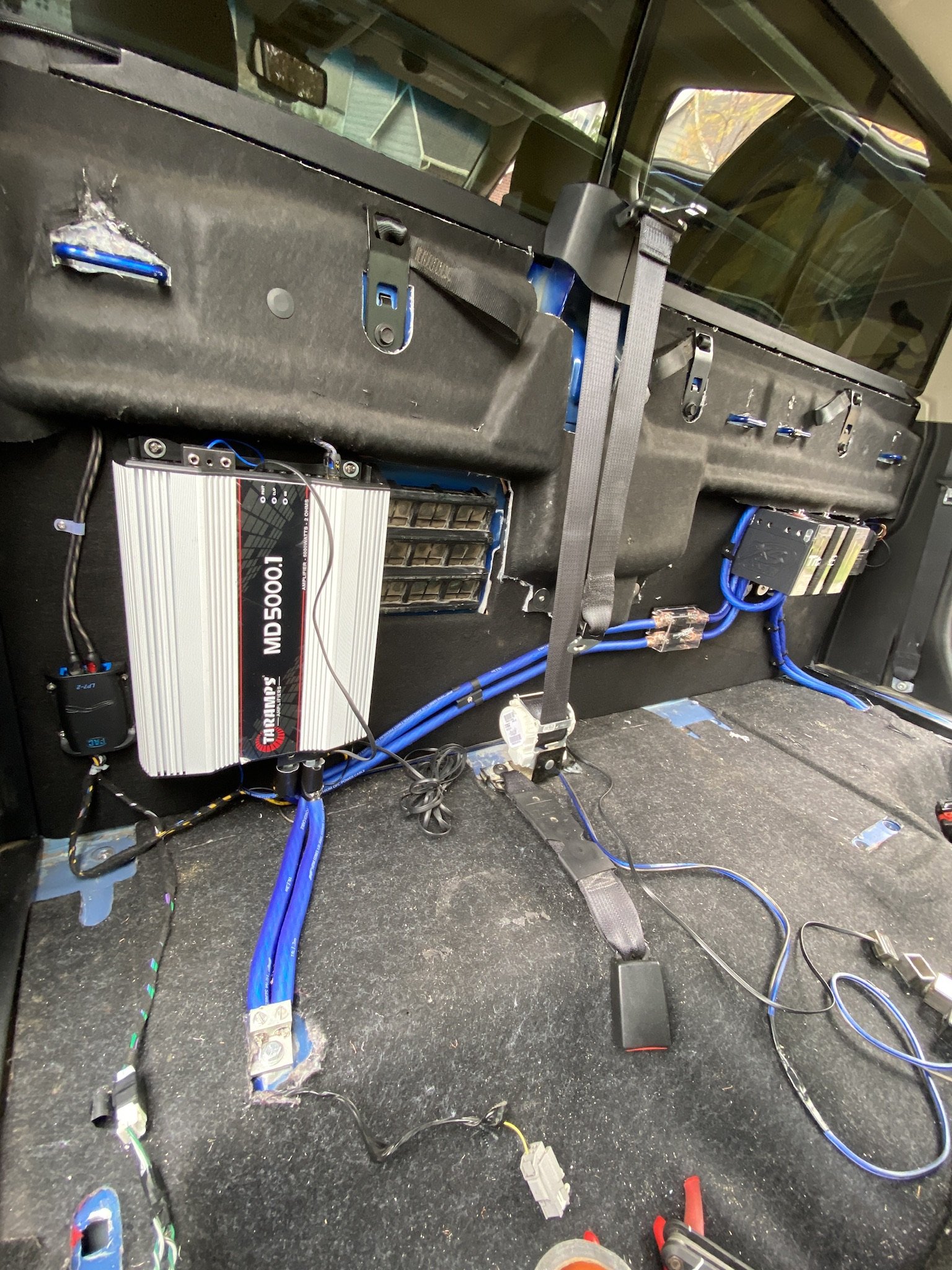

The wiring got cleaned up of course, but here’s how my lithium with dual runs to the md5k (which ain’t there anymore) but you get the idea!
