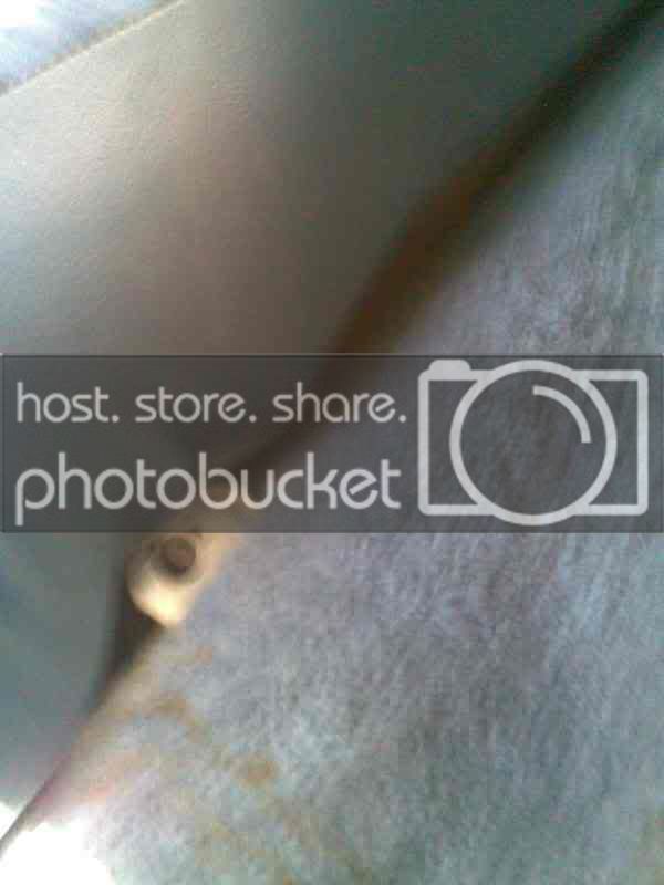

thank you. thats all im asking is a little advice from somone whos willing to pass it on to sombody who really wants to get good at this... and btw im pretty abso****inlutely sure my rear seats dont go down lol...
look in the trunk to see if you can find a way to get a wire from the trunk to the cab. Then do vice versa.

Pull up on the front of your back seat (the part you sit on) pretty hard. It should pop off with just a little elbow grease.
so there are like 2 bolts right under the cushin just unscrew these right? and sorry for the pics i want to make it easy to show you guys..
NO need to drop the glove box. Just run the RCA's under the carpet over to the channel down the doors. Carpet should end up under the dash and be easy to access. You'll probably have to take off the kick panel by the door and then the channels/rocker covers by the door(s).
As for the rear seat, you can probably just fish your hand/the wires under the bottom of the seat on the side to get to the trunk.
Don't try to make it so hard on yourself, and kudos for attempting your first install...
strass. i just ran rca's starting from the trunk up to right under the bottom right like where your feet go. im having trouble getting it up into the compartment to where the hu goes can you explain this step please
sounds like you go the trunk rear seat figured out. as far as getting them to the cd player, you just gotta look for an opening and fish them threw there. it will be a trial and error thing, i havent wires in that car put many a cd players in there.
You might not need to take off the glove box. It probably wouldn't hurt though and will give you easier access. Remove the side skirts and and pull up the end of the carpet. You'll also need to remove the bench seat and the seat back if it doesn't fold down. Also, if it's in your way, you can easily pull up that black rubber seal. It's not glued down or anything (or shouldn't be)
