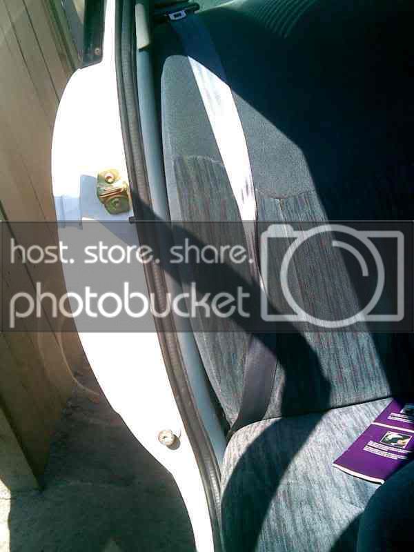

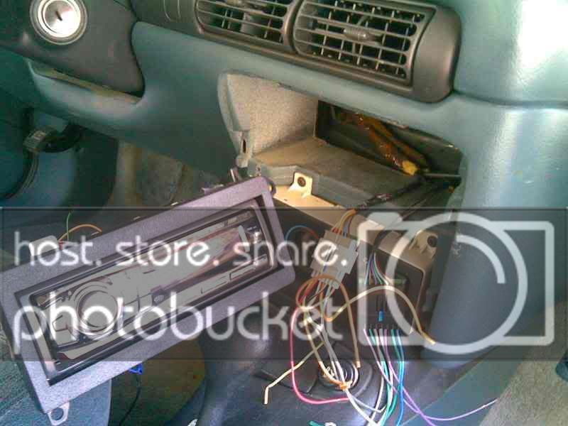

i need to kno if wat im doing is right and question about last step.

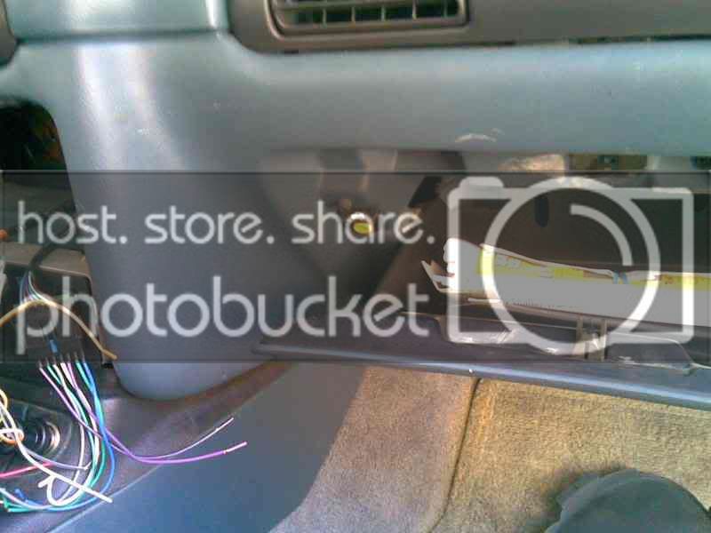

starting here
how do i get rcas through here and around to the bottom? take out the glove box?

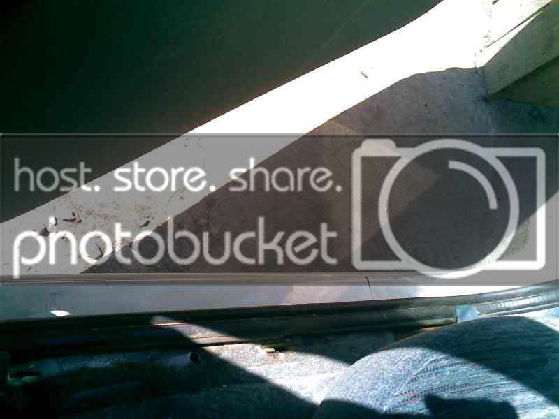

then i run them thru the bottom panel right?

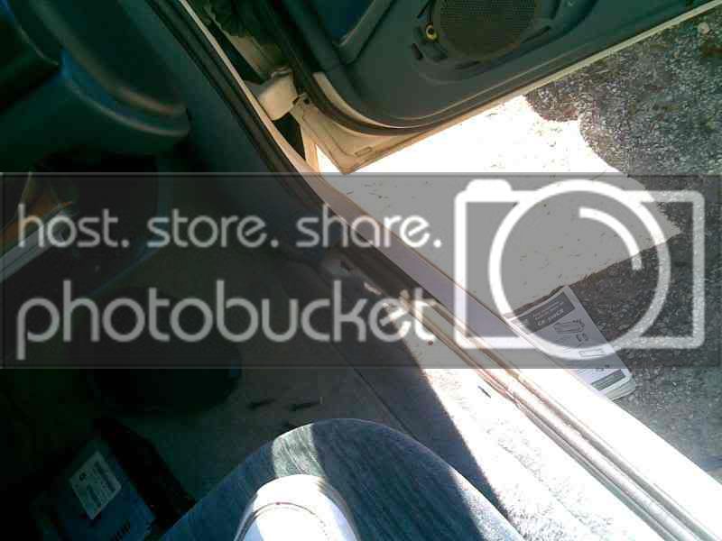

further
now my question what do i have to do to get them to the trunk? because it seems this big plastic thingy is in ma way!
thx guys
and i should run it like that right? and the pos 4gauge wire to the back kinda the same way but on the other side of da car since they shouldnt be next to speaker wires.

OK. Yes, drop your glovebox. There are probably some plastic tabs that hold it up near the rear. If your pinch the back of your glovebox together it should just fall right down. Then run your RCA's down that little track you have indicated. If you can't make it into the trunk, I would look for some manufacturer's wiring and follow that path to the truck.
