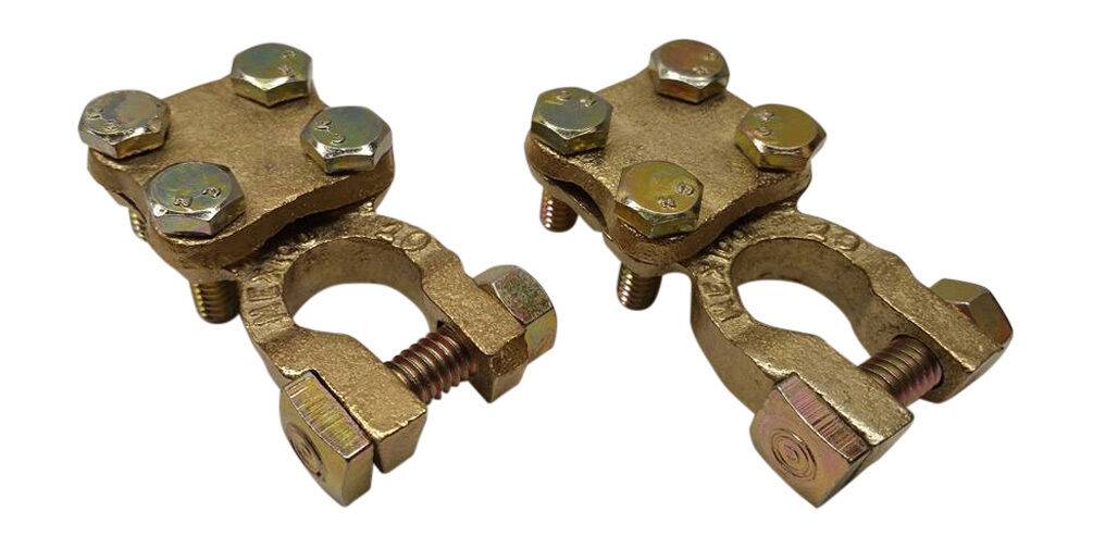

what do you think about these brass "heavy duty" terminals?
I think I'm gonna go with these rather than the stinger type
I have regular silver rings but they're sold as copper, I don't think they would just coat them. Probably some type of alloy

those terminals are nice but they cost too. the ones I posted are $15 a pair.

I do not recommend those brass terminals. I will always use a crimped on lug and heat shrink. Those open terminals leave the wire exsposed and will have corrosion and poor connectivity over time not worth the hassle get the terminal with the post to attach lugs.
I'm confused. are you talking about the set screw ones that stinger makes or the ones I posted a picture of? Heatshrink is a must and you can always spray some **** over the lug so the connection stays clean under there.
I don't like the ones you posted cuz they don't have as big of an area to mount your lugs onto as the truck one I posted. I read it's not really good to mount ring on top of ring on top of ring and it seems that's the only way to get cables mounted onto that xs terminal.(btw those are generic terminals). I've actually looked at those before but I just love that big mounting plate with 4 screws. I'll think of something to protect the wires!
The ones you posted are a clamp. You strip the wire bare loosen the four bolts and clamp the wire between it. This leaves the wire exsposed. If you use lugs on the wire and each bolt as a separate wire contact that will be fine. I just dont like using the clamp.
