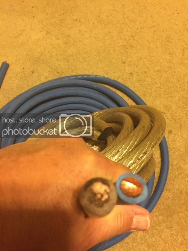

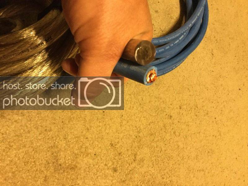

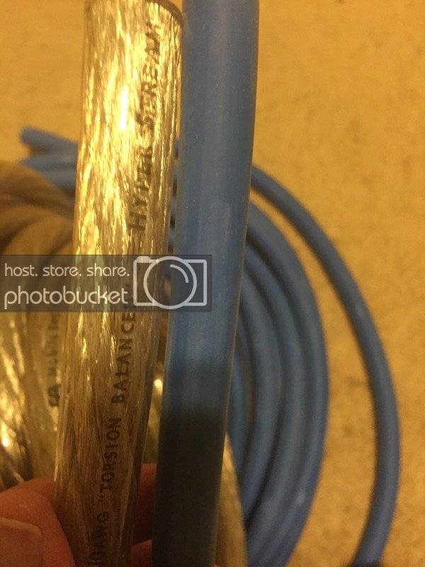

I just got in 25 Ft of the Blue Royal Excelene 1/0 gauge and it looks thin compared to the clear jacketed Marine grade tinned copper 1/0 I also just got from another source.
Am I crazy and the thick jacket on the clear stuff throwing me off?
Or is the Excelene just fine

It's definitely the jacket. The marine stuff actually looks a bit smaller to me because it's got that asterisk/snowflake shape to the bundle.
Measure it with a ruler or place a coin on it to compare. The excelene is good stuff, I use it myself.
