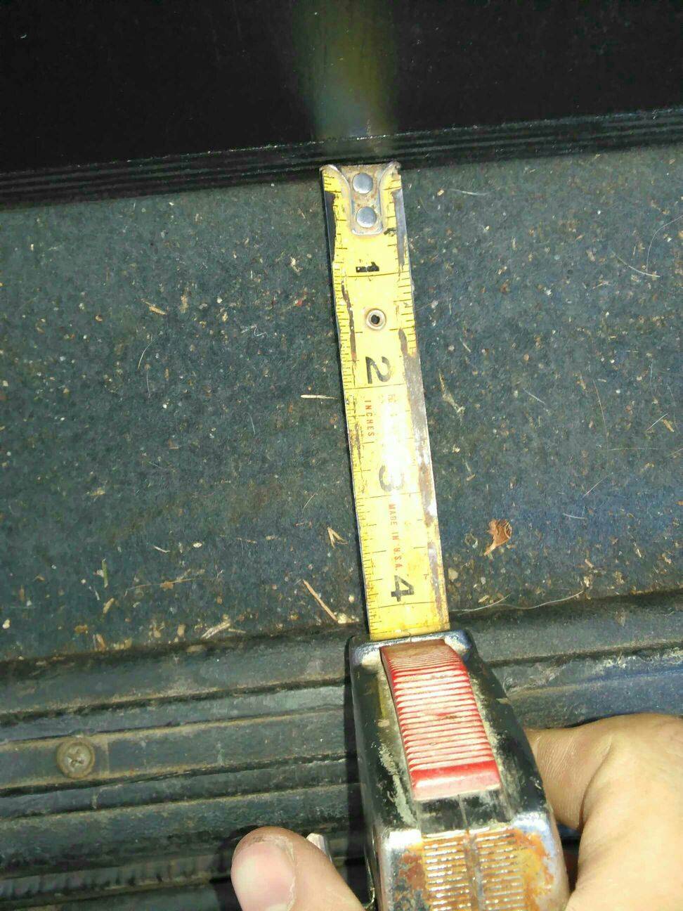

These things are only 3" deep? So they'd fit right here?
Sent from my Z812 using Tapatalk
Interesting. I'm pressed for space and have been considering a Northstar becaues of the narrow case. I'll look more into these. It would be great to be able to notch out the back bottom of the enclosure to fit these and access them by lowering the rear seat rather than build the box 6 inches narrow and fitting an agm to the left or right of the box. Think 4 of em with an XS under the hood and a 250ish amp alt would be strong for 3-5k?
