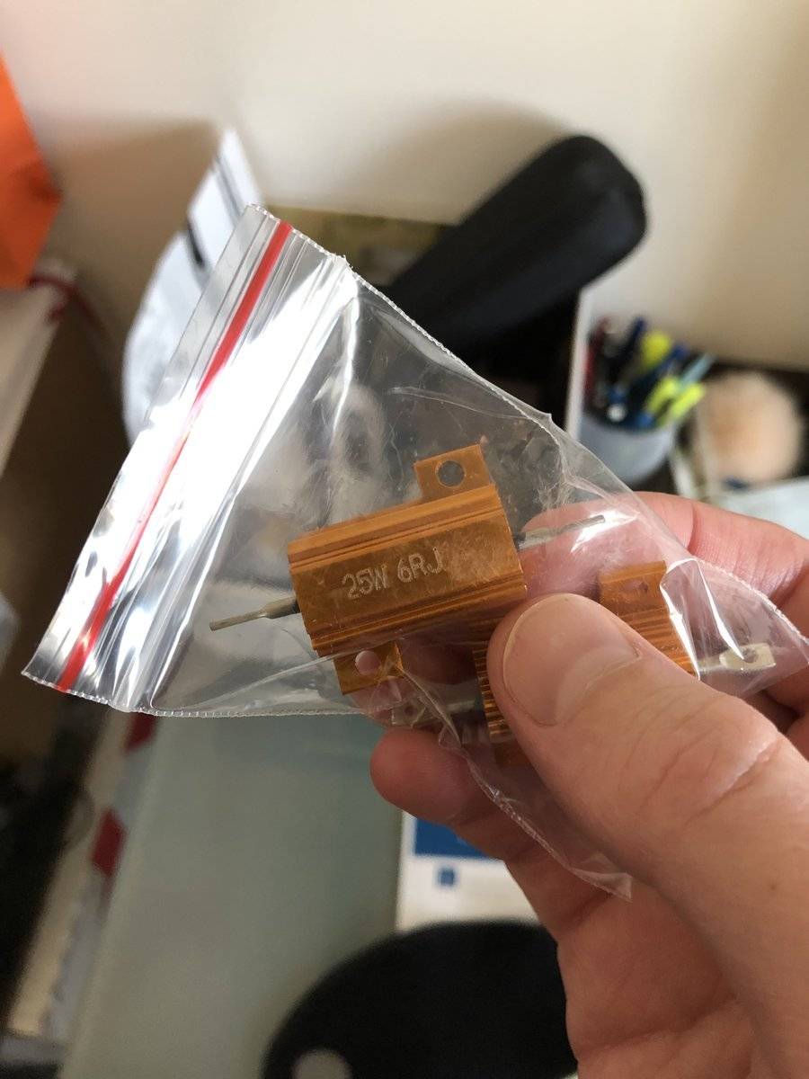

Thanks so much for the advice.  I have a wire wound resistor with aluminum casing (pictured below).  Pardon my ignorance as I’m a beginner:  How would I “secure” this resistor?  Do I wrap aluminum foil tape around the resistor itself?  What is the best way/location to mount the resister?  Thanks again!
Looks to me like that has mounting holes to screw it down to something.  I think KHA might have been thinking of the style that looks like a block of cement.  I think you should just leave some space around that heatsink on the resistor wherever you mount it.
If screws are impractical you could probably use some small zip ties through those holes to keep it secure somewhere.  Hard telling what's best without seeing where you plan to cut the wire to your speaker.
Agreed. you may want to have enough wire soldered to mount the resistor in an easier location.  I agree you can just screw or zip tie the resistor in place.  just be sure to insulate the connections to prevent short circuits.
