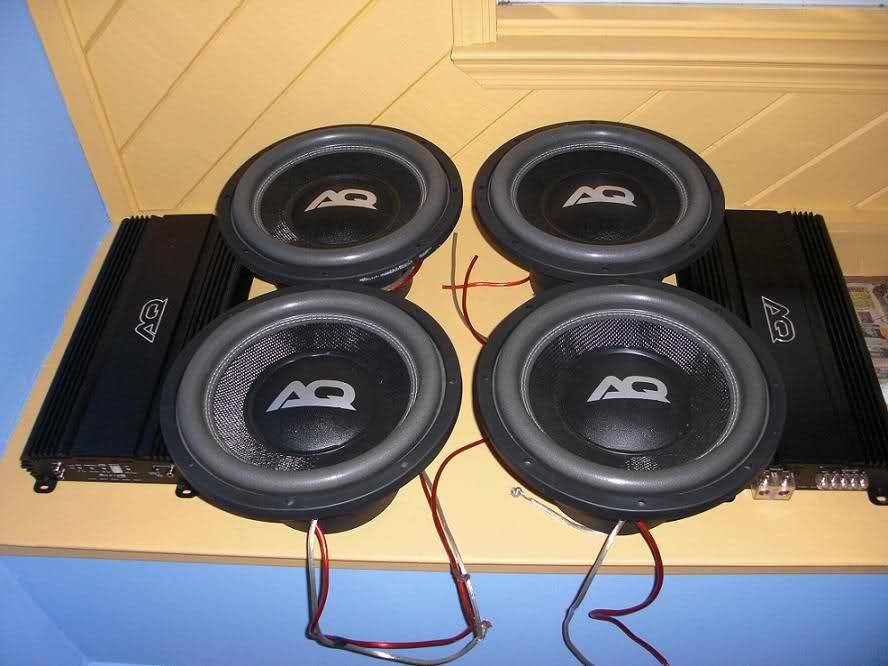

Reppin the AQ: (4) 12 inch SDC 2.5's, (2) AQ2200's,

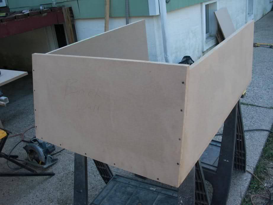

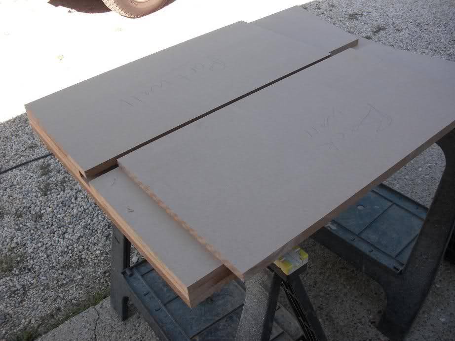

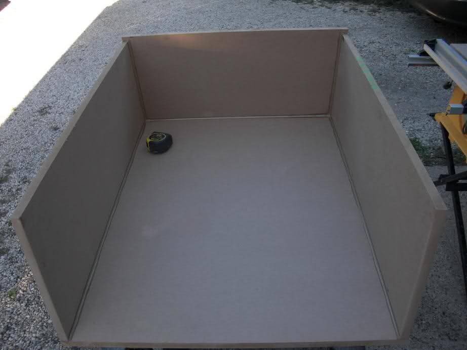

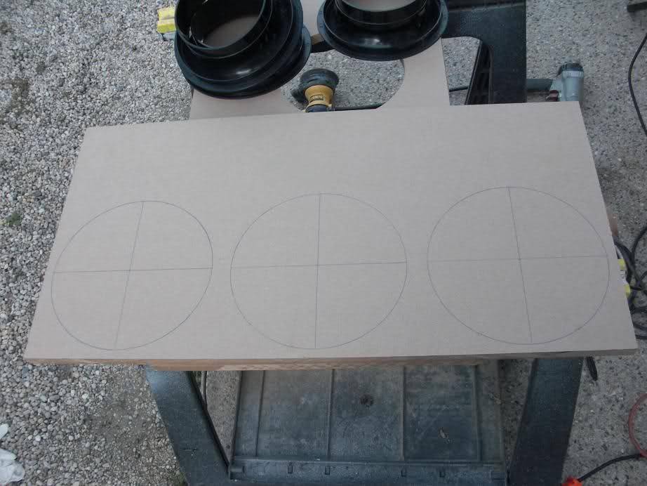

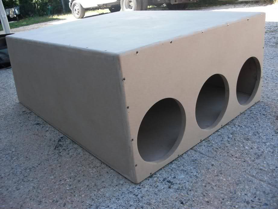

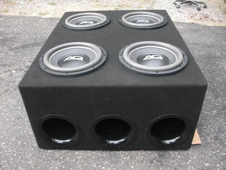

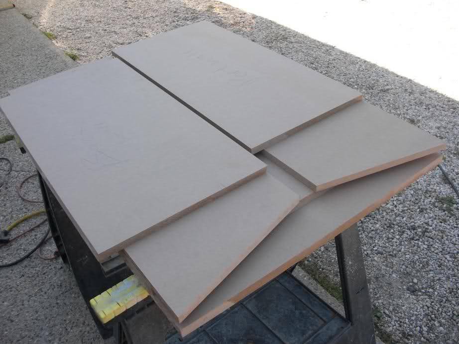

Just a build that I'm doing for a good friend. Pic's will be updated over the weekend as I will be building the box tomorro. Box will be 8.0 cu/ft net tuned to 36hz using (3) 6 inch aero ports. Mechman 250 alt, (4) runs of 0 gauge, (2) batts in spare tire well, Big 3, installed as of today. Car is an '03 Buick Century
Car:

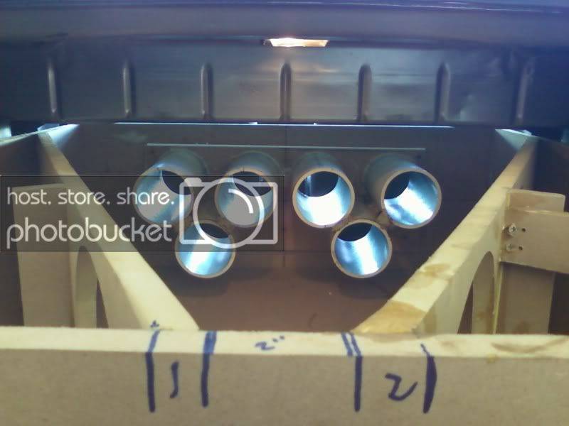

Yea suprisingly the trunk is pretty big on the car. And yea subs up/ port back was the only way of fitting the box without walling it. Although, I will say I did a good amount of trimming with the grinder and the sawzall on the rear deck :). Just trying to achieve the best possible airflow around the box.

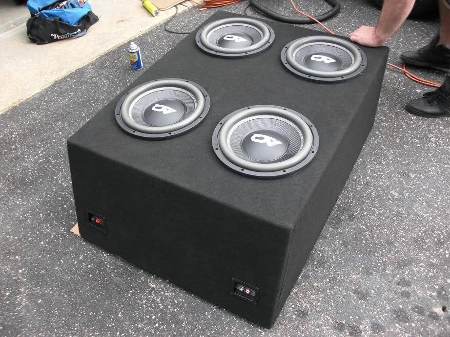

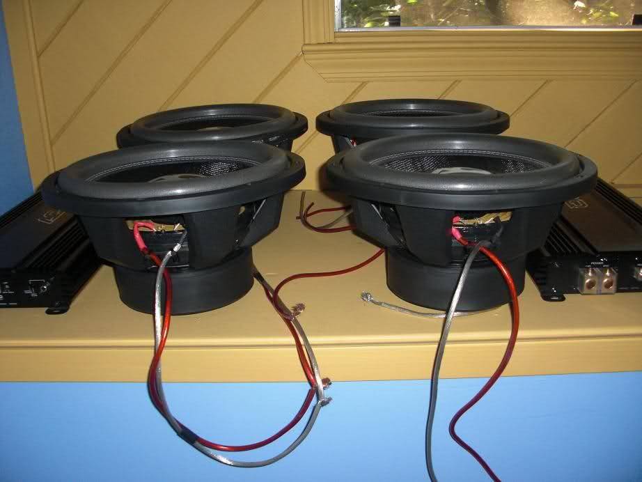

New Pics... As of tonight everything is hooked up. Aeroports worked out well and def move a good bit of air on this setup. Should have a vid of it on the TL by this weekend. I think it just might pull a solid 150 on the TL :)

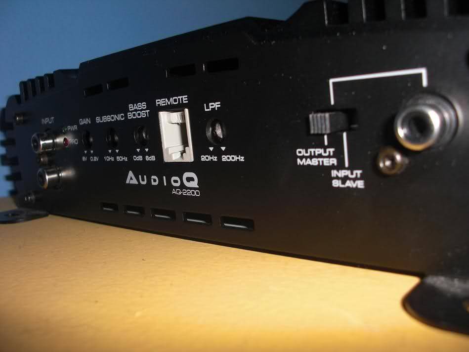

Amps..
