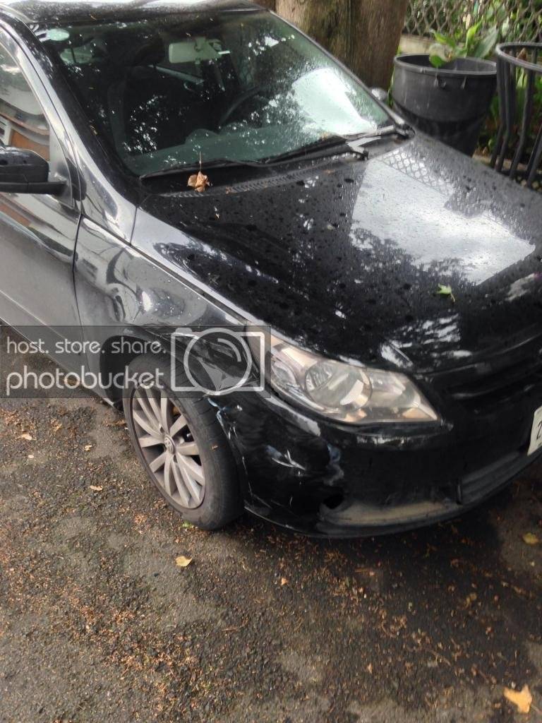

Yes mate at least I know who did it. It was a lady who, in her own words, was distracted looking for something under the seat and managed to crash the only car on the street (mine) while doing it. At least her insurance is supposed to take care of it but I haven't heard news from them in 2 weeks. They were supposed to just value the damage so I can get my money. Today I'll show up at the shop where my car is supposed to be. I've been calling and they never answer or the person who deals with clients isn't there.
Body panels doesn't look too damaged but the steering is. I always leave my steering aiming at the sidewalk as I live in a downhill and she hit it pretty hard on the wheel. The car even went down like a couple of meters from where it was parked. Oh, and you can (can't actually xD) see those mising fog lights that were stolen xD
I hope to continue with this ASAP, I'll keep you updated about that sound system.
