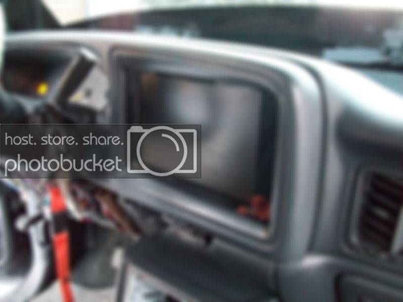

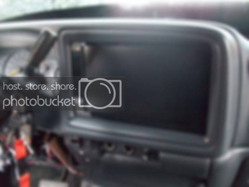

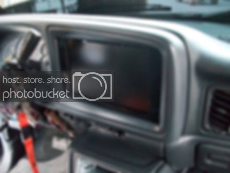

11" screen in the dash.

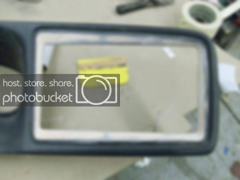

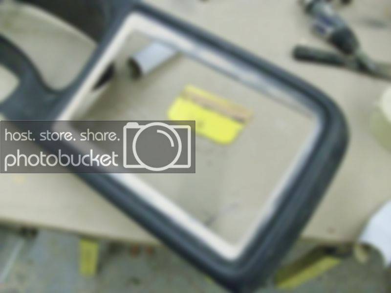

I wanted to keep this as factory looking as possible and not do what everyone else does when they put a screen in these types of dashes...like steve meade....and just smooth out the whole dash bezel. it looks cheezy... so i did it to where i still had the factory dash lines...

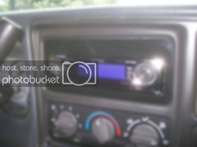

Before
the screen is mounted in the dash along with the black plexiglass bezel. i relocated the HVAC controls to the glovebox.

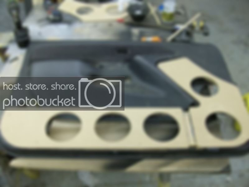

my boston accomodation order went through to so il post some pics of the doors.

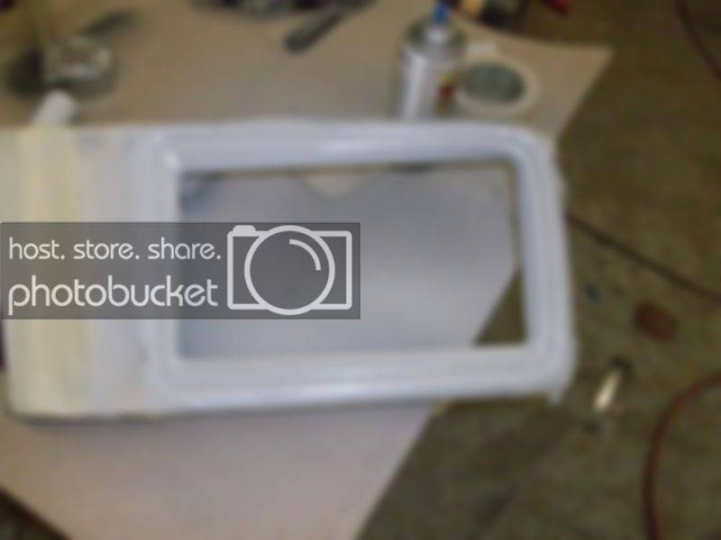

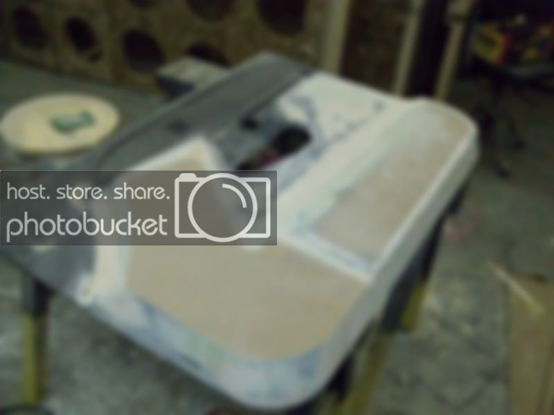

and again i wanted to keep this looking somewhat like it was suposed to be there. The door will house 4 sets of Boston SR60 components as wel as a set of Boston SR50's. so 5 mids and 5 tweets in all.........
i kinda skipped taking pics of this step...
after the glass is dry i attached 1/2 template of the baffle to the front. i then body filled around this ship to create an inset so i can use some .093" plexi to trim it off....
