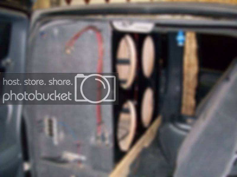

-wall build 14cubes tunes at 30. 2 layers 1.5" thick with a layer of 2x4's on back and 1.5" steel tubing inside.

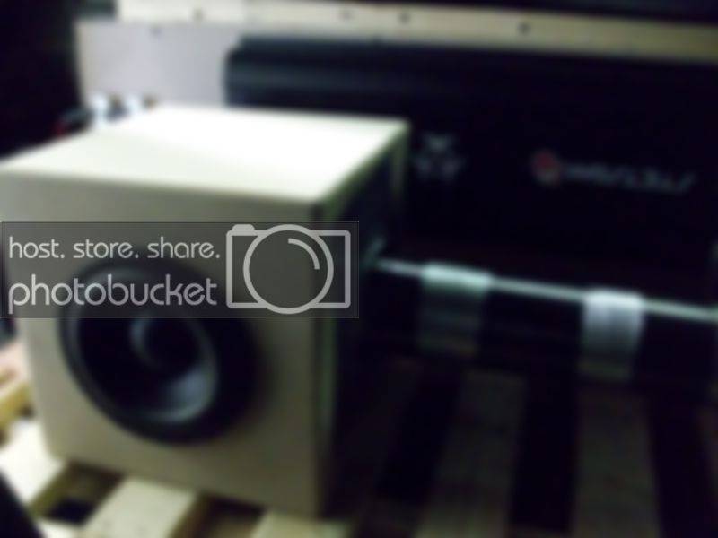

but for now im just gonna throw alot of test boxes in that i have been wanting to experiment with haha.

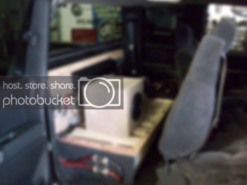

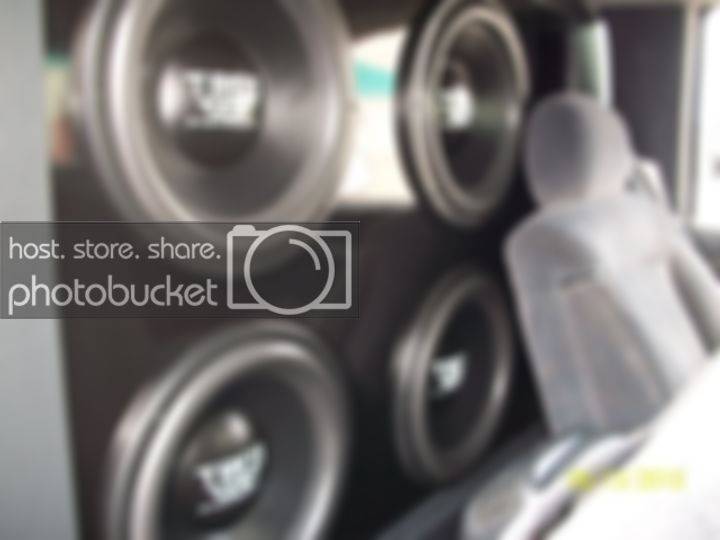

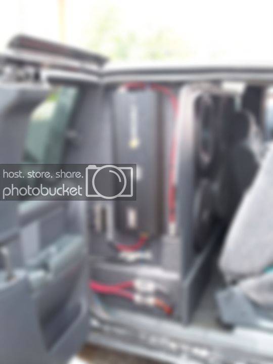

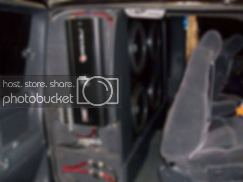

2010 pics

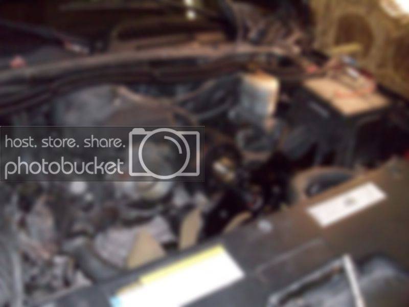

tearout pics.... when the termlab worked i got 145.3 outta that assassin 8 @58hz
for sure lol it was tuned at like 55z. i changed it up a lil bit and threw both 8's in a temporary box and i almost wish i could take it to a show like this haha loud as hell......

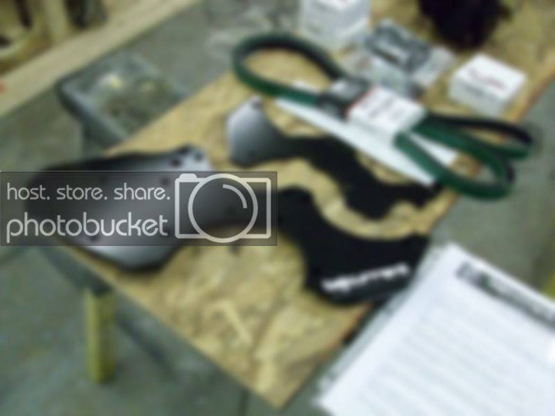

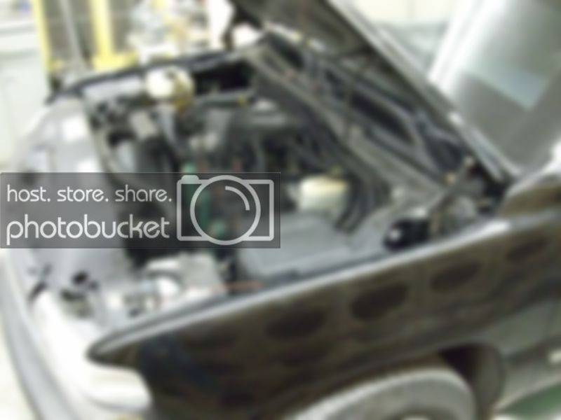

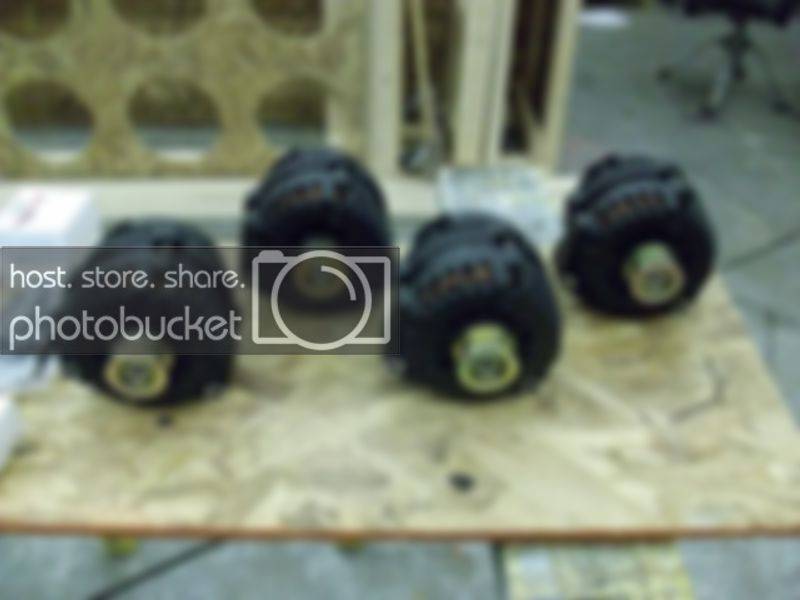

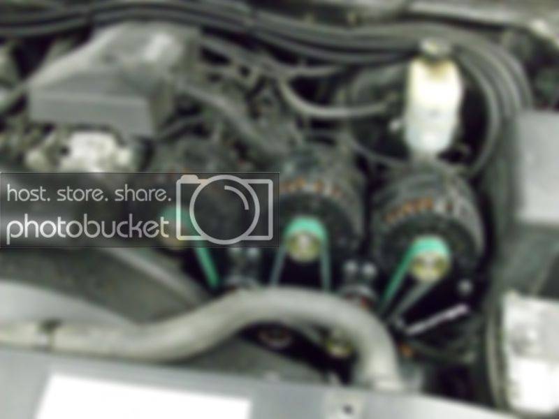

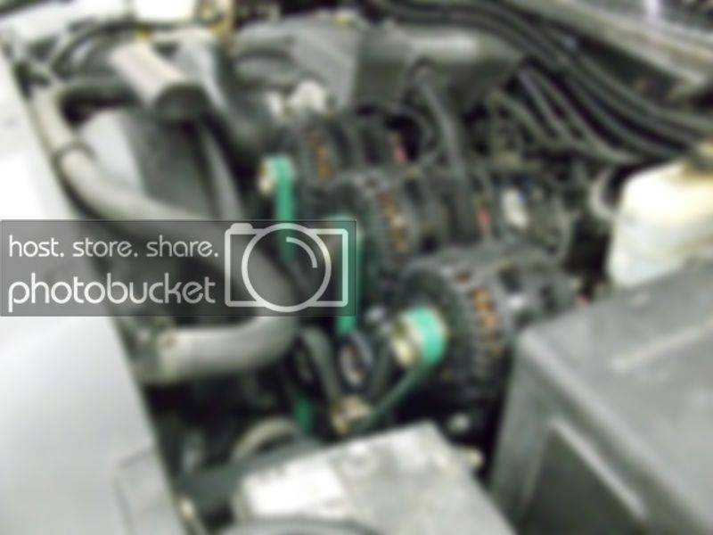

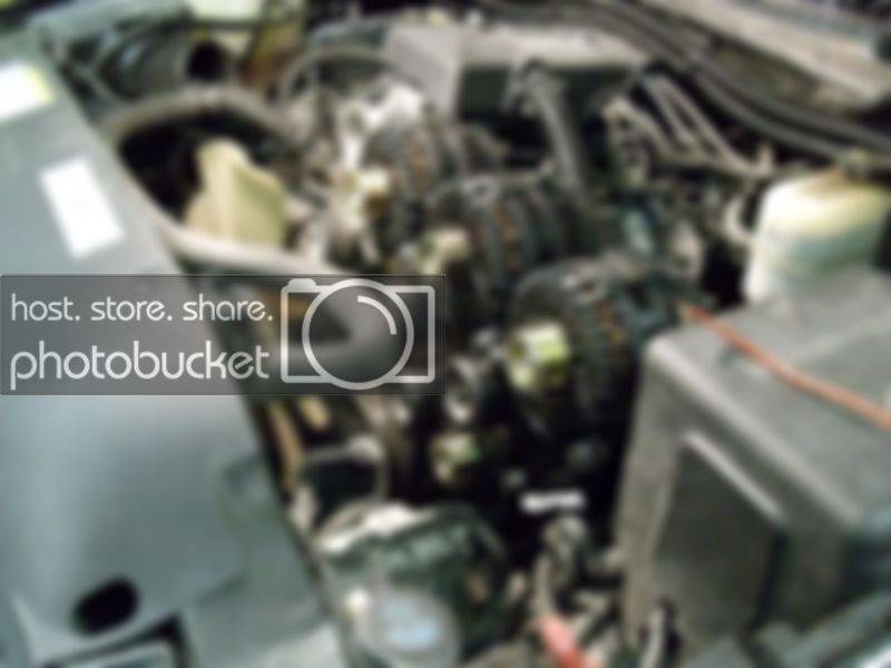

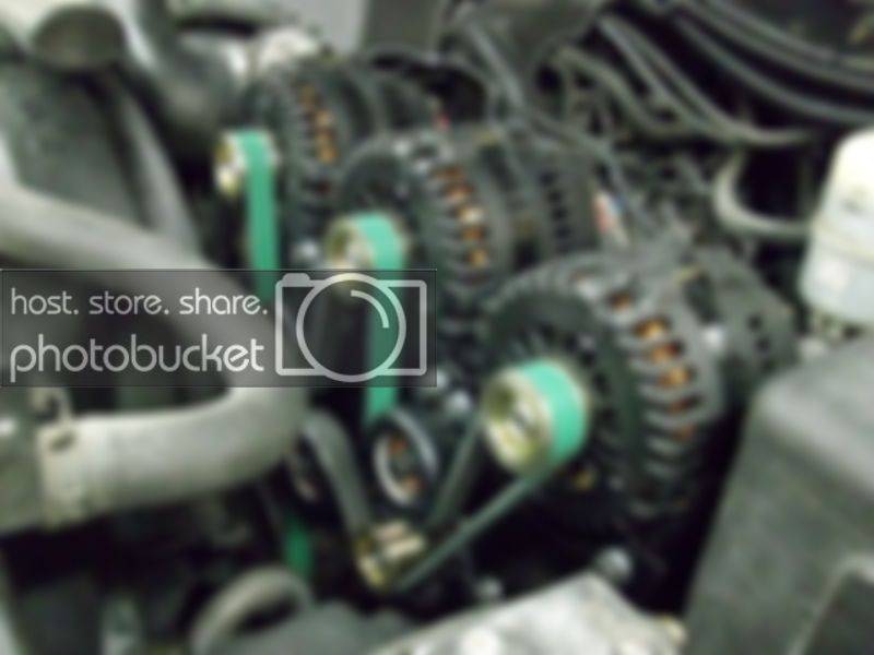

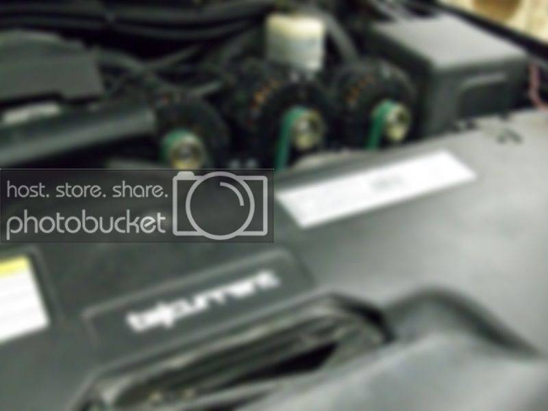

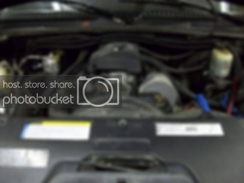

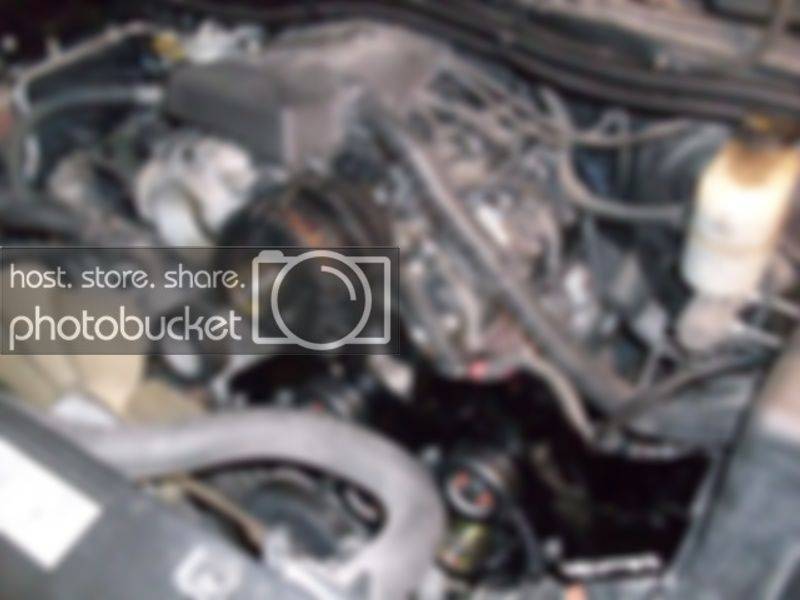

Here is pics of my Tejcurrent quad alt and bracket install in my 99 silverado. install took around 3-4 hours total. instructions were very detailed though, with very good pictures to help. thanks Troy!

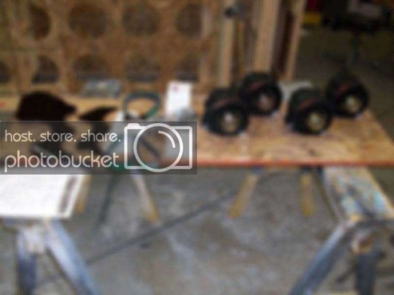

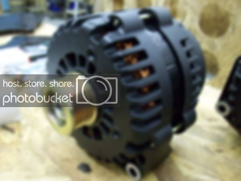

pics of the alts and all hardware out of the box!
old mechman alt

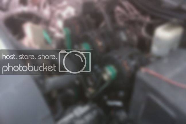

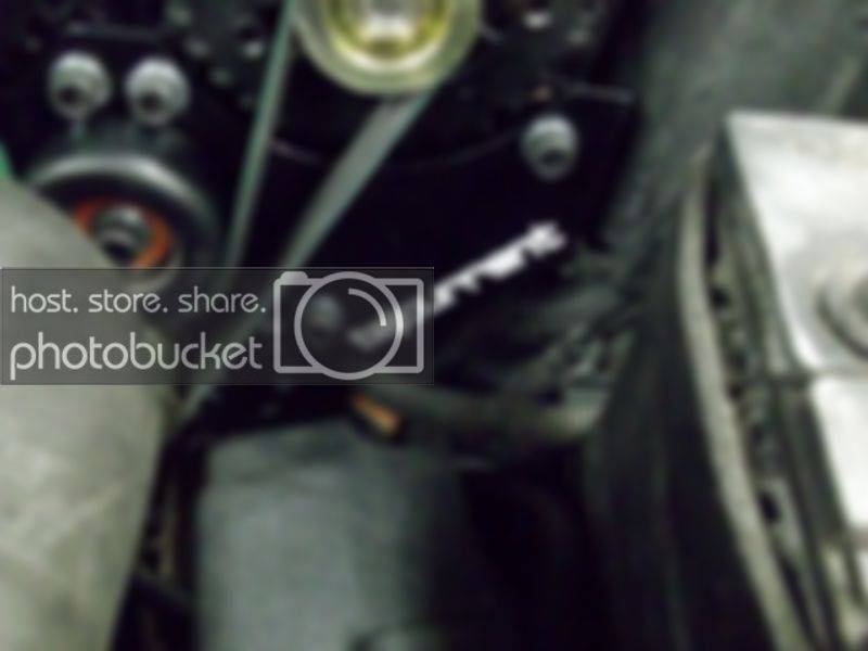

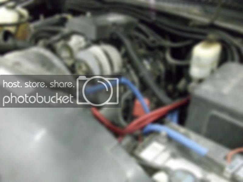

the ECM has to be moved forward to allow clearance. to do so take the battery tray out and the ecm will unbolt. bolt it back in forward so that the second hole is now in the first position
make sure you grind off the powdercoating around the mounting bolts before you install or you wont get a good ground connection.
