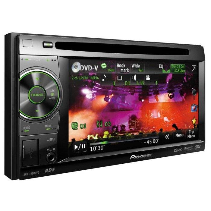

head unit
pioneer avh1400dvd

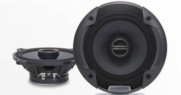

speakers (looking for upgrade)
4 alpine type g 5-1/4" (13cm) 200w max 50 rms

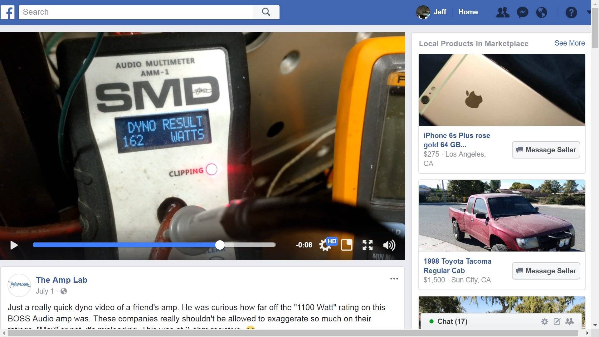

Here's the big flaw in your logic. If the amp is only does 200 actual watts and you set the gain for 800 watts that means you are well beyond clipping and can burn up your coils eventually with dirty power because you are forcing the amp to make power it cannot realistically make. Basic rule for you to follow is, if you turn the setup up higher and stops getting louder, you are past clipping, turn it down a few notches.
here's what a 1100 watt boss amp does on a proper amplifier dyno which tests for true RMS. which claims 825 watts RMS.

Here is another clue about that amplifier. It has a 25 amp fuse. Ohms law states that volts X amps =watts. So 12 volts X 25 amps = 300 watts. So you have 300 watts of input energy, then you realize that class a/b amplifiers are only around 50% to 60% efficient. So the amplifier is only capable of 150 to maybe 200 watts rms at the most. More than that would blow the fuse.
