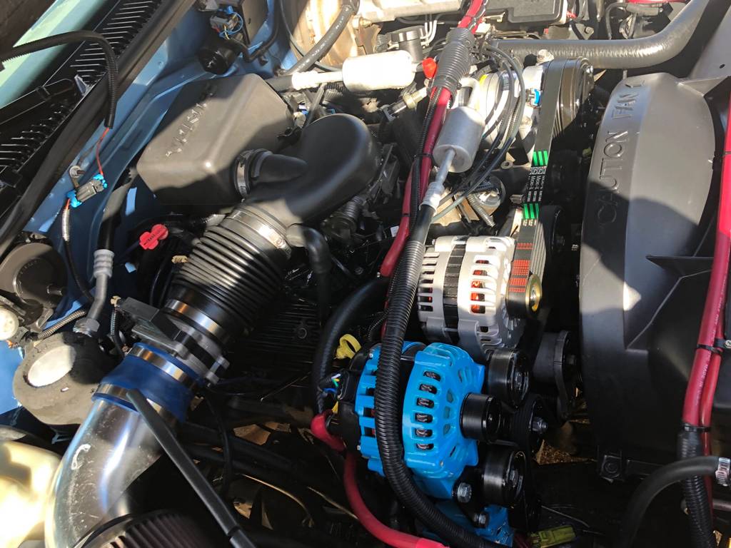

As far as alts go Jonathan Patrick is definitely the way to go ! Here’s two hairpin 300 amp s he made me
The two blue ones and there just for stereo the eBay ho for truck electrical will be replaced with another one soon. He definitely knows his stuff and you will be very happy with him !
